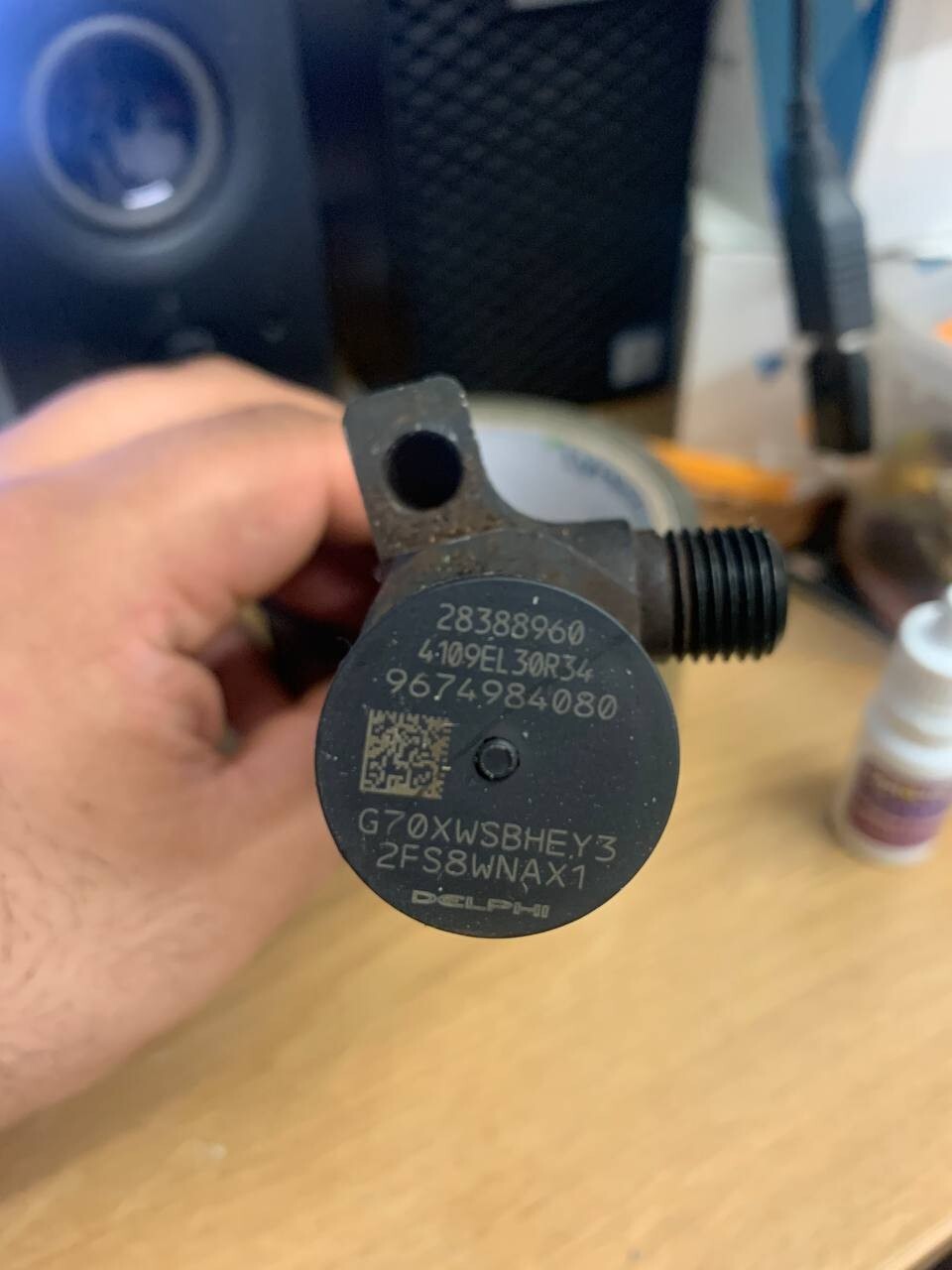

I don't have experience with Delphi injectors but where are the codes normally marked on them?
- Posts: 9242
- x 1924
Re: Injector Coding
Judging by this photo off Ebay it must be one of the numbers here. Assuming it's the same type of course!
What does interrogating engine ECU give as the code for the old injector? Can that not be compared by simply looking at the old injector?
