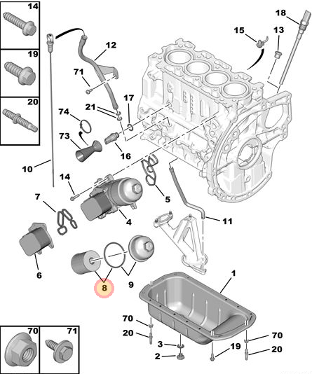

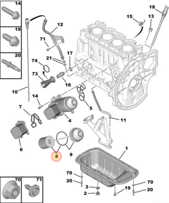

As for parts, I'd never trust aftermarket suppliers to know the correct part. For future reference the correct Citroen part number for your C4 is:
(8)
OEM Original Oil Filter, part: 1109AY, £18.10
Cheaper PSA Alternative , part: 1680233480, £8.44
Inc. UK VAT.
