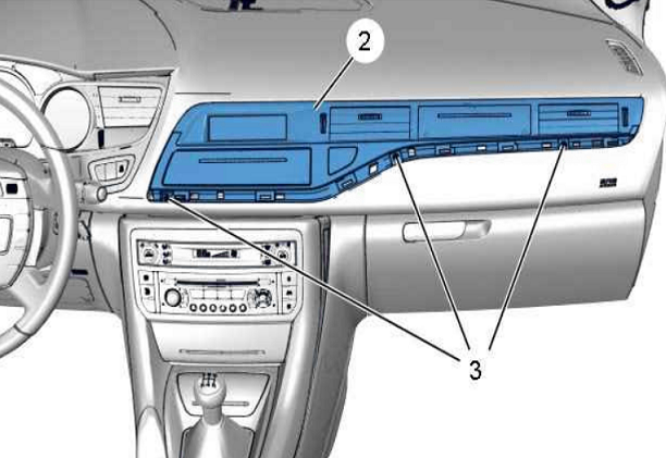

You take the lower trim strip off Paul with trim removal tools, then this will expose 3 bolts as above.

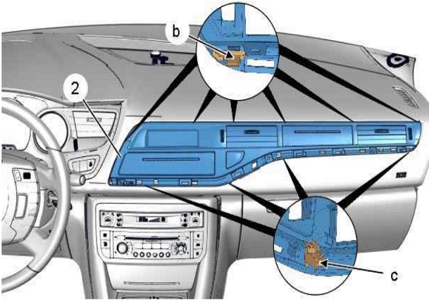

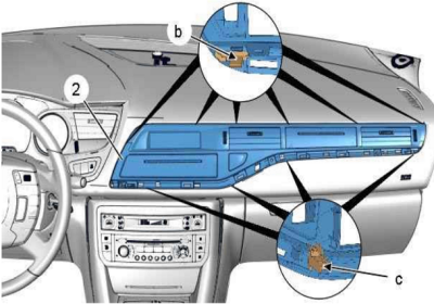

Unclip: The fascia panel front panel (2) ( as "b", "c") using trim removal tools. You should be able to pull it away horizontally towards you on those clips as they snap in and out.
Detach: The fascia panel front panel (2).
That should give you access to the MFS.
