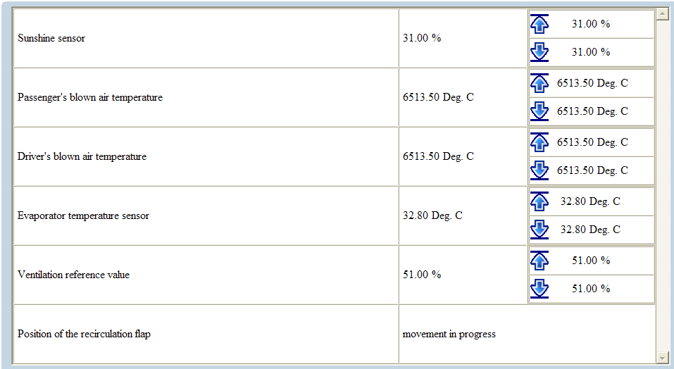

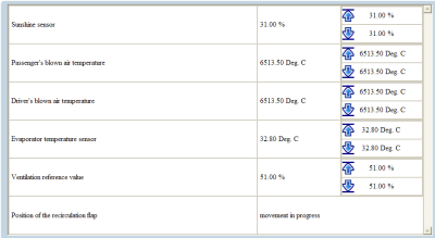

First up, it would be cooler sitting in the greenhouse! I have put a thermometer into one of the air vents and even with everything set to "Lo" the air coming out the vent is around 32degC. If I wind the temperature up to high then the air temperature from the vent gets above 60degC (I don't know how far as the heat was insufferable). It seems to be much the same irrespective of whether the air-con is turned on or not. I ran the same test on the 308 with the air-con turned on at the lowest temperature setting and quite quick the air was down to 11degC. Will replacing the thermostat fix it or does it need to see someone to have the air-con regassed?
