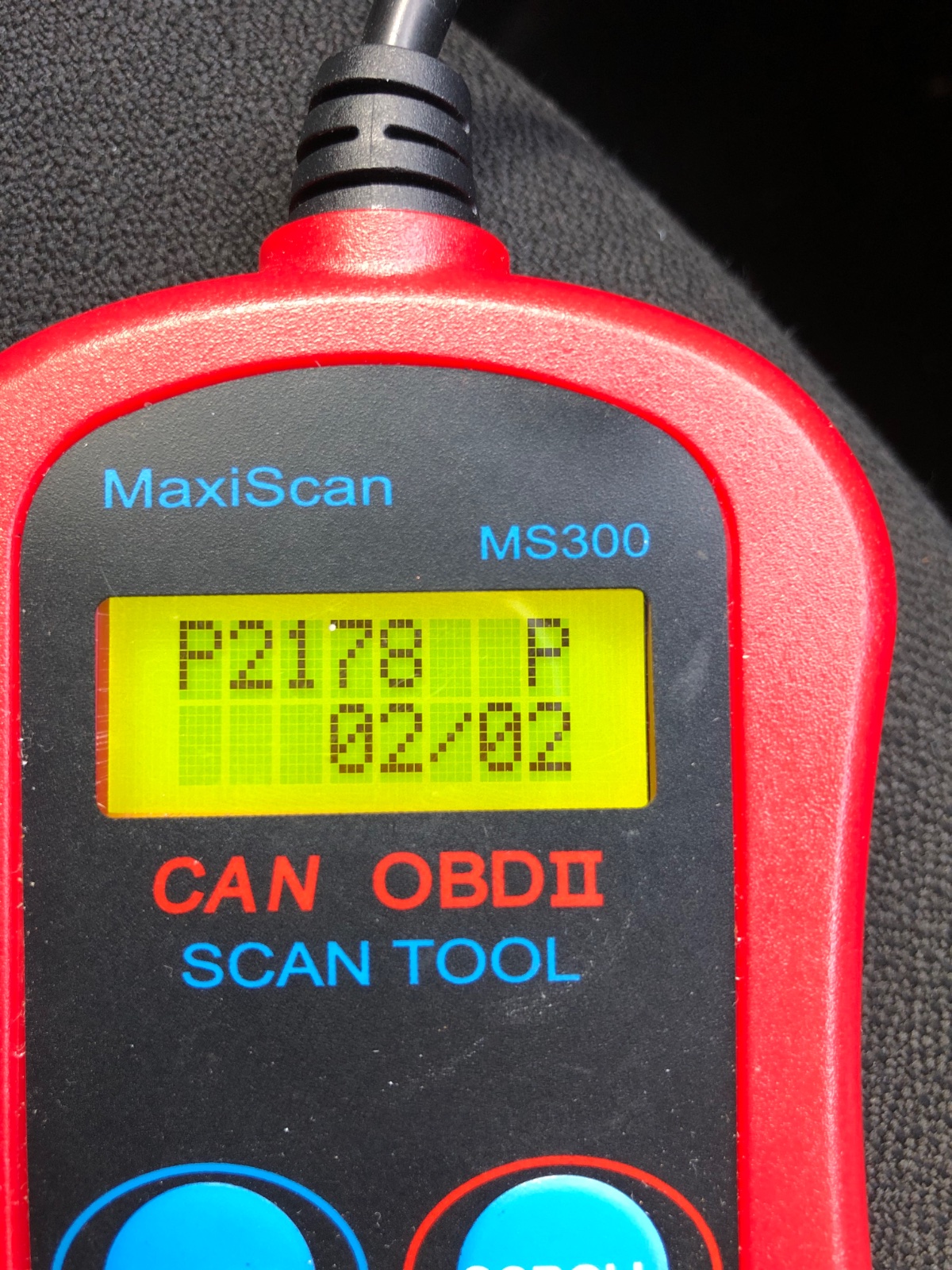

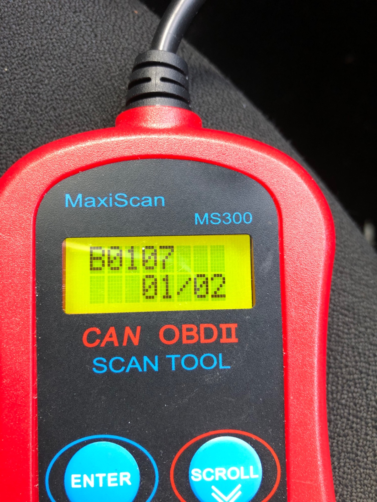

Today the engine management light came on and I have 2 errors.
B0107
P2178

As for the 'B0107' code, it's not a valid code. Are you sure it isn't 'P0107'?

As for the codes, please see my pic. Confused as to where it got the code from. 😂🤦???

Ok, so that first code is not recognised - probably down to you scan tool not being able to read constructor codes.

No, because it's not a valid PSA fault code, so there is nothing to relate it to. As for the other one:
Fault Code: P2178
Description of Fault: Richness adjustment: Coherence. Air quantity too low.
The corrective factors of the air quantity have produced a value that is not plausible.
Conditions of activation of the diagnostics: Engine management ECU in main triggering phase
Conditions for Fault to clear:
  • The air flow is below a minimum threshold
Downgrade Modes whilst Fault is active: -
Symptoms:
  • Idle unstable
  • Stalling at idle
  • Emissions outside the norms
  • Excessive fuel consumption
Suspect Areas:
  • Air cleaner
  • Fuse
  • Electrical harness
  • Inlet air temperature and pressure sensor
  • Canister discharge solenoid valve
  • Cylinder head cover
  • Air line
  • Engine fusebox
  • Fuel pump
  • Fuel system
  • Breather pipe
  • Upstream oxygen sensor
  • Exhaust manifold
  • Catalytic converter
  • Engine compressions
  • Variable valve lift system

Hi, I would work your way down that possibles list starting with the air filter. Check it has not got leaf blockage in the feed duct as well as the filter itself. Then work your way down. As for the B0107 code, it would appear that that is a generic OBDII code which relates to a passenger airbag fault. This link will tell you more about it: https://www.engine-codes.com/b0107.html Good luck :-D
