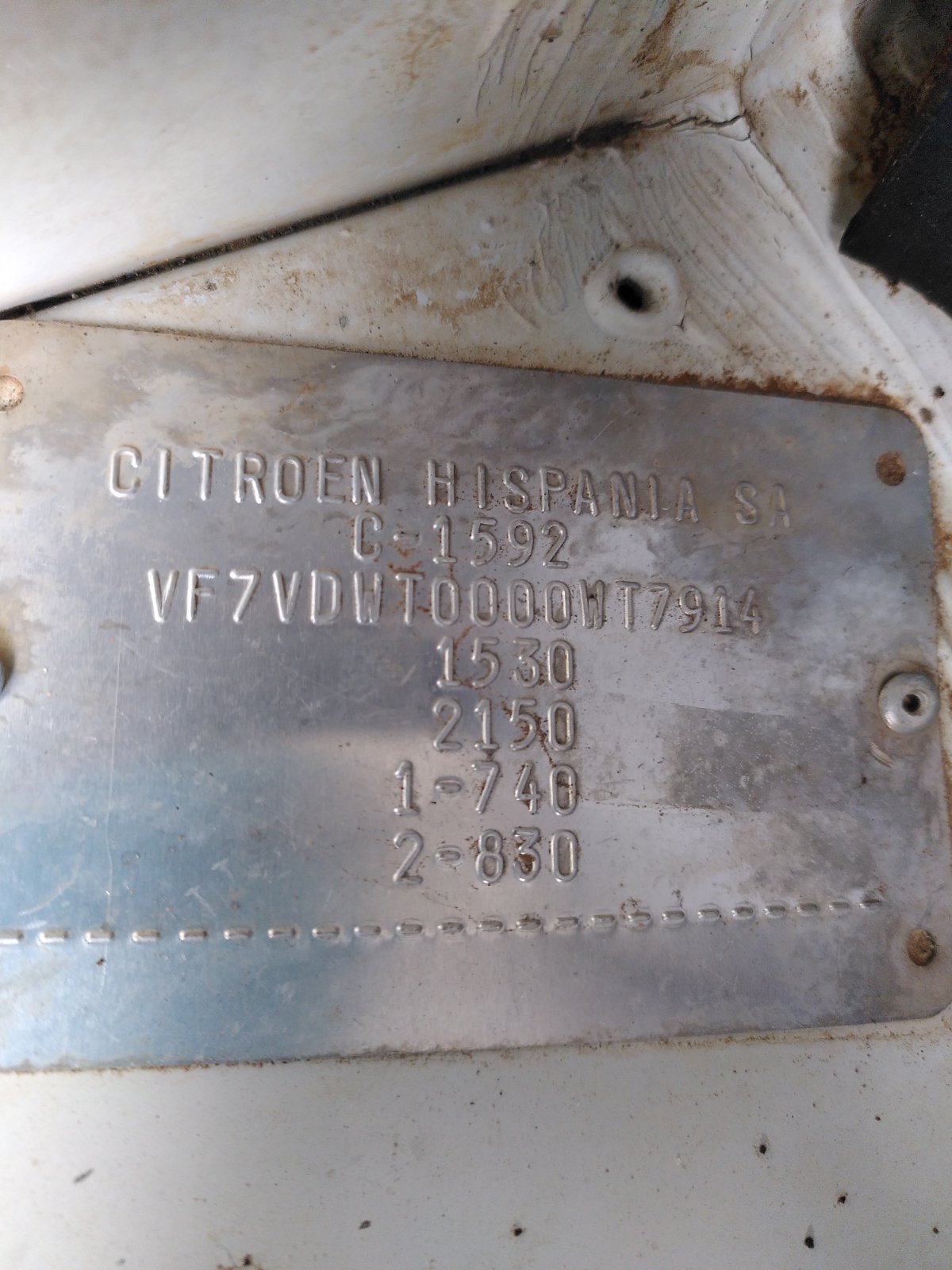

My Vin is VF7**************[VIN obfuscated, can be read by forum staff] registered 30th Oct 2001 in Spain.
The Vin on some ebay listings for gearboxes is: VF7**************[VIN obfuscated, can be read by forum staff] VF7**************[VIN obfuscated, can be read by forum staff] VF7**************[VIN obfuscated, can be read by forum staff]
Would any of these gearboxes fit or does it have to be specific?

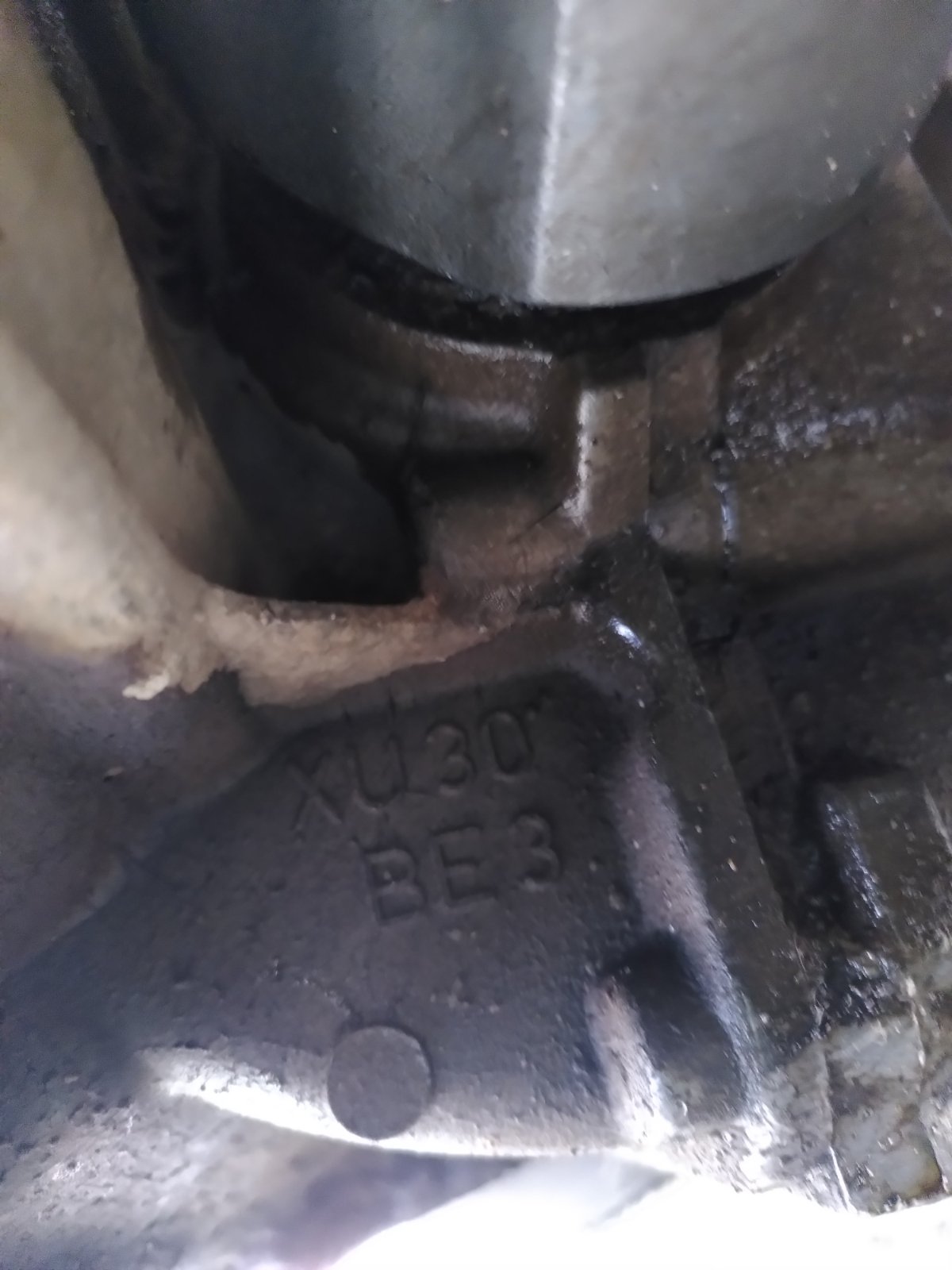

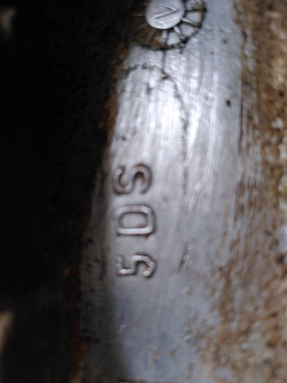

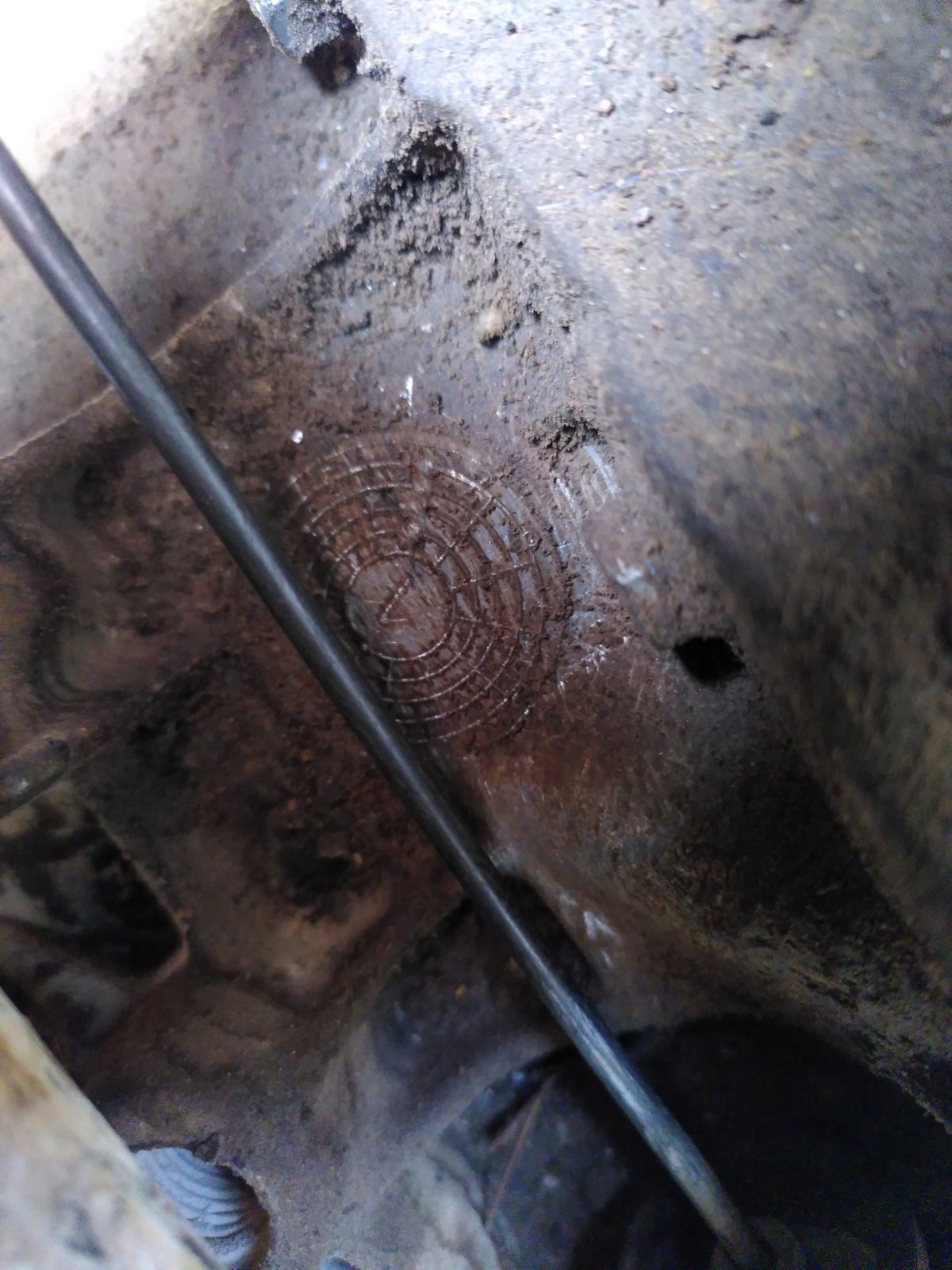

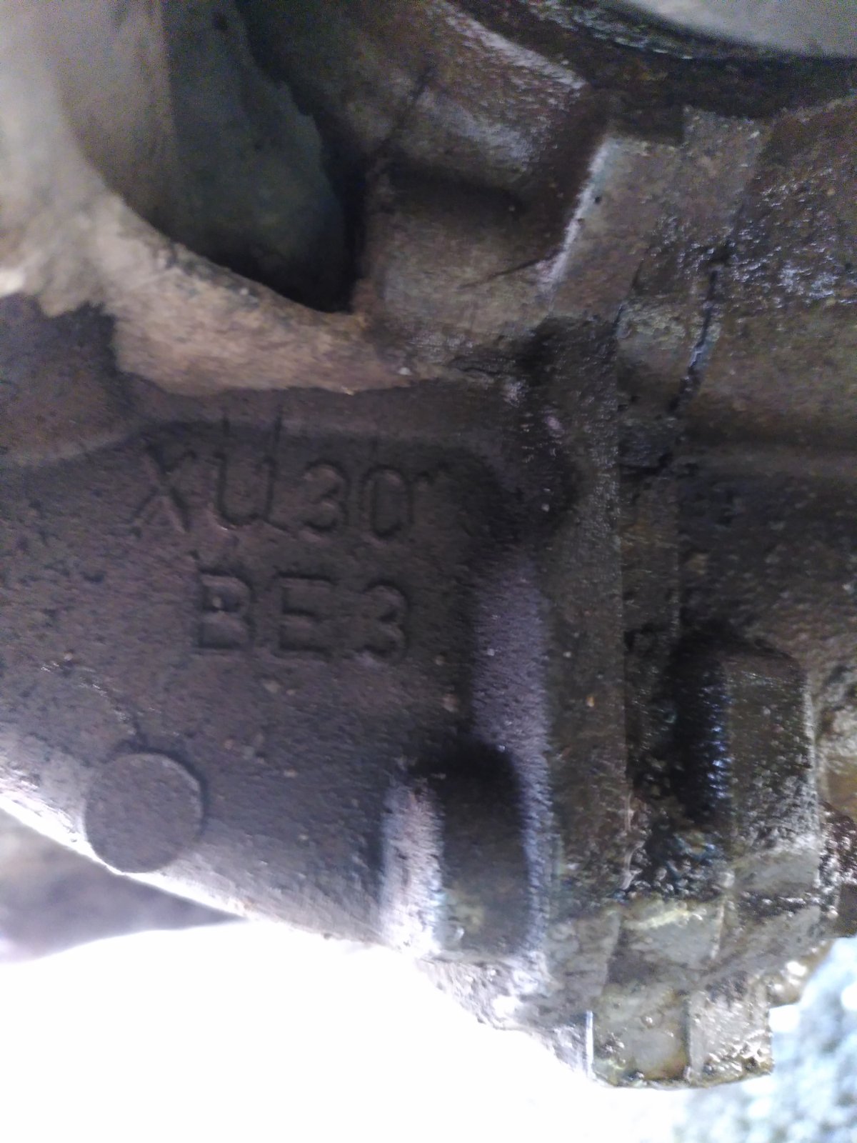

It seems my gearbox is an obscure fitment in the Uk - Any help really appreciated - I have found these codes on my gearbox but they seem to match to a Peugeot?
x 2941

I think that box is fitted to a variety of PSA vehicles with the 1.9 engine, BXs 205s and 306s come to mind, the problem may be finding one with the appropriate ratios.

On my gearbox I have this tag code 3727025A is there any reason a different tag code from a C15 wouldn't fit and work okay?
It's the 20TE11 gearbox

Sound advice would be that you match up the codes from your existing gearbox to a donor.
x 2941
Re: C15 gearbox help
GiveMeABreak wrote: 27 Apr 2023, 08:54 Sound advice would be that you match up the codes from your existing gearbox to a donor.
Or repair your own box, not too difficult if it's only bearing noise, bearings are cheap enough if you shop around the specialists.
