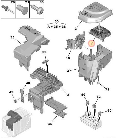

Ok, so info below:
(1) Engine Fuse Box, part: 9807428080, £382.76 inc, UK VAT direct from Citroen.

The under bonnet Engine Fuse Box is not the BSI. Generally these do not need coding to the vehicle, but as I said in my earlier post, DS4 and later C4 models amongst some others do have a configurable engine fuse box, so in your case it will need configuring to your vehicle.
Items such as:
Supply
Heating/Ventilation
Lighting - signalling
Engine Compartment
Visibility
So you can't just swap this over and hope it works as some of your equipment like the lighting may not work properly for example.
Unless you know what you are configuring, I think it's best left for the dealer to do - and be warned if you are sourcing a local used unit, it may not work or may have the incorrect configuration for your vehicle. But importantly, a dealership with the official diagnostic tools may not touch it if you have a used or self-sourced part, as they won't normally take the liability for configuring electronic units that are not new.
