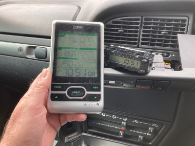

Can anyone guess the correlation between a non-functioning Oregon Scientific Weather Station and a non-functioning Xantia temperature display?
I seem to recall Oregon Scientific switched off their UK weather server some years ago and this turned the weather station into an effective brick.
Having searched the internet, I can no longer find any reference to them switching the servers off but their weather stations are no longer available for purchase so…

No Paul. I was going to see if the Thermistor in it was suitable for use in the wing mirror.
Thereby followed a private conversation with another member.
I am sure I saw somewhere that it is an NTC resistor with 6K value. Maybe from a fiche?
This thermistor appears to be 10k as at the temperature in my kitchen (<18 Celsius) it was registered about 11750 Ohms

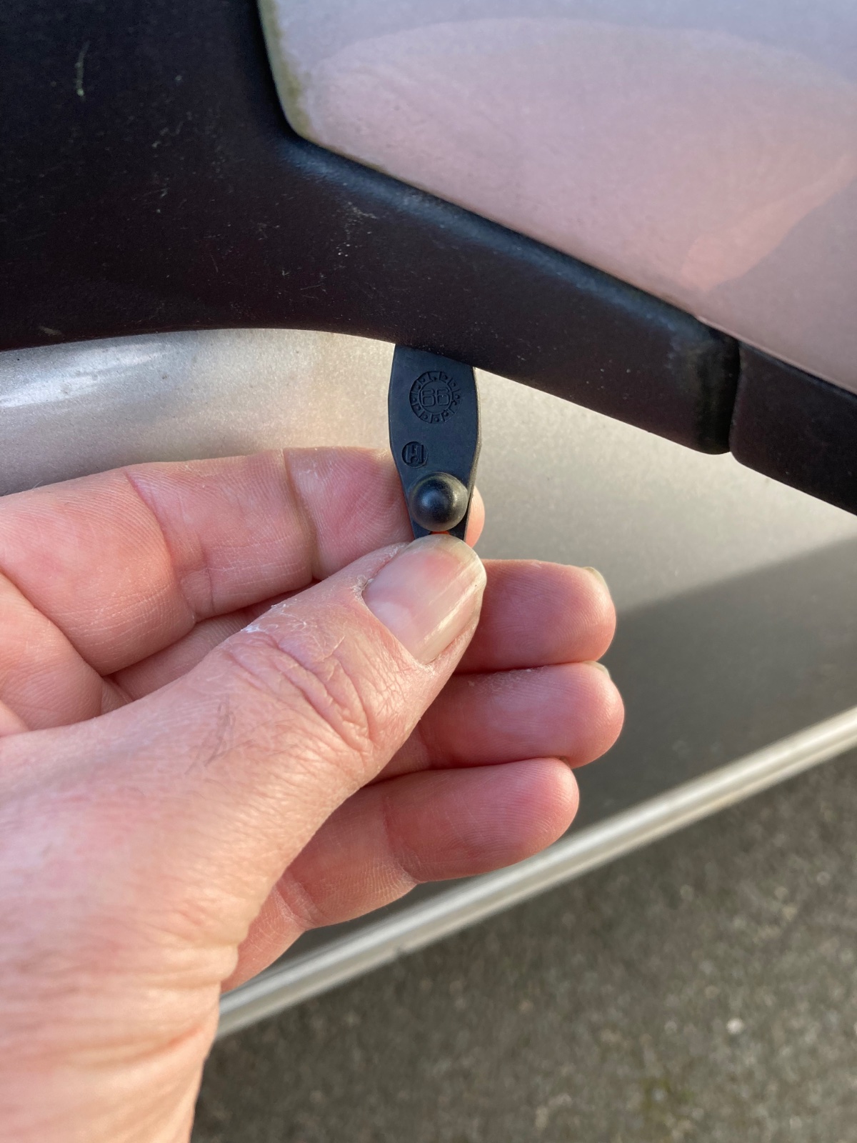

I wonder if the C5 wing mirror thermistor could be a suitable substitute?

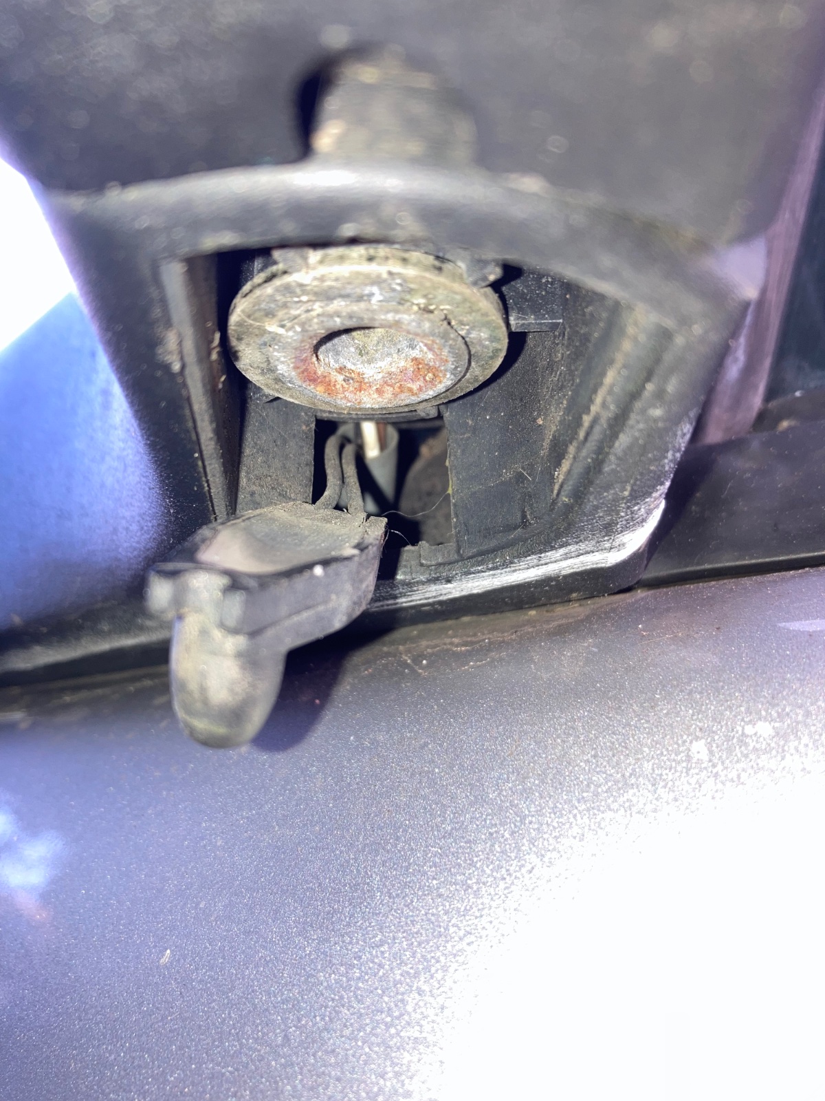

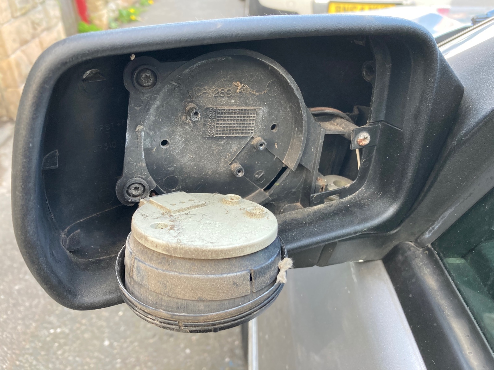

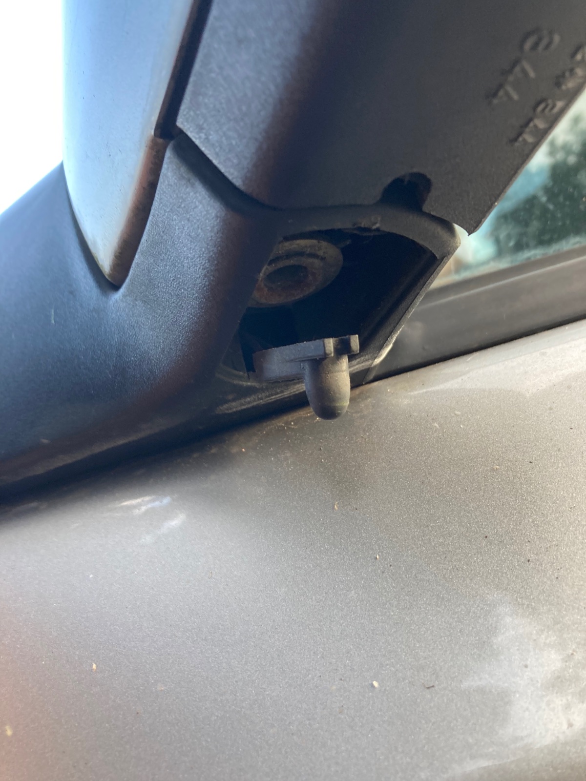

Jay-Bruce wrote: 15 Apr 2023, 17:43 I wonder if the C5 wing mirror thermistor could be a suitable substitute?
Why? Do you have one kicking around spare?
Dare I say they probably didn’t redesign the wheel.
After reading one thread, I stripped the mirror down and couldn’t find the wiring for the thermistor as the thread described it as being behind the motor…
It wasn’t. Would have taken me less than a minute to remove if I’d have realised where it actually is.
