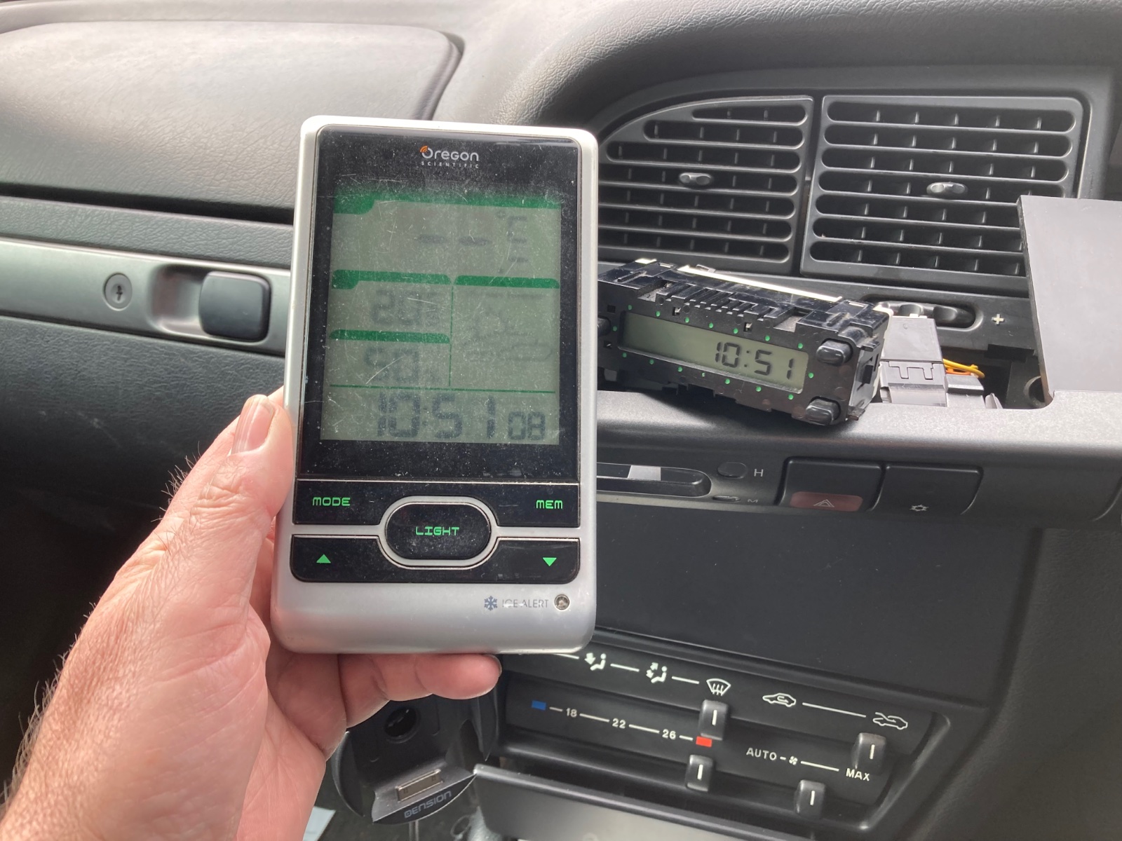

Can anyone guess the correlation between a non-functioning Oregon Scientific Weather Station and a non-functioning Xantia temperature display?
I seem to recall Oregon Scientific switched off their UK weather server some years ago and this turned the weather station into an effective brick.
Having searched the internet, I can no longer find any reference to them switching the servers off but their weather stations are no longer available for purchase so…
Can you guess what I am up to today?

You're using it as time source to set the vehicle clock?

No Paul. I was going to see if the Thermistor in it was suitable for use in the wing mirror.
Thereby followed a private conversation with another member.
I am sure I saw somewhere that it is an NTC resistor with 6K value. Maybe from a fiche?
This thermistor appears to be 10k as at the temperature in my kitchen (<18 Celsius) it was registered about 11750 Ohms

I'm intrigued to know if this worked Roger, following our chat earlier

I wonder if the C5 wing mirror thermistor could be a suitable substitute?

Why? Do you have one kicking around spare?Jay-Bruce wrote: 15 Apr 2023, 17:43 I wonder if the C5 wing mirror thermistor could be a suitable substitute?
Dare I say they probably didn’t redesign the wheel.
After reading one thread, I stripped the mirror down and couldn’t find the wiring for the thermistor as the thread described it as being behind the motor…
It wasn’t. Would have taken me less than a minute to remove if I’d have realised where it actually is.

Only just found it Jim but its shape doesn’t really lend itself to doing what I was going to do.CitroJim wrote: 15 Apr 2023, 17:42 I'm intrigued to know if this worked Roger, following our chat earlier![]()
Besides, the damned clock lost its time again after holding it for just over a day.
I am beginning to think it’s more to do with the solder on the clock PCB despite not visibly being able to see any cracked joints.
I went over the six connector pins last night so that didn’t work. Probably should have desildered the connector fully, cleaned up and re-soldered.
