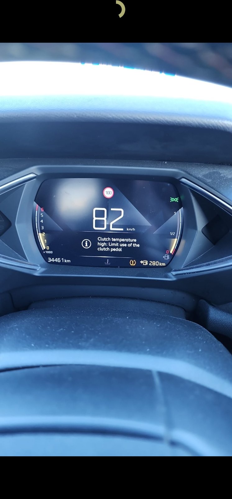

Hi all,
Have someone faced this issue?
This only happens when you use the 5' for more than 2 min.
Using 4' or 6' for long periods nothing happens.
DS dealers not able to give me a solution.
They suggested to change the clutch but not sure if It will get fixed.
Second opinion said, there is nothing wrong with Clutch...
Third option said, maybe a software update because nothing wrong apparently.
Thanks anyway.
Msg on dashboard
Msg on dashboard

Re: Clutch temperature high
If it's still within warranty - take it back.
Is this a normal gearbox & clutch or piloted manual system? If piloted, that would suggest the clutch biting point is not set correctly. This can be rectified by running the correct actuator engagement procedure which they should know about in Diagbox. They would have to do this if the clutch was being replaced.
If not a piloted manual and you have a clutch pedal, then it would suggest you are riding the clutch.
In either case, unless it is sorted you will be wearing out your clutch pretty soon, as high temperatures are what wears the friction material on the clutch.
Well the issue is as I see it, it's a basic clutch system, so nothing fancy to go wrong.
However, if the vehicle has been damaged as you say (I don't of course know from here what happened) then there is a possibility that it has been damaged.
This sort of warning generally may only happen when you are towing when the clutch may overheat as you are manoeuvring where more strain is put on the clutch, but not in normal driving conditions unless say you rest your foot on the clutch or there is a fault with it or it has been replaced and not fitted properly.
It needs investigating to be honest and whether just fitting another clutch will resolve it is unknown as we don't know the cause.
Unread post by RichardW »
I'm pretty sure there is no temperature sensor, my guess is that the ECU cross checks the engine speed with road speed and known gear ratios, and if there is a discrepancy assumes the clutch is slipping and flags the warning. Telling in this case it only occurs in 5th - suggests to me that the wrong gear ratio is programmed for 5th.
x 6945
I agree, it is probably a calculated value based upon engine speed, the selected gear and the road speed. Probably warning you that if continuing under these conditions the clutch could overheat.
