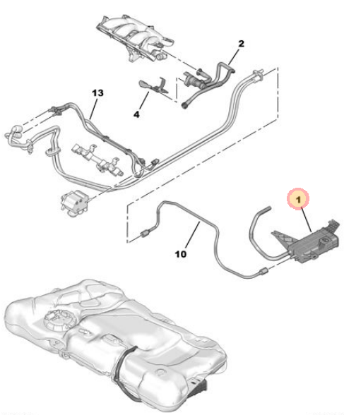

Here's the diagram for the vapour Absorption cannister:
(1) Petrol Vapour Absorber Canister, part: 1502K7, £187.32
(2) Is the Purge Solenoid Valve, part: V759514680, £83.34
So whether they mean the actual solenoid valve may be leaking or the canister itself I can't say.
Thanks for your Forum donation. Any future part number requests, just ask on the main thread here:
Citroen Official Part Number Requests

Re: C5 X7 1.6 THP -11 Code P2279
All the hoses and connections are okay. Also the vapour canister looks fine. Purge solenoid valve is clicking ok, but there is some kind of membrane also inside. I don’t know if that is okay. Also I’m starting to suspect throttle body also.
