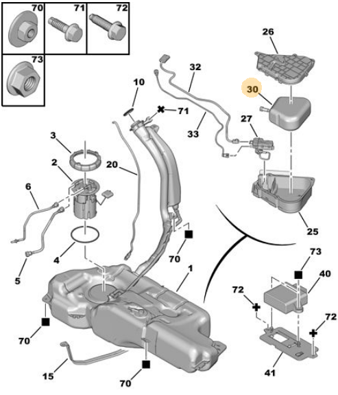

So, back to the additive. No obvious lids or bottles or even dash warnings. One thing is I ordered a filter & got the wrong one for my engine (ehdi 1.6 8v) as mine takes the plastic one shaped a bit like a fuel tank. The factor said it is the older model.... So I guess they were using up older engines.

If this is for your Berlingo, VIN ending 105 then yes, you have a particle filter. The additive tank is hidden away next to the fuel tank, usually on the left hand side, but is protected by heat shields from the exhaust. It can only be filled with a filling kit that is gravity fed. These are usually supplied with the additive bottles and are available with or without the filling kits. Of course you will need to reset the additive counter to zero once topped up. Minimum top up should be 1 lt.
2nd, WHY hide it???

It's not deemed a 'customer' DIY job which is why you won't find it in the handbooks, and only needs to be topped up once or twice during the life of the vehicle.
It has to be close to the fuel tank and has to be protected from the exhaust heat (especially during vehicle DPF regeneration - temperatures), so that is where they chose to fit it and is the preferred location even on even on later vehicles throughout the diesel range. Don't forget that later vehicles also have to have a UREA tank fitted for Adblue in addition, so there's not many other places to put it.

Ok, so your Wife has the 110 engine with a DPF. However, she has a different system to you, meaning that instead of a reservoir, she has a 'pouch' based system. The tank looks the same but is just a housing, into which the old pouch is disconnected and the new pouch inserted. It still needs the engine ECU additive counter resetting. Note also that the Eolys type originally supplied was Eolys 176, which is no longer made, Citroen recommend a Powerflex pouch.
So my advice here is leave it until the warning comes on and then replace with a new pouch (part number: 9678080680). This is a 2.2 litre pouch so must be replaced with the same.

So, where oh where does this "pouch" live?

Same place....
