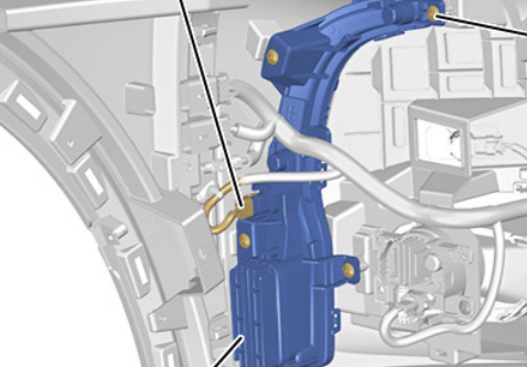

The Daytime Running Lamps on the DS7 are controlled by the BSI, so unless you can locate an electrical issue at the light module, it's going to need a diagnostic / dealer visit. They don't even provide a comprehensive fuse list in the owner's manual, preferring you to seek assistance from the dealership - as these have so much electrical tech on them - so lots to go wrong.
It may possibly need a new module, but here is the connector you need to check:

Is the connector accessable without a major dismantling?
x 6950
Re: DS7 daytime running light
Well not without taking the wheel off and the wheel arch shield protection to get at it to be honest - you'd be the better judge of that Clive as you have one to work on, but at least you know where it is. I was thinking that it might be worth checking the connector is on securely.

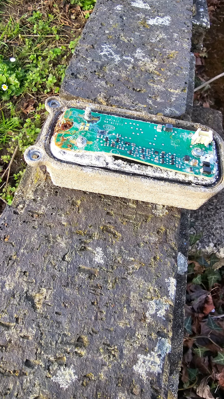

Djandree
Posts: 212
Joined: 17 Oct 2019, 00:10
x 38
Unread post by Djandree »
In most cases water ingress into Dlr. Pcb will look like this...
