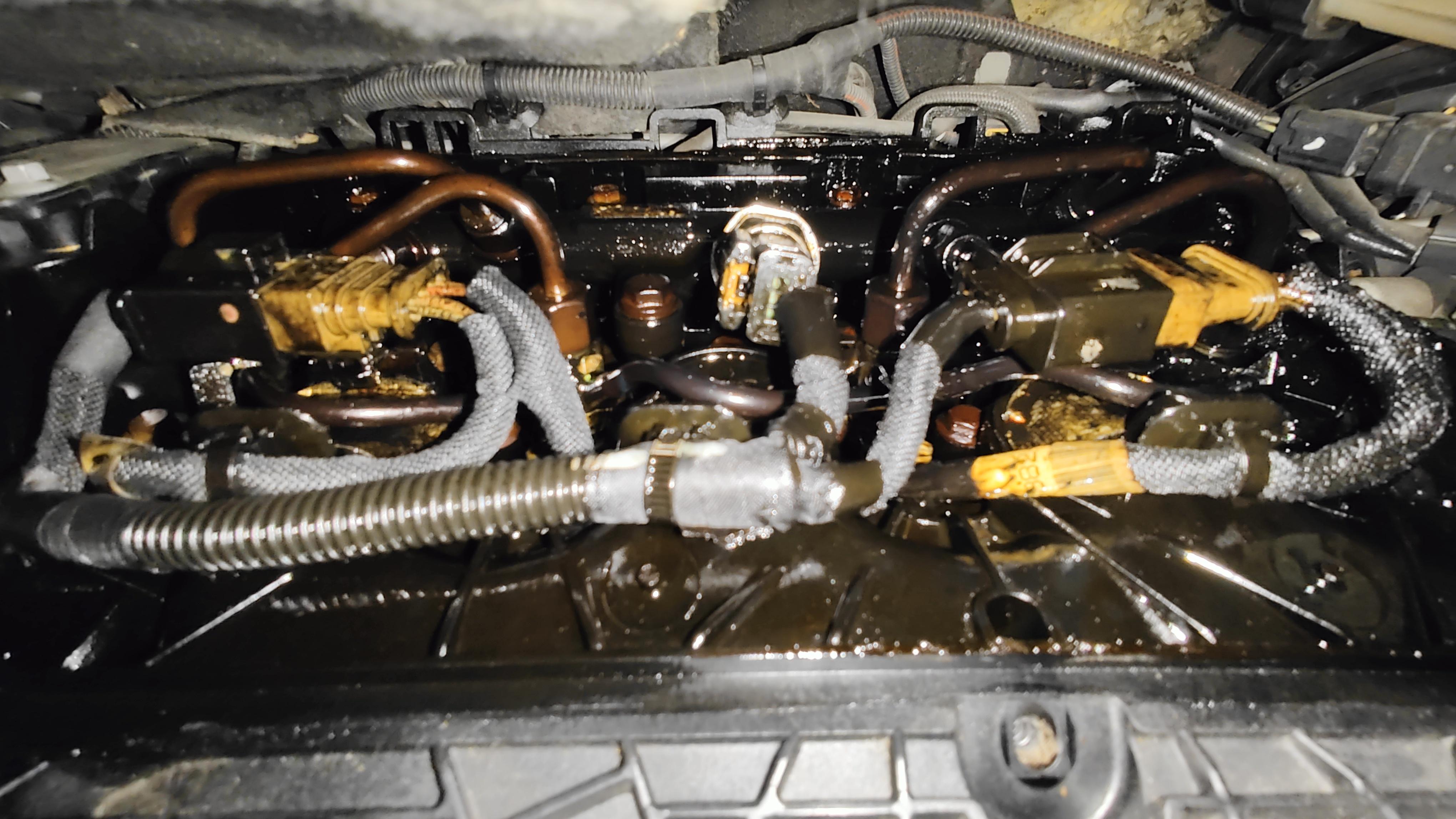

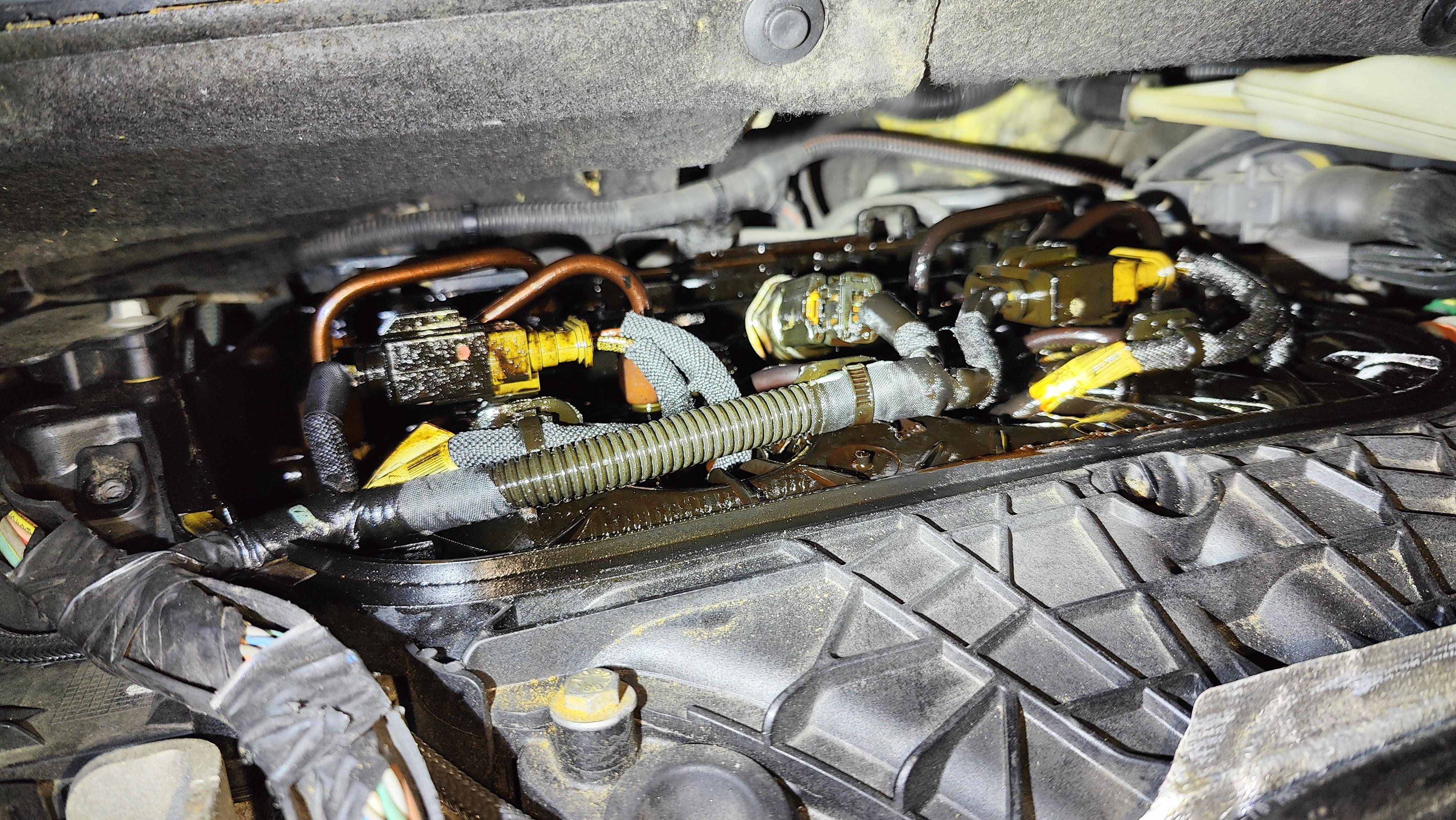

Out of nowhere there was a particularly disgusting smell of burnt oil, so today I went on to investigate. Turns out I most definitely have a leaking injector or injectors (probably plural :mrgreen:):
There is also marvelously smelling smoke coming out of there as soon as the engine starts.
What shocks me most however is that there is very little clearance above the injectors, so there is no way to attach any removal tool like a reverse hammer, a pneumatic injector extractor or whataver contraption I might be using to pull out the (probably seized) injectors.
Has anyone pulled out the diesel injectors of a 2.0 HDi motor on a 308? How is it supposed to be done? Lower the engine? Somehow tilt it forward?

If after removing the connector, high pressure fuel sensor, the high pressure fuel pipes and return pipes, injector and electrical harnesses you find that the injectors are seized, it is necessary to remove the engine-gearbox assembly to use the special extraction tools to remove them.

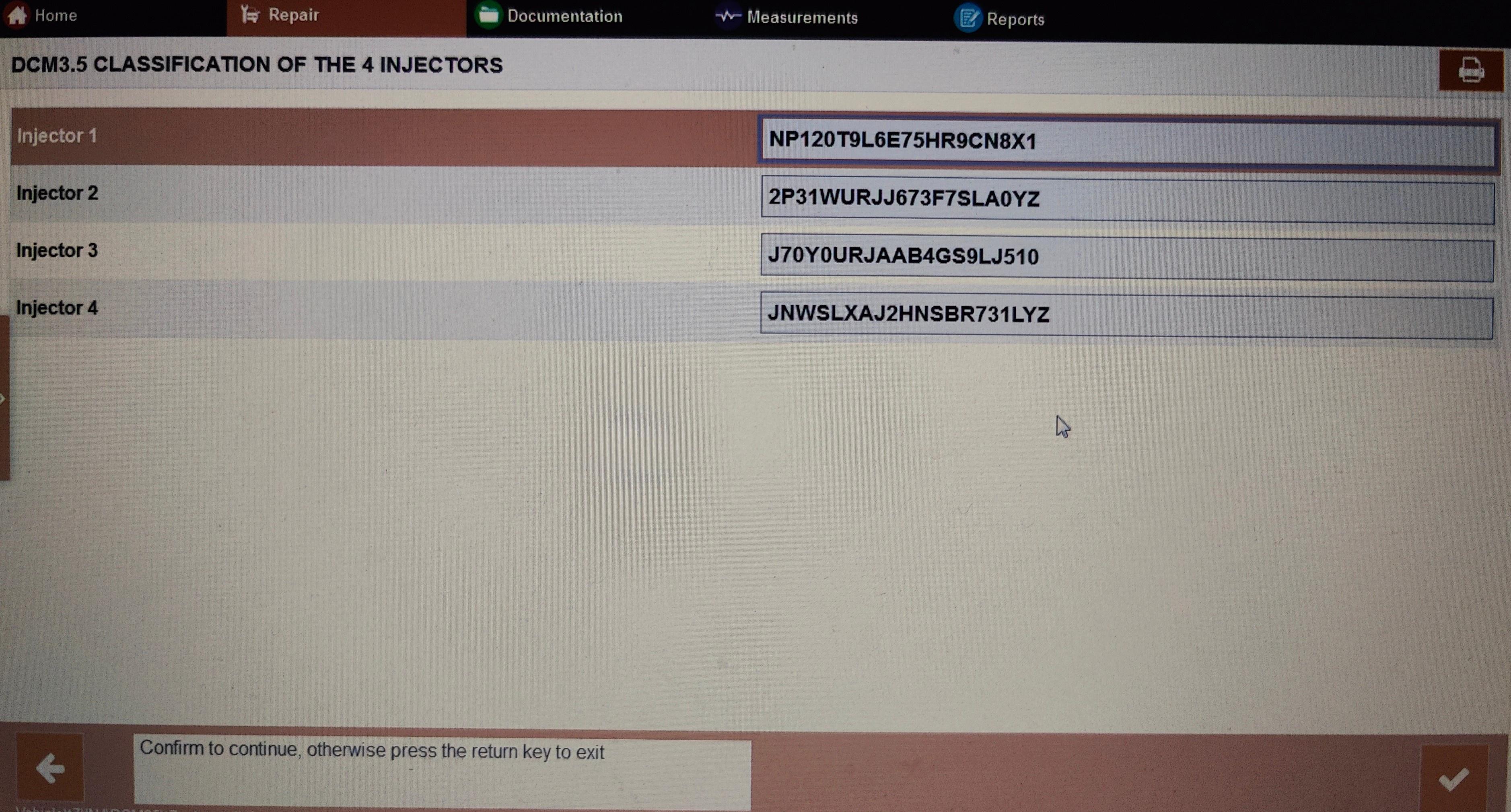

So I guess the coding part is just inputting the injector codes in the software, correct? Here is a screenshot of my current coding:
So all I have to do is replace these codes with those of the new injectors, correct?
