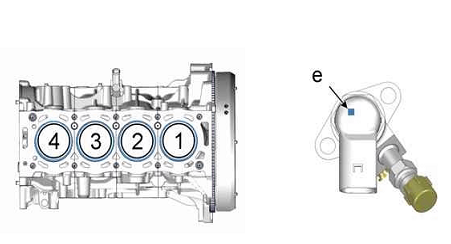

This is what I have for your VIN and the Siemens system:
Programming the new diesel injectors
Notes:
| Marking of the class ( as "e") | Correspondance |
| 4 | Minimum |
| 5 | Nominal |
| 6 | Maximum |
- Diesel injector carriers marked according to injection duct diameter (diesel fuel flow) (class 4, 5 or 6 reference).
- CAUTION - Fitting a diesel injector of a different class causes the particle filtration system to malfunction.
- N.B. It is possible to fit 4 diesel injector-carriers of a different class, provided their new class is configured into the injection ECU.

It's the manufacturing tolerances I believe Elis - some Siemens / VDO and a few of the Bosch earlier systems used a single character to code them - and these have to be the same across the lot of the injectors - but the class can be different as long as the ECU is told about it. Many other systems use the unique injector coding sequence and these have to be entered for each one. I suppose it's a bit like getting the right batch number when you need an extra roll of wallpaper or it will have a slightly different colour for want of a better analogy.

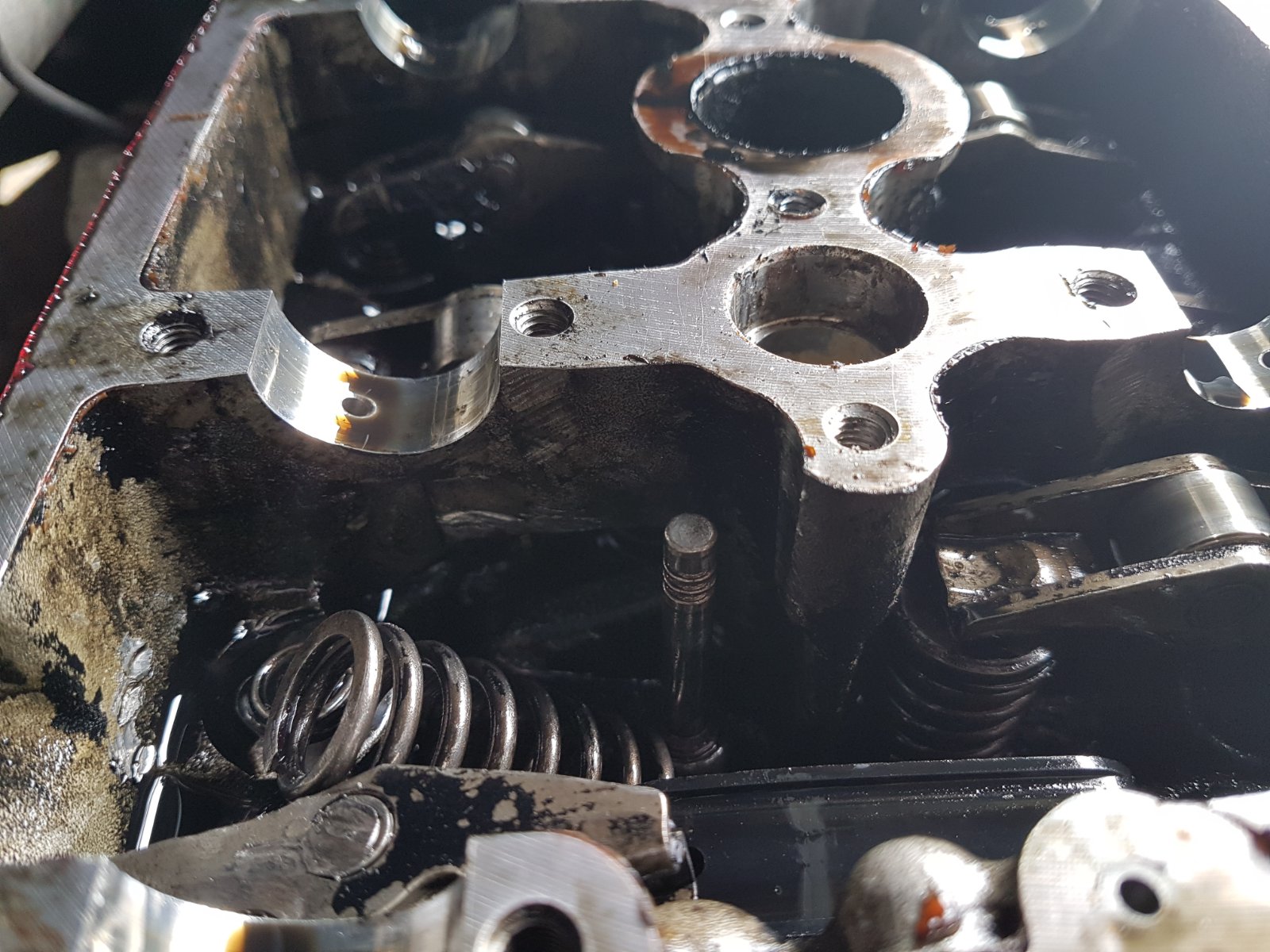

Well this just goes to show how the computer can completely misdirect. The fault didn't go away when I swapped out injector 4. That was a shame, because it only took about 20 mins. Still clattering and running badly.
Timing was checked and found right with the pins.
I popped the top off and saw that one of the (new) exhaust cam lobes was badly scored. A little more investigation showed this Looks like I made a bad choice to put a new cam in a month ago, should have swapped the engine. That exhaust valve has broken somewhere down inside to be standing up that high. I cant find the collets or the broken off ball from the top of the tappet anywhere around up top.
Now have to choose: replacement car or replacement engine. It's done 190k, so not a bad score really.

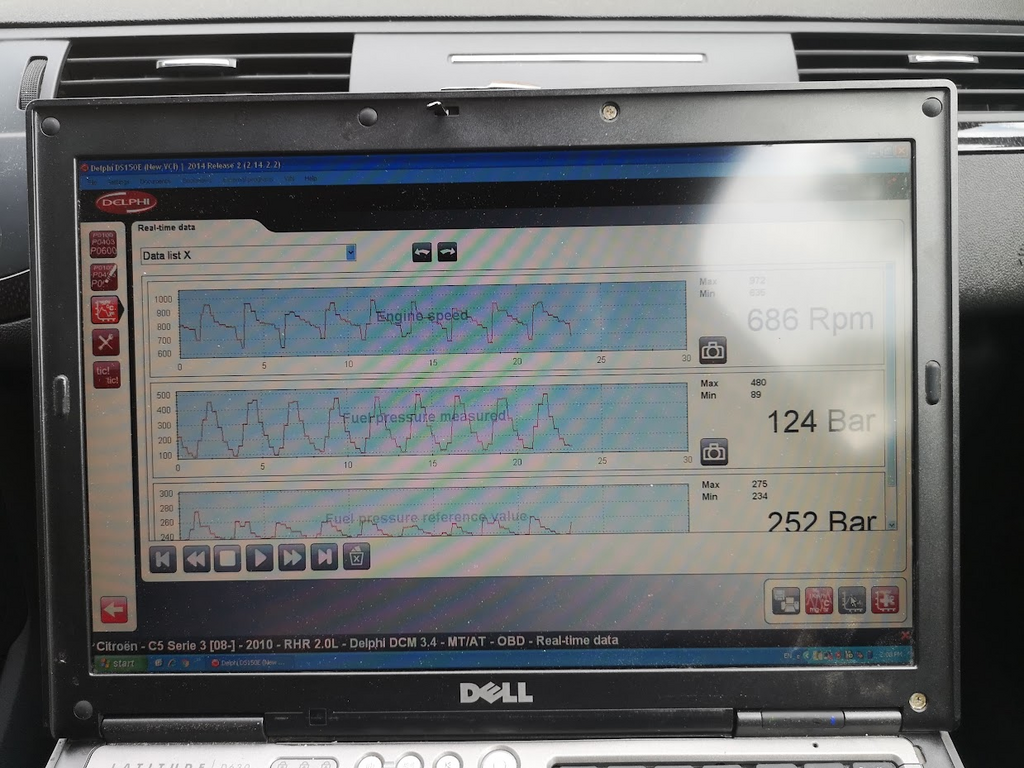

I've got a 2010 2.0 HDI 100kW Citroen C5 with the same engine and I'm suspicious about the injectors. Can anyone confirm? The car has done 460k km+ and I've got no info on the history of repairs.
#1 injector correction at idle -56%
#2 injector correction at idle 103%
#3 injector correction at idle 2%
#4 injector correction at idle -49%
To me it seems that only injector no 2 works OK.
I've got floating idle, black smoke at acceleration and loud injection noise under acceleration in lower rpms for a second.
Also the rail pressure fluctuates.

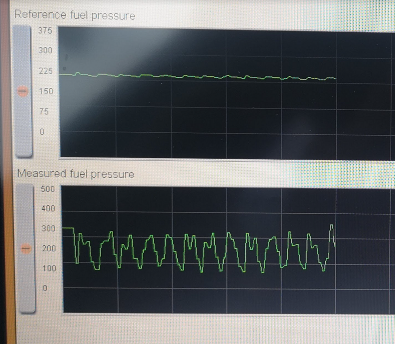

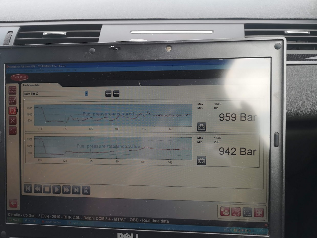

Gave it another go with an Autocom tester (Diagbox is kind of slow). Had the engine speed on the screen as well. Fluctuations are really bad. On the positive side the numbers are better while driving.
Can anyone confirm that the injector code is correct? 1980S3 (2010 2.0 HDI 100kW Citroen C5 RHR / DW10BTED4
