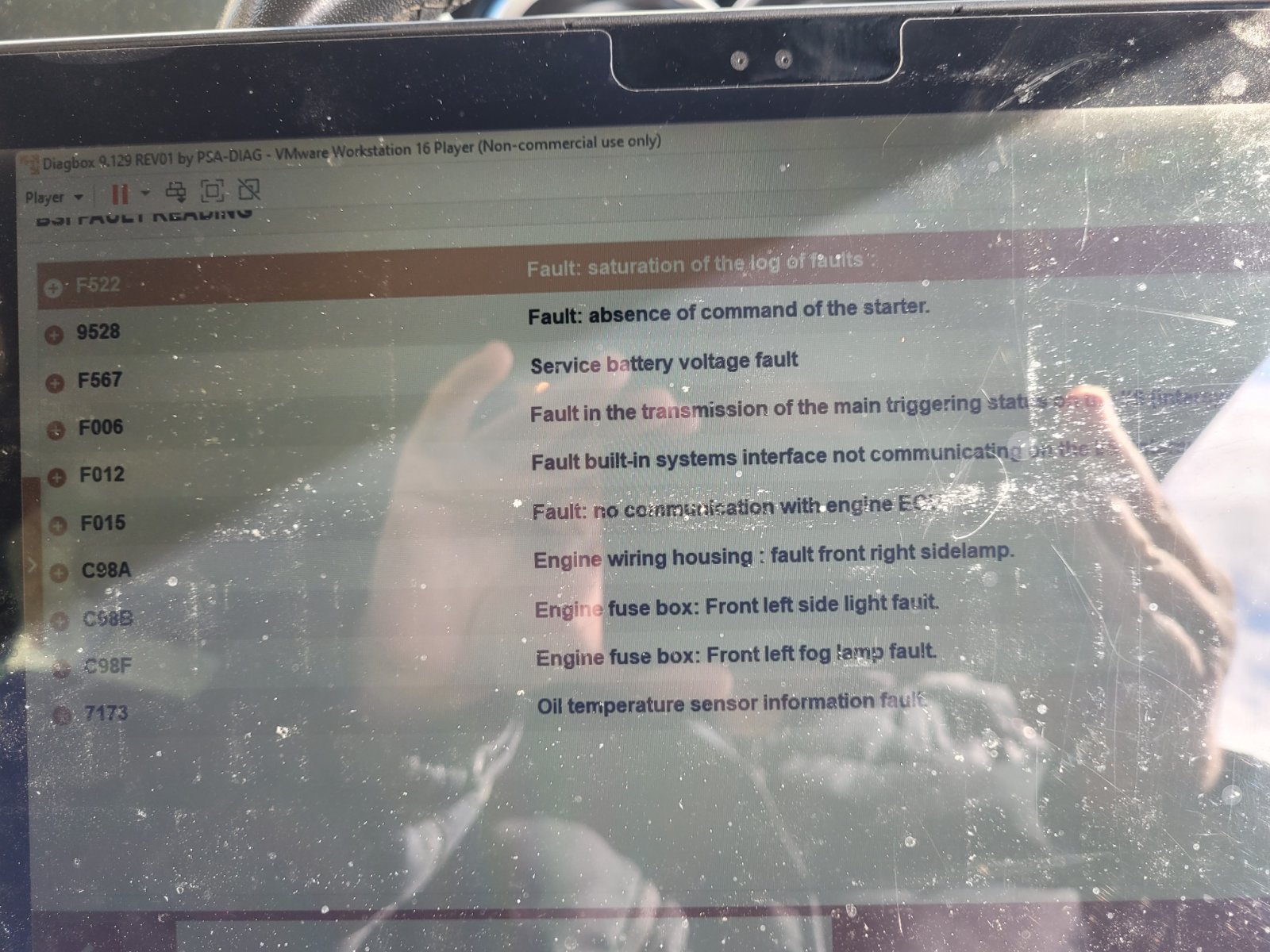

here is the same code from pp2000 diagbox code 9528 - 'Absence of command of the starter

GiveMeABreak wrote: 02 Apr 2023, 15:52 Sorry, can't help you the codes are missing half the info. They should be something like this: P0122 11
here is a copy of the scan
x 6945
Re: 2015 DS3 1.2 not turning. Fault code 0528.(starter does not turn crank)
As you can see these are completely different from what you posted in your first post!
How old is the battery? Have you tried putting a new battery on first of all?
If that doesn't reduce the errors, you'll need a good auto electrician to look at it as you have comms issues with all the major ECUs on the vehicle.
