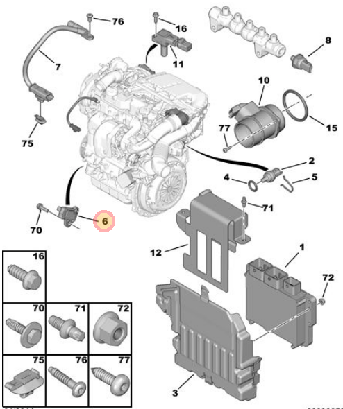

This is wierd, because the car has none of those symptoms related to that. I did read the code after just have started the car on the driveway though, maybe that is the issue. Should try and drive it for a while and then read the codes again. But maybe the speed sensor needs changing even if the code clears? Think I know where it is, should be an easy fix.
The only symptoms that something is wrong is that the enging is running a little rough, slight hesitation on throttle, possibly a little thristy. So maybe the fault code and the symptoms are not related.

The engine speed sensor is used for lots of different things and systems, so is quite relevant here.
This fault mainly comes up under the STOP START system diagnostics, as it relates to the alternator. Your vehicle says it uses a reversible alternator, so does the job of the starter too and the engine speed sensor is used for comparison. If the sensor is faulty it can also lead to other engine issues, so I would suggest replacing that is a god start if the belt looks fine and there's no squeaking from the alternator tensioner pulleys etc.
I recommend NOT getting a cheap Chinese sensor - always get a good branded replacement for peace of mind as we've seen countless issues and wasted time resulting from poor quality sensors.

Got a little confused with the engine speed sensor. Looking at different sites to order one but there is two different types. One with a wire and one with a connector. So I donated £10 so could you please give me the OE partnumber and then I can order the correct type.
x 6955
Re: P1382 2011 308 1,6hdi
Thanks you for your Forum donation.
(6) Engine Speed Sensor (LG 52,6 EP 35 Gold Plated Connector), part: 1920PW, £56.62 inc. UK VAT at 20%.
