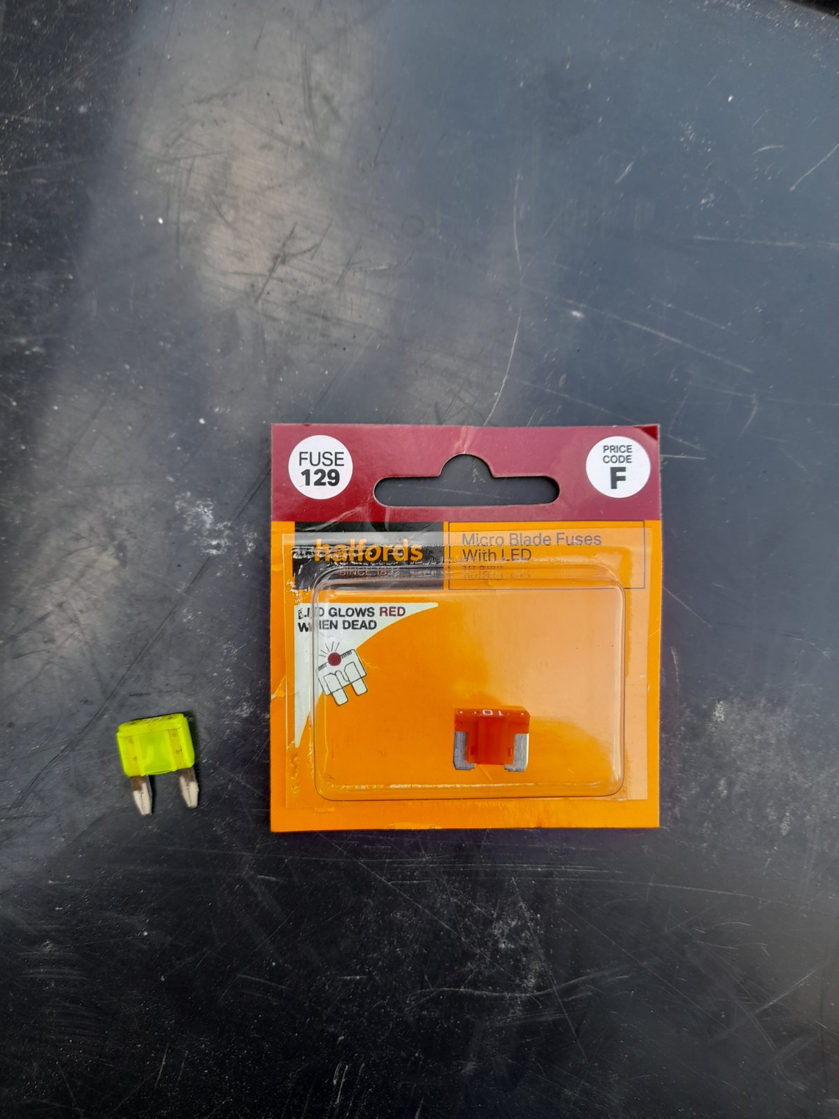

It's a 5 amp fuse, micro in size but really long pins on it!!!! Just can't find anywhere

I binned it, I'll pull another as an example

I have a fair few of the ones on the left. I haven't seen the one on the right before.

Me too, I have most types but the ones you need can be found here:

So Micro 2, thanks guys much appreciated

The ones on the right can be found in some Honda's, Hyundais' & Kia's
You can also get mini fuses like the one on the left but with longer legs

You can normally still fit a standard mini fuse in place of the stubby leg ones as the leg spacing is the same, They just stick out a bit.
