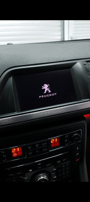

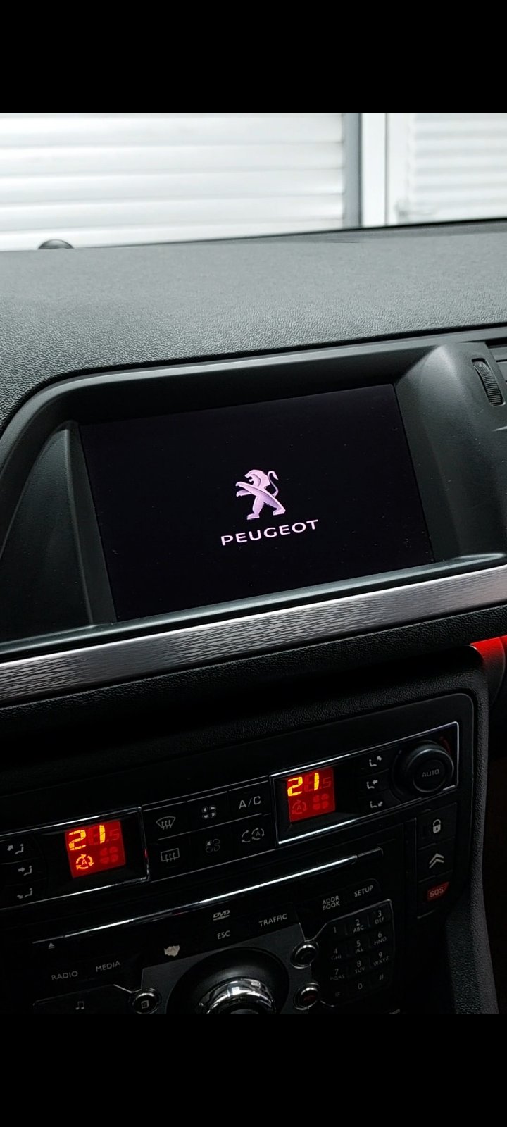

Hello guys!
My C5 x7 with Ng4 has suddenly decided to become Peugeot #-o
I've had the car for over 8 years with its original ng4 system updated to latest firmware 4-5 years ago.
Everything was fine unit today when its started showing Peugeot logo on starting.
I have Diagbox and I have tried to find some option to put it back to Citroen but I wasn't able to find anything.
Is there some option in Diagbox?
If so, can someone expalin to me how to fix this.
Thanks :)

This will have happened only by changing a setting in Diagbox that alters the marque from Peugeot to Citroen or vice versa.
You will need to go into the NG4 ECU or the BSI manual configuration and look for the section on the Marque and correct it back to Citroen.

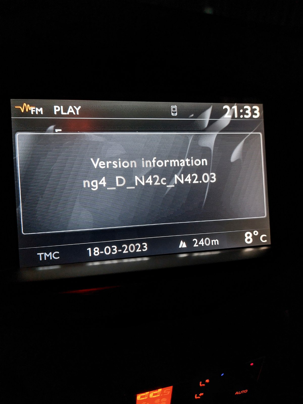

Ok, so I've checked and can't see the area in either the NG4 or the BSI, and whilst reading up I believe this was a bug.
You may find that reinstalling the system firmware again from USB may correct it.

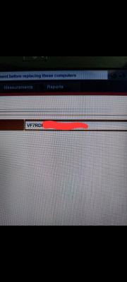

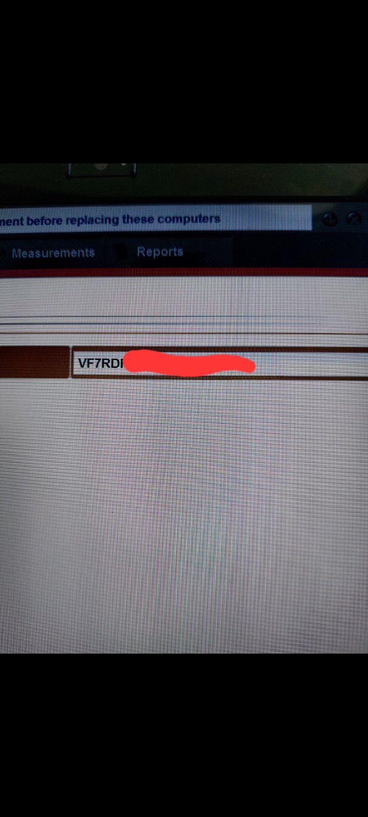

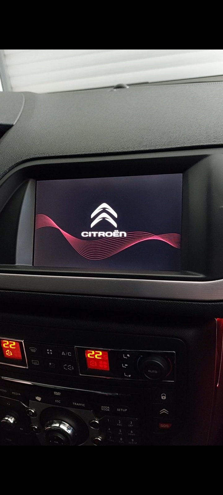

Okay I have found solution!
For some reason Ng4 has lost first letter in Vin settings. It changed from V to ?. [-X
I Have changed it back to V and its now showing Citroen logo as it should! 8-) :-D
Posts: 42019
x 6955
Re: C5 X7 NG4 showing Peugeot logo
V F 3 is Peugeot V F 7 is Citroen, so that would also be a reason. Glad you have it sorted and thanks for the update.
