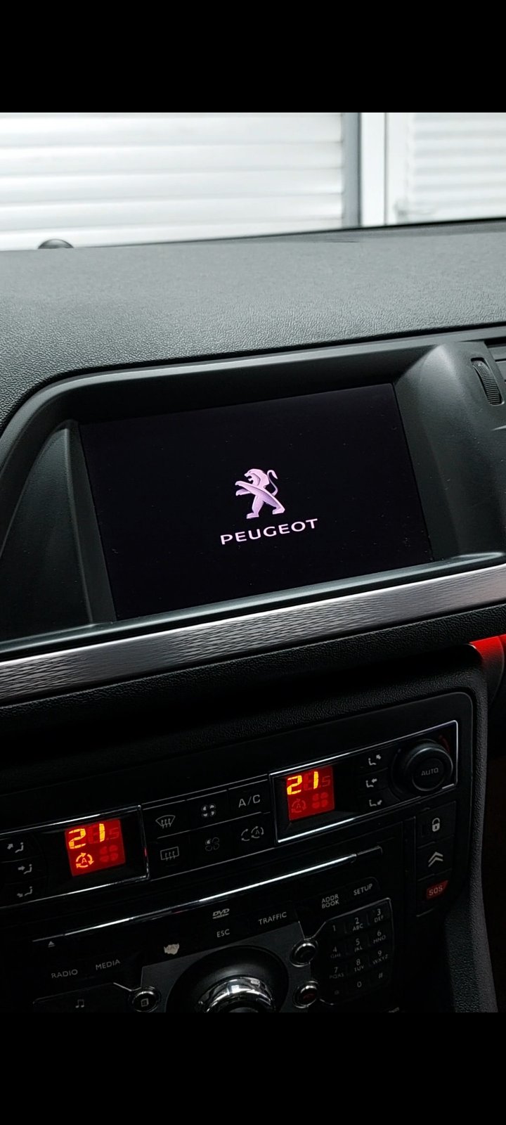

My C5 x7 with Ng4 has suddenly decided to become Peugeot #-o

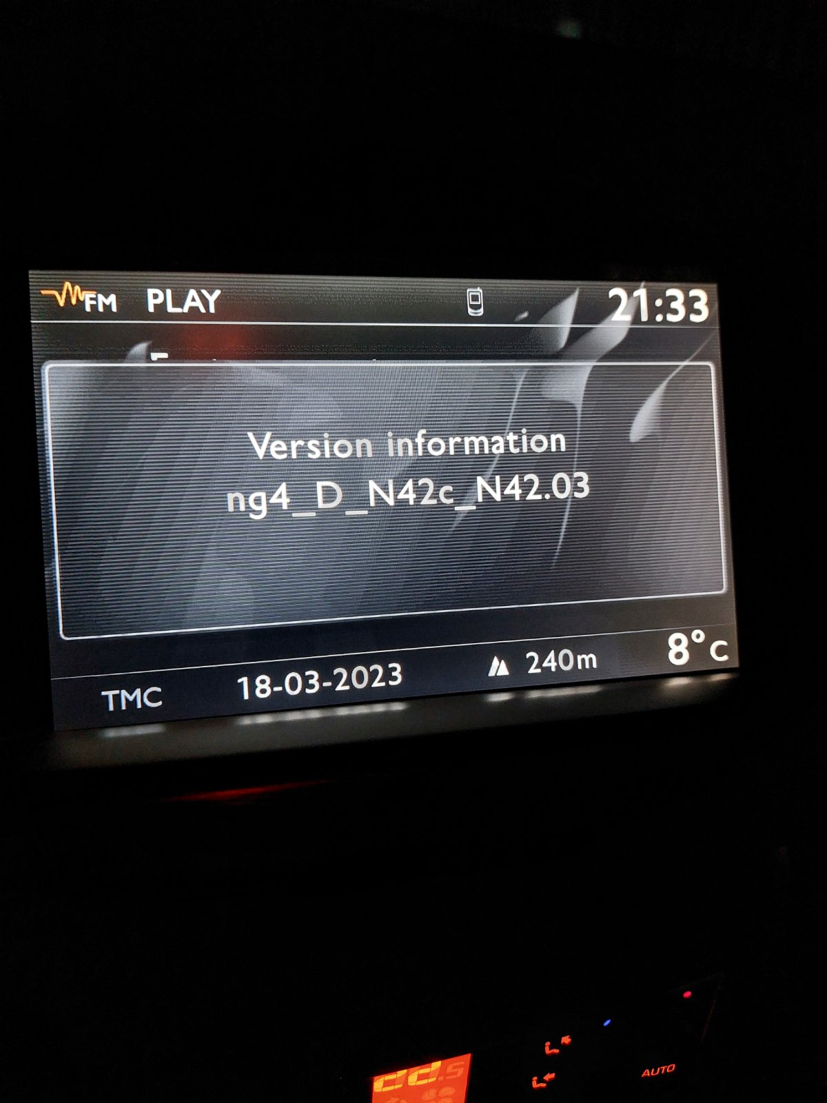

I've had the car for over 8 years with its original ng4 system updated to latest firmware 4-5 years ago.
Everything was fine unit today when its started showing Peugeot logo on starting.

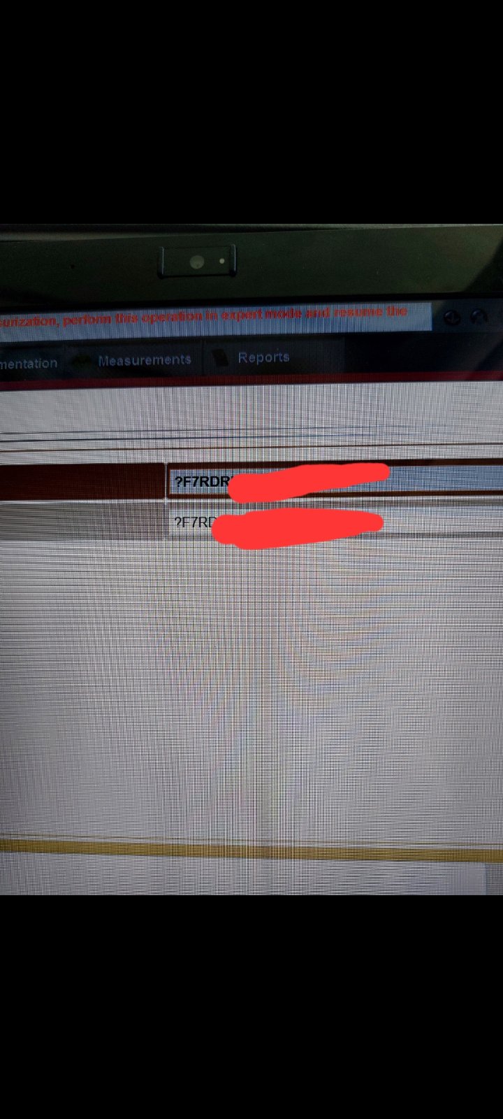

I have Diagbox and I have tried to find some option to put it back to Citroen but I wasn't able to find anything.
Is there some option in Diagbox?
If so, can someone expalin to me how to fix this.
Thanks :)

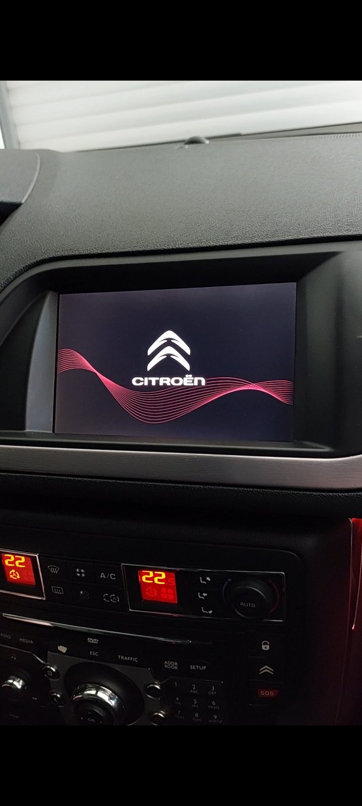

Okay I have found solution!
For some reason Ng4 has lost first letter in Vin settings. It changed from V to ?. [-X
I Have changed it back to V and its now showing Citroen logo as it should! 8-) :-D
x 6945
Re: C5 X7 NG4 showing Peugeot logo
V F 3 is Peugeot V F 7 is Citroen, so that would also be a reason. Glad you have it sorted and thanks for the update.
