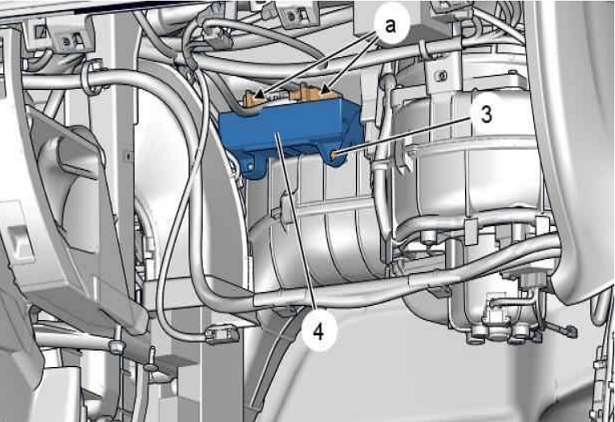

Re: C4 Picasso heating climate problems
As there are both driver and passenger controls at each end of the dash for controlling the system and you have said that both displays are fading, it would lead me to suggest the AC ECU as both these units plug into the AC ECU. What about the rear passenger control units? Are these displays also fading?
I would suggest that you get the AC ECU diagnosed as faulty to confirm this.
The ECU itself is on the right side of the fascia, shown here as item (3):
All the control panels front and rear feed into this ECU

Second hand ecu is only cheap on eBay if I get one the same part number to try is it just plug and play or does it need to be programmed in
x 6956
There are various part numbers for this unit, so ensure you have an identical part number. Whether it will need any configuration I can't say from here of course, but there is nothing to suggest that it does from the info I have.

Unread post by shaun1983m »
Just an update thanks for your help bought a second hand ecu off eBay £12 bargain replaced the old one it is a bit fiddly but 10 mins later all working fine thank you 🙏
