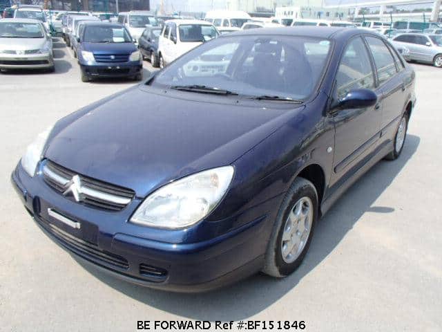

Xantianut wrote: 09 Mar 2023, 20:40 More heat. More swearing. I'm going to have a blue car soon......
Blue is a good colour for a C5:
So yeah, crack on with the swear words, if you swear at it enough you'll also give it a full respray in blue paint as well as a mechanical overhaul :rofl2:

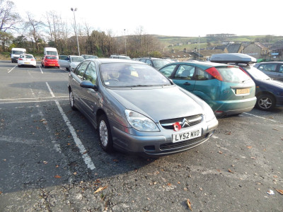

Just thought you'd like to see the old bus. Aka Otterchops aka My Little Girl aka The Cruise Missile aka You Little $€¥%!
