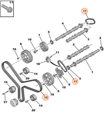

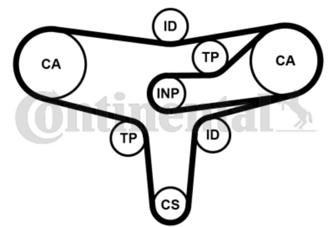

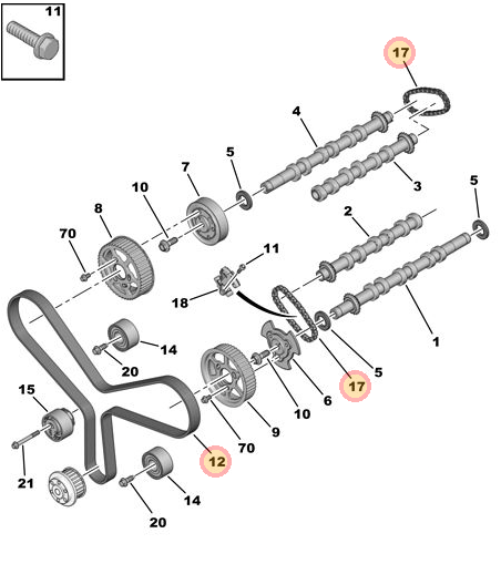

There is one timing belt (12) and 2 Timing Chains (17)
(12) Part: 0816K2, £129.60
(17) Timing Chains Part: 0816G9 are £70.14 each.

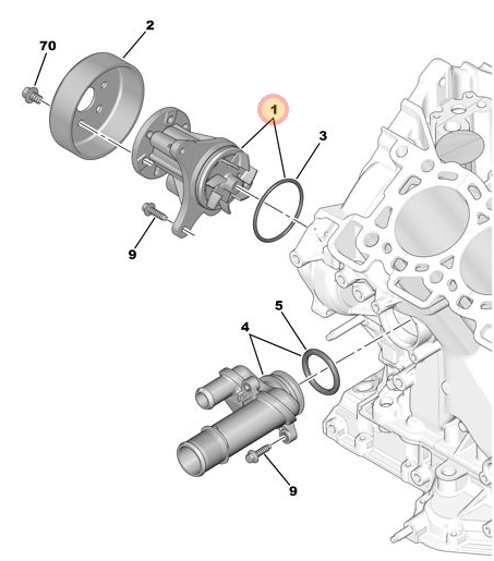

Coolant Pump
(1) Coolant Pump Citroen Original, part: 1201G6, £113.68
(1) Coolant Pump Citroen Cheaper alternative, part: E111672, £102.07

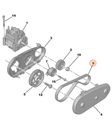

It's probably because it's a separate area (injection) and not listed with the timing:
(9) Injection Pump Toothed Belt, part: 192671, £100.67
It will take me a while to put these up, so I'll leave a link back on this thread when I finished these in an hour or so.

On any of my C6's I replace all the coolant related stuff at the same time as both belts. These include:-
Water Pump, Thermostat, coolant inlet (items 4 & 5 on Marc's water pump picture).
The inlet is a bitch to do but will break at or around 100k miles or 10 years and as the temp sensor is mounted high on the engine, you get no warning when it drops all the coolant out of the bottom until your engine goes bang!
