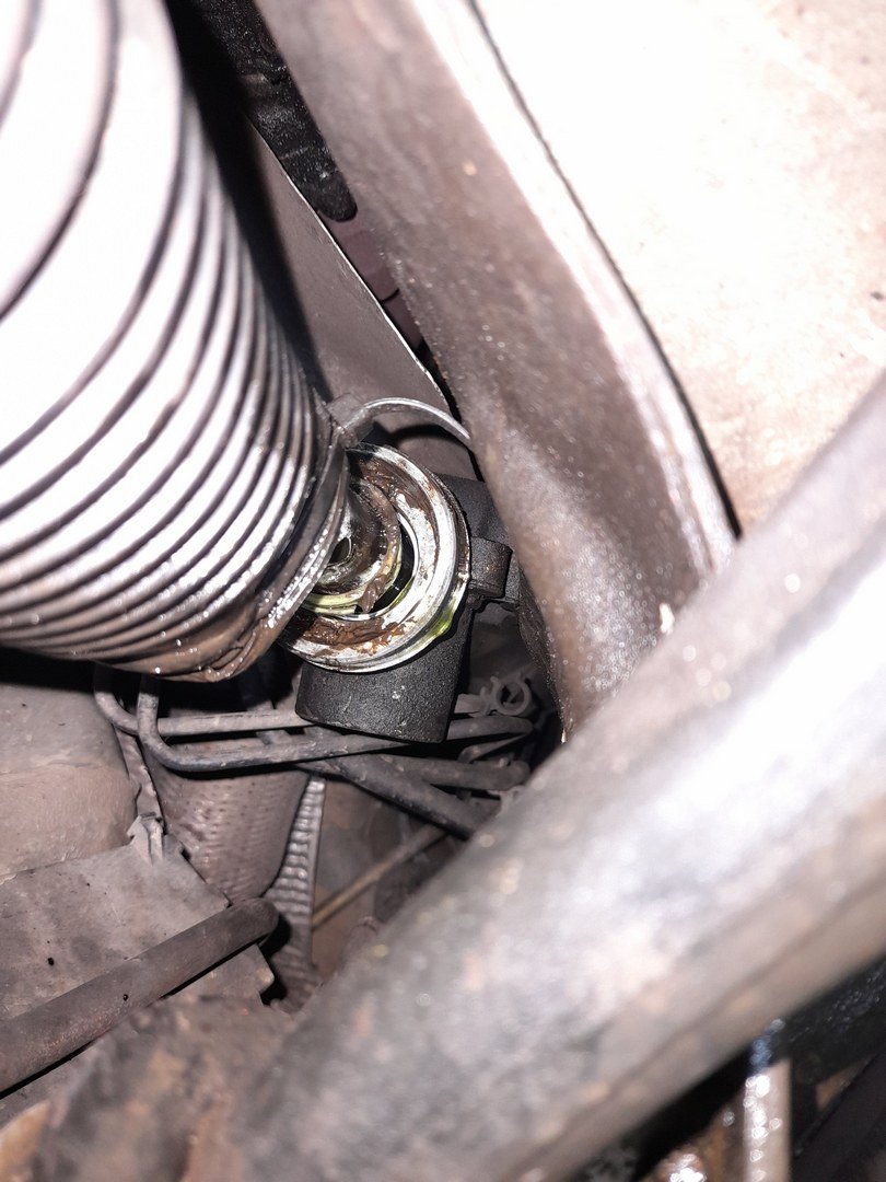

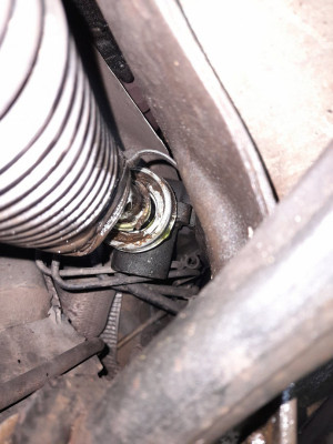

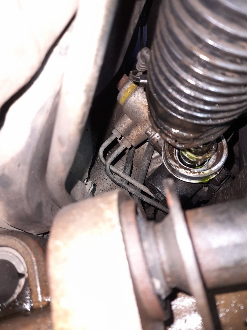

The gaiter has come off, but the problem is the seal on the steering rack, where the actual rack moves in and out of the housing, has failed; the inner part of it is moving with the steering rack. Can this seal be replaced - after removal of the rack ends - without removing the entire steering from the car?Paul-R wrote: 13 Feb 2023, 10:36 It's the rack gaiter that's some off, isn't it? These can be bought and normally replaced on the vehicle although, not having done the job myself, I don't know how difficult it is.

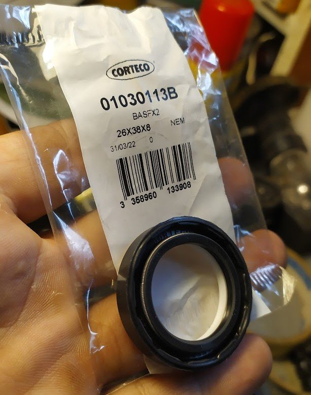

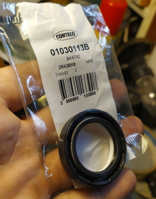

Hi there,MichaelC5 wrote: 14 Feb 2023, 05:12 I can get a seal for the end of the rack. Does anyone know if the seal can be replaced with the steering fitted in the car?
do you handle with this leak? I have similar problem, leak from right sealing on rack. Got correct sealing (corteco 01030113B 26x38x8 seal with white teflon insert) and I think about chances to replace without removing rack from car. Your experience will be very helpfull.

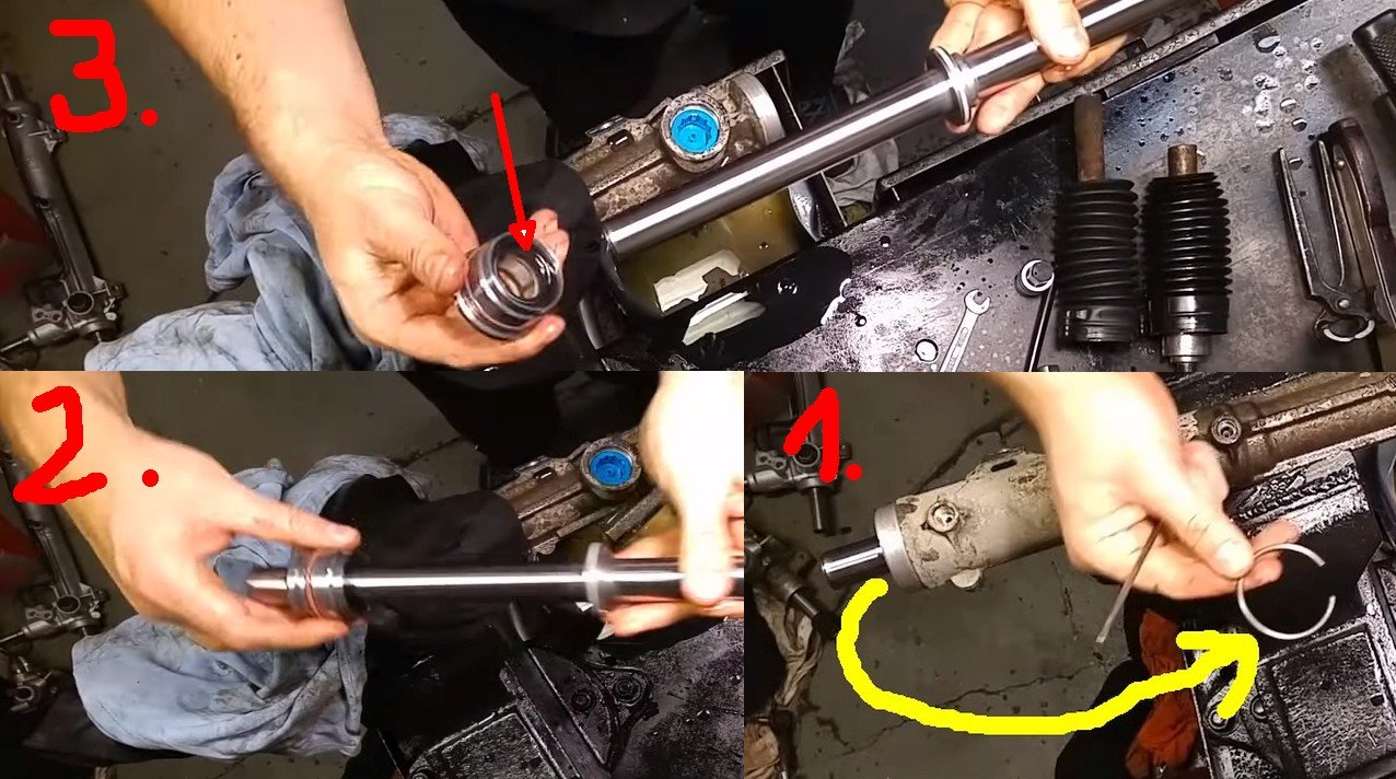

Rack construction in C5 looks a bit another. There is only wire ring to secure bushing with sealing. If remove rack end and this wire ring i hope will be able to push out this bushing and replace sealing. I make some screen shots from this movie to show what my plan
Anybody can confirm my plan?
