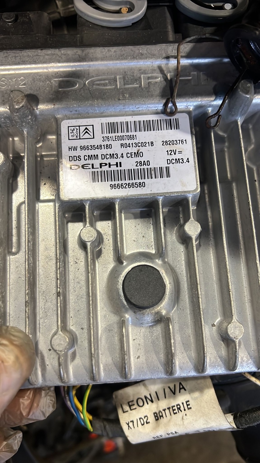

Edit: i also have another engine (well i actually have 6 spare cars) with delphi injection system. If i use this one with my original engine ecu all should be plug and play i think? Im attaching photo of the delphi donor engine ecu.
Donor delphi engine ecu

Officially, if replacing a new engine ECU, you would need to have the confidential customer code for your existing vehicle, fit the engine ECU and then go to replacement parts and specify replacement. Then there is a procedure for pairing the engine ECU to your BSI. After that the diagnostic tool needs to be connected to PSA servers to update the software on the engine ECU.
Whether there is additional programming or configuration after that I can't say for sure. But you would need a PSA account and pay for tokens to do this from Citroen. But again, whether they would allow or block your clone VCI once connected I can't say...
If you are going to do this be warned, and also it would be a good idea to screenshot all the settings and configuration pages in your existing engine ECU which may be similar to the one you are replacing it with.
Also be warned that if you manage the first step in pairing the donor engine ECU to your existing BSI, then you may have locked out your existing engine ECU to the BSI, so if you have problems I suspect you may not be able to just plug your old one back in. Don't forget your key fobs will also not work to start the car as they won't handshake with the engine ECU once that is replaced without programming.

In that case i will use the engine with delphi injectors and will use my original engine ecu.
