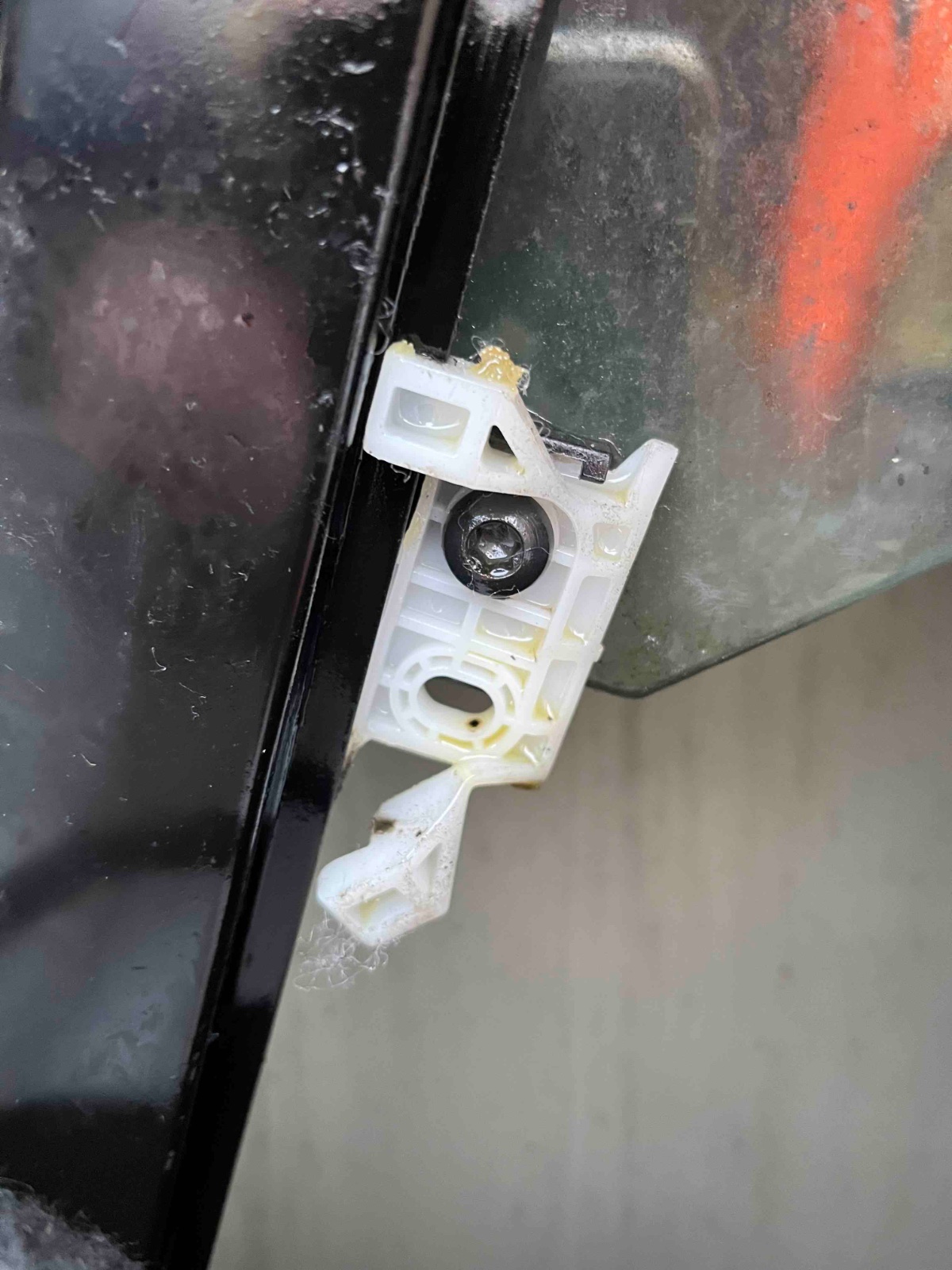

Whilst investigating I found the rear window regulator runner clip inside the door is broken.
Don't suppose anyone has a spare or know if they can be bought separately without having to buy a complete regulator assembly?
Are these clips supposed to have 2 screws holding them on to window glass?
Many thanks as always.

Also fitted a new window regulator as discovered the old one was well on the way to self destruction. Much better to find these earlier rather than later.
