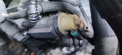

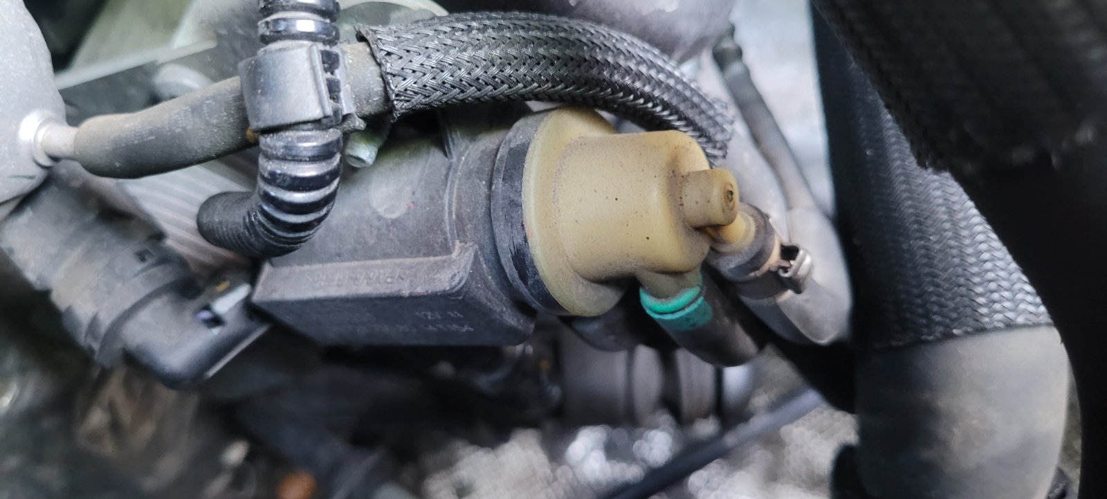

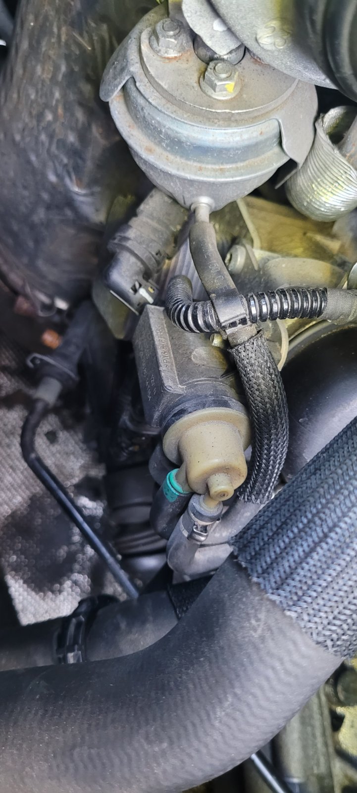

After changing the bottom radiator hose and refilling the coolant system I get the above warning lights. I note that below the hose as it enters the engine there's a mechanism that looks as if it's hydraulic in nature. I may have disturbed it or the electrical connections. Tight space and The wire may have been strained.
My question is.... Is this mechanism anything to do with the ESP/ABS? It's on the left front of engine underneath to the left of the turbo (I think) I'll have a picture tomorrow I hope.

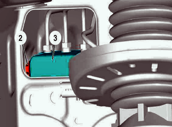

Ok, so the ABS Hydraulic Block and ECU are hidden up behind the front right wheel arch (Driver's side) underneath the wheel arch splash guard and then behind another secret panel:
So unless you have a pressure washer on steroids, it's unlikely to be related - but not impossible of course. :-D

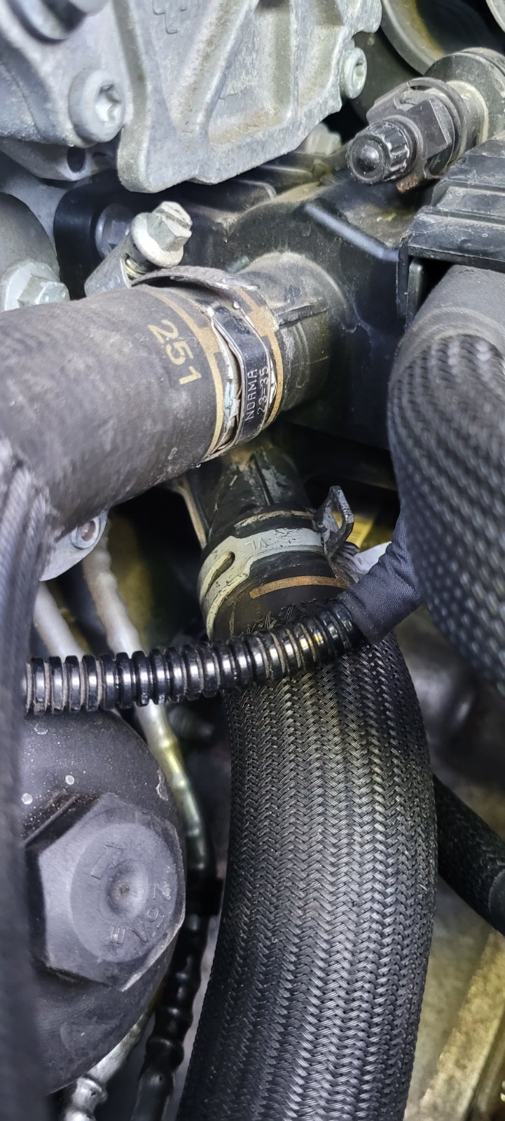

Well after getting some time to see if there's any water/dampness got into any electrical systems I've found a wiring loom that terminates underneath the coolant pipe as it enteres the engine block.
There seems to be a device (possibility the ESP ecu?) Directly under where the coolant was spraying. Could anyone tell me if this is where that particular ecu is located or what it could be. It is attached to the top of the bell housing slightly to the left. It is difficult to get to without disconnecting both coolant hoses.
Thanks in advance.

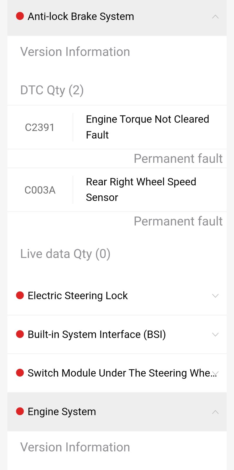

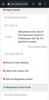

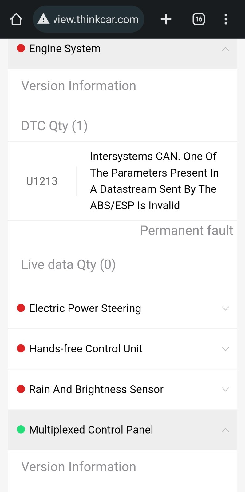

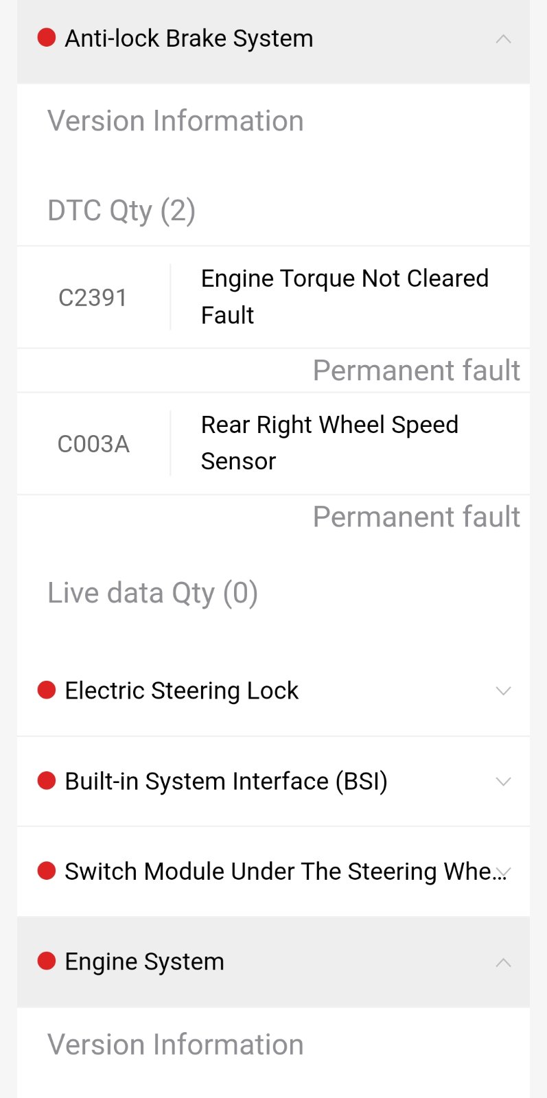

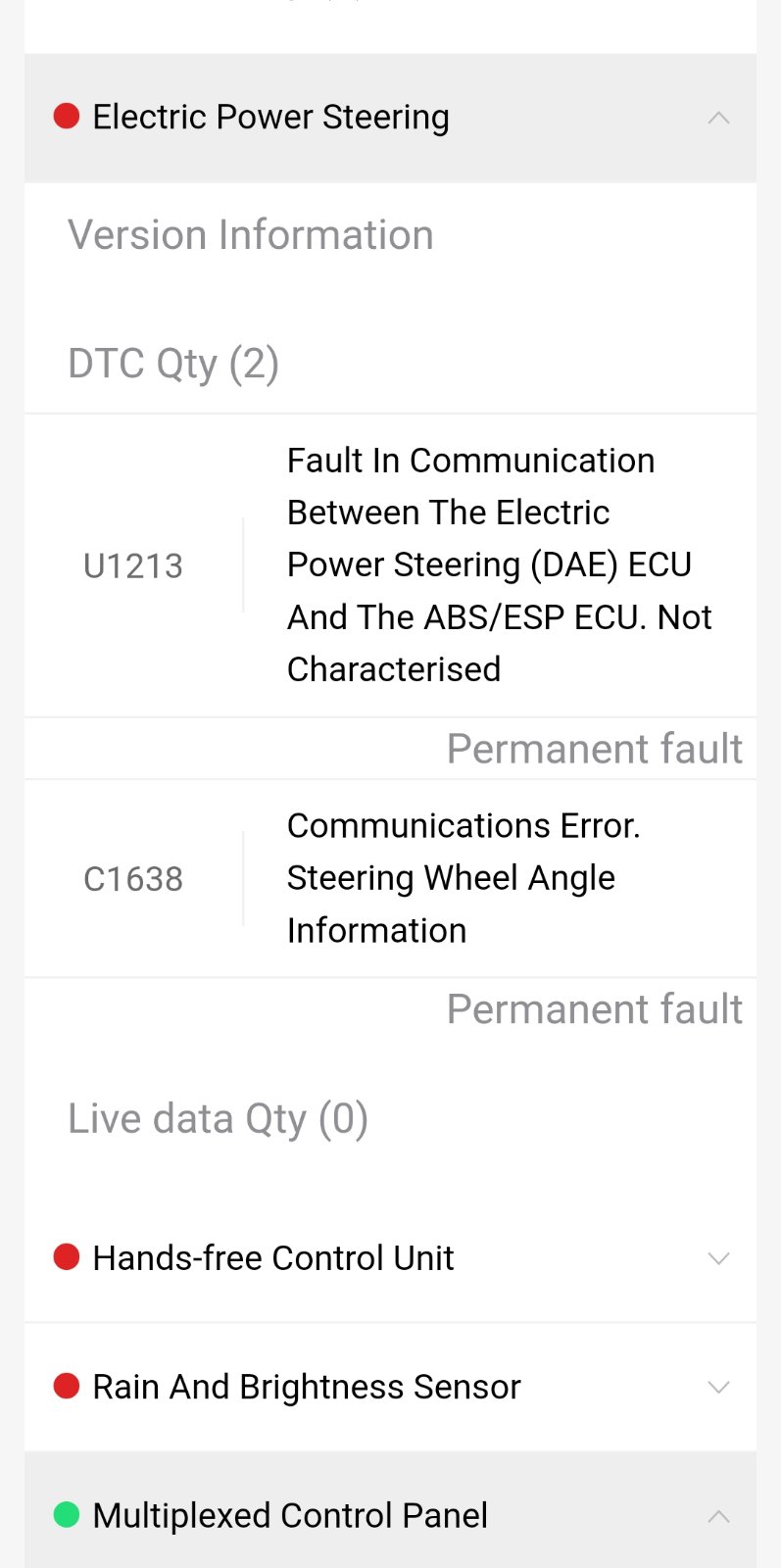

Well it seems the diagnostic tool I have isn't all that great after all. It missed some error codes from a few other modules. The steering module is not talking to the ESP or engine ECU.
Not entirely sure where to start now.😭

Steering angle is reading -780°. Saying it's not calibrated. Wheel sensors are reporting wildly different speeds, even when stationary.
Oh man what have I done....🤢

Unfortunately errors to do with the ESP system are not always that simple to determine as the data is collected from various components like the wheels sensors the engine ECU the Power Steering ECU, Steering Angle and Yaw sensors etc., and sent on to other systems.
The steering wheel angle sensor is contained within the electronic module in the steering wheel and has to be calibrated if the ESP unit is removed / replaced, but given that you are also saying you have incorrect speed readings from the wheel speed sensors when the vehicle is stationary, suggests that it is a data communication issue and that the data is garbled or not valid. I can't see that all these problems are down to the individual components, so would indicate to me a faulty ESP ECU or a CAN data communication wiring problem.
Given the apparent multiple I think it needs going to either a dealer or an experienced auto electrician for some detailed checks and to try and pinpoint the problem. I certainly wouldn't want to start changing parts until the underlying problem is determined.

Fault Code: U1213
Description of Fault: Fault in communication between the electric power steering (DAE) ECU and the ABS/ESP ECU.
