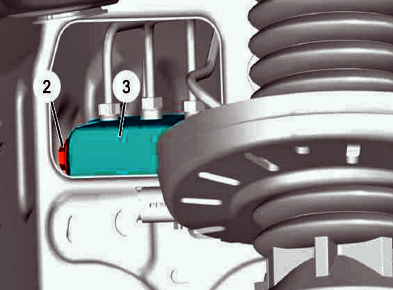

Ok, so the ABS Hydraulic Block and ECU are hidden up behind the front right wheel arch (Driver's side) underneath the wheel arch splash guard and then behind another secret panel:
So unless you have a pressure washer on steroids, it's unlikely to be related - but not impossible of course. :-D

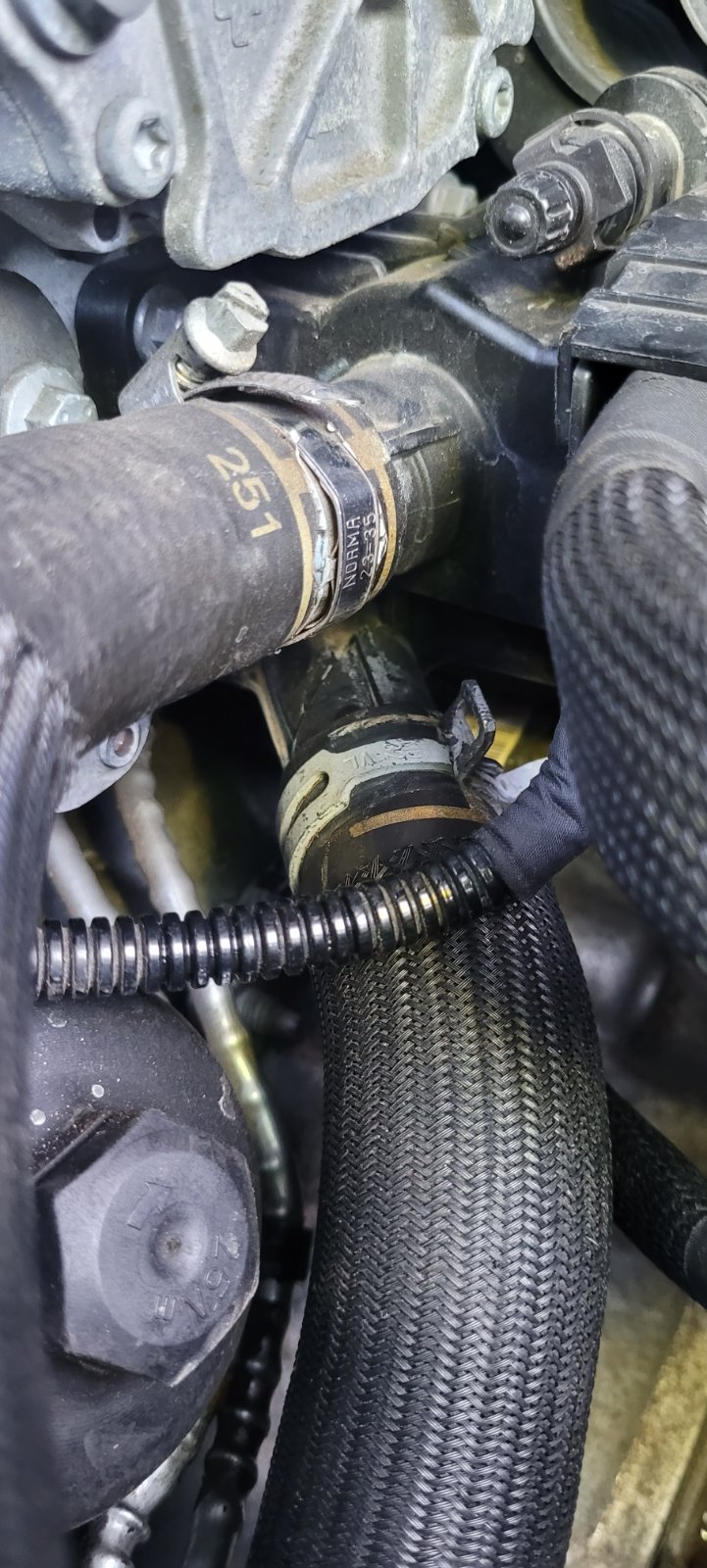

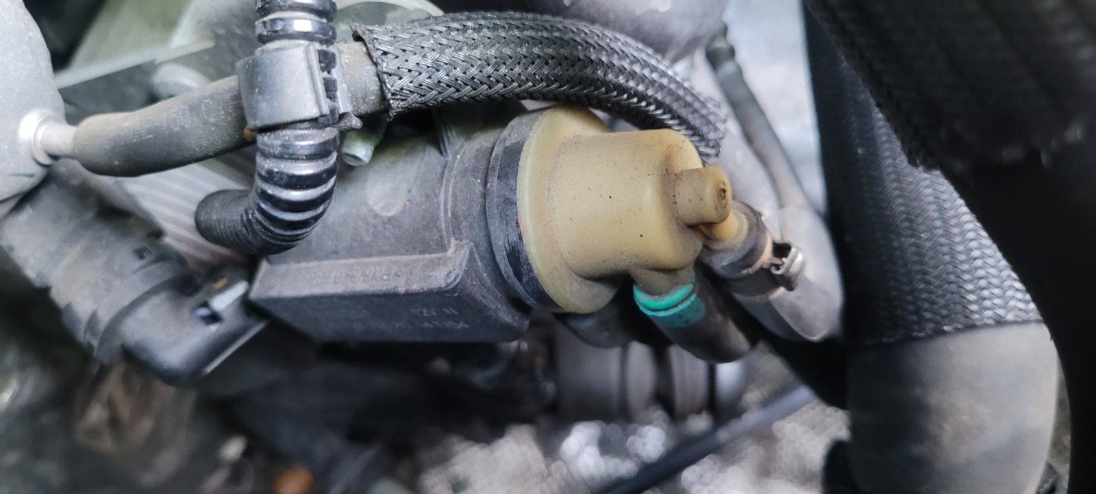

Well after getting some time to see if there's any water/dampness got into any electrical systems I've found a wiring loom that terminates underneath the coolant pipe as it enteres the engine block.
There seems to be a device (possibility the ESP ecu?) Directly under where the coolant was spraying. Could anyone tell me if this is where that particular ecu is located or what it could be. It is attached to the top of the bell housing slightly to the left. It is difficult to get to without disconnecting both coolant hoses.
Thanks in advance.

Ok scratch that. According to Haynes online I am looking at the transmission control unit. Which isn't giving any issues so far. ESP and ABS are the same unit.
Can anyone tell me what this is?

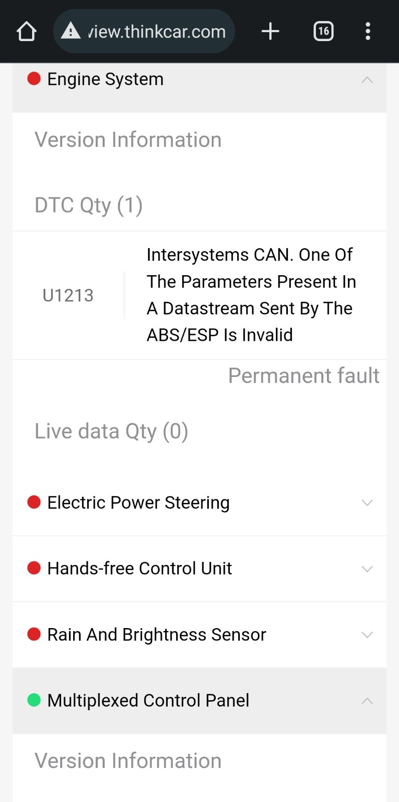

Well it seems the diagnostic tool I have isn't all that great after all. It missed some error codes from a few other modules. The steering module is not talking to the ESP or engine ECU.
Not entirely sure where to start now.😭

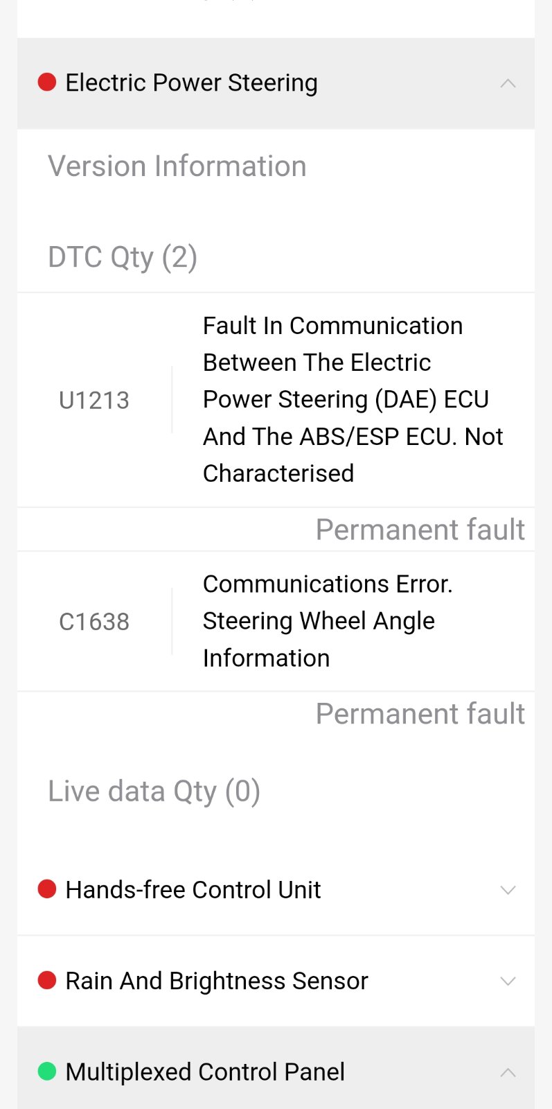

Steering angle is reading -780°. Saying it's not calibrated. Wheel sensors are reporting wildly different speeds, even when stationary.
Oh man what have I done....🤢

Unfortunately errors to do with the ESP system are not always that simple to determine as the data is collected from various components like the wheels sensors the engine ECU the Power Steering ECU, Steering Angle and Yaw sensors etc., and sent on to other systems.
The steering wheel angle sensor is contained within the electronic module in the steering wheel and has to be calibrated if the ESP unit is removed / replaced, but given that you are also saying you have incorrect speed readings from the wheel speed sensors when the vehicle is stationary, suggests that it is a data communication issue and that the data is garbled or not valid. I can't see that all these problems are down to the individual components, so would indicate to me a faulty ESP ECU or a CAN data communication wiring problem.
Given the apparent multiple I think it needs going to either a dealer or an experienced auto electrician for some detailed checks and to try and pinpoint the problem. I certainly wouldn't want to start changing parts until the underlying problem is determined.
Fault Code: C1638 61
Description of Fault: Steering wheel angle information: Incorrect value.
Description of the diagnostics: Possibility 1
- With steering wheel angle sensor: Fault detected if the steering angle sensor is not initialised or calibrated.
- The fault immediately appears.
Possibility 2
- No steering angle sensor: Fault detected if the value for the centre of the steering wheel is lost as a result of prolonged operation.
Conditions of activation of the diagnostics:
Possibility 1
- Ignition on
Possibility 2
- Vehicle speed higher than 48 km/h
Conditions for Fault to clear: Steering angle sensor calibrated
Downgrade Modes whilst Fault is active: Deactivation of the ESP function
Symptoms:
  • Switching on of the ABS/ESP/EBFD warning lamps with/without error message
Suspect Areas:
  • Electric power steering
  • ABS/ESP ECU
Fault Code: U1213
Description of Fault: Fault in communication between the electric power steering (DAE) ECU and the ABS/ESP ECU.
Possibility 1
- Steering wheel angle absolute value above the maximum threshold
- The time for recording the fault code is 200 milliseconds
Possibility 2
- Longitudinal acceleration calculated at the front wheels not valid
Possibility 3
- Lateral acceleration below the minimum threshold or above the maximum threshold
- The time for recording the fault code is 1000 milliseconds
Possibility 4
- Vehicle yaw speed below or above the threshold
Possibility 5
- Speed of the front left wheel higher than the vehicle speed
- Speed of the front right wheel higher than the vehicle speed
Possibility 6
- Speed of the rear left wheel higher than the vehicle speed
- Speed of the rear right wheel higher than the vehicle speed
Conditions for Fault to clear: Ignition switched off and on again
  • Active return of the steering wheel deactivated
Symptoms:
  • Steering too soft
  • Loss of the semi-automatic parking assistance function
  • Loss of the Stop and Start function
  • Steering wheel return incorrect
  • Steering stiff
  • Noise in the power steering
Suspect Areas:
  • CAN network
  • Connector
  • Electrical harness
  • ABS/ESP ECU
