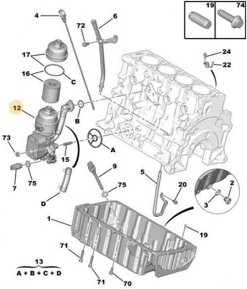

Re: Oil cooler replacement procedure
Ok I thought you may have changed your car for an Auto.
It's not shown as a separate part...

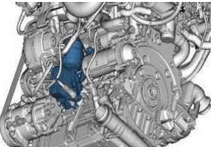

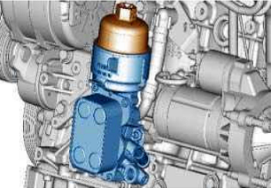

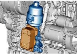

Here you go, this may help with oil leak sources in this area....
Possible Leak Sources
Oil Filter Support
Sealing: Detachable seal
Probability: Low
Possible causes:
- Incorrect tightening of the fixing bolts
- Detachable seal sealing fault
- Incorrect positioning of the seal
Access: Average
Repair: Replace the seal
Exchanger on Oil Filter
Sealing: Detachable seal between the exchanger and the oil filter support
Probability: Low
Possible causes
- Gasket sealing fault
- Absence of the watertight seal
Access: Easy
Repair: Replace the oil filter support
Cover on Oil Filter
Sealing: Seal on the cover bolted on the oil filter support
Probability: Low
Possible causes
- Incorrect bolting
Access: Easy
Oil Pressure Sensor on Oil Filter Support
Probability: Low
Possible causes
Access: Easy
Oil Gallery Balls on Oil Filter Support
Sealing: Balls force-fitted with sealing paste
Probability: Low
Possible causes
- Ball shape fault
- Absence of sealing paste
Access: Easy
Repair: Repair of the sealing of the area using an approved product
