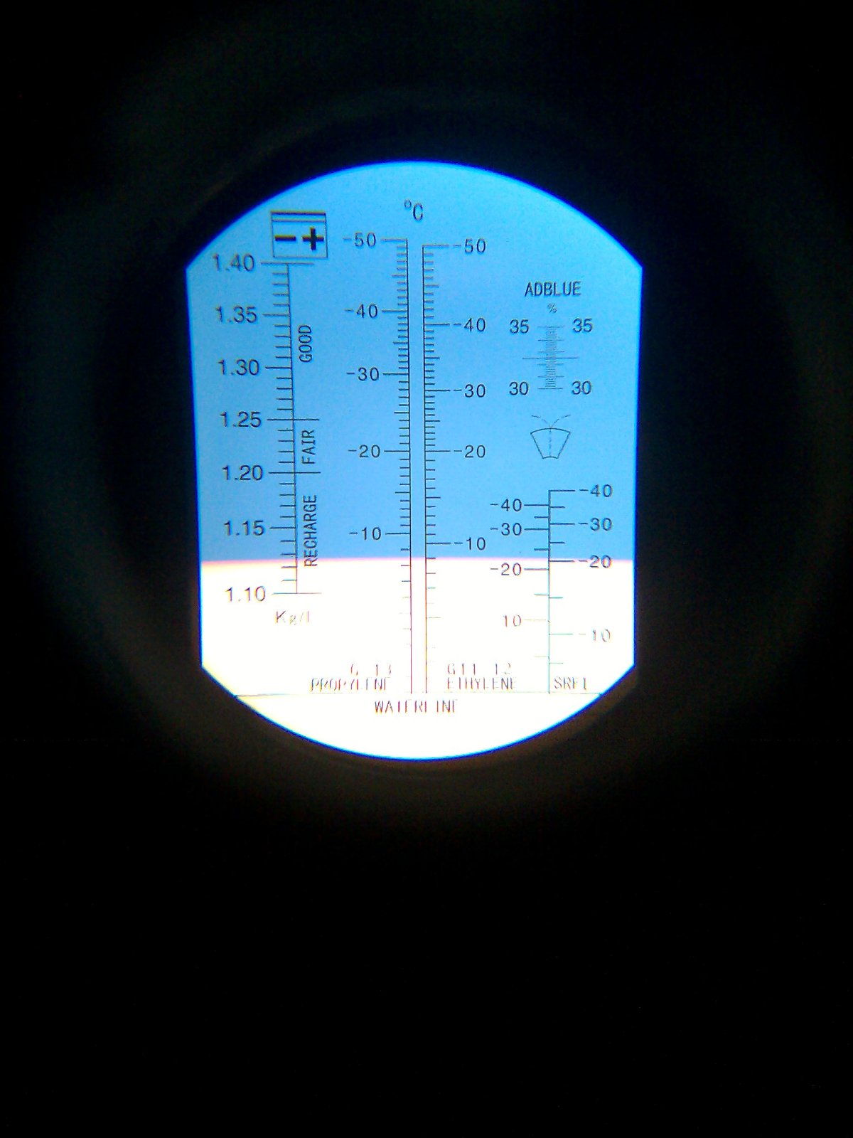

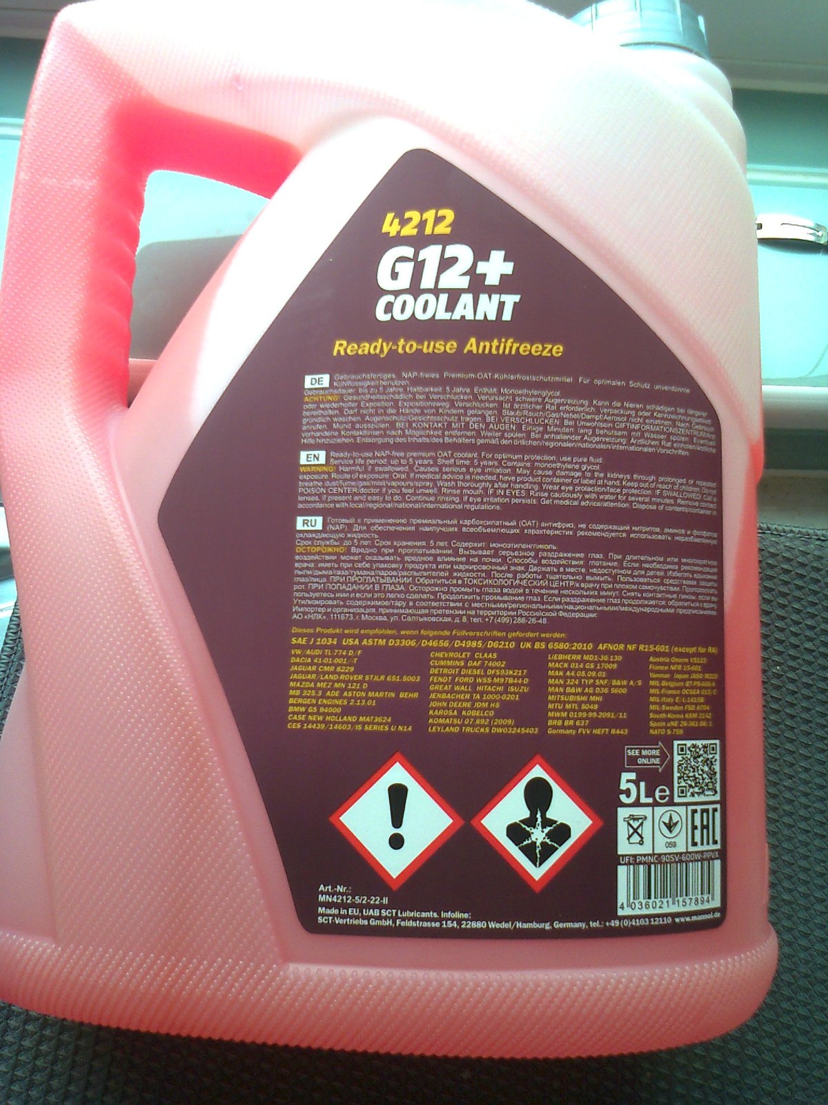

This week I bought some rather cheap Mannol G12+ Ready to Use Coolant (4212), from a trusted Ebay seller. It arrived in a Mannol branded box and the 5litre containers were sealed with foil. The first thing I did was to unseal one container and test it with a brand new refractometer (calibrated with de-ionised water). The result was only -9degsC !! (see photo). It may indicate excessive dilution ie fake. If it is not fake, I suggest Mannol are marketing a product unsuitable for a Europe climate.
Using the same refractometer, I also tested my C5's coolant (last replaced approx 10 years ago) at -27degsC, and I tested a friend's Clio at -29degsC. I also tested some Halfords ready to use winter screen wash at approx -30degsC (on the screen wash scales).
I have contacted both Mannol.uk and Mannol HQ in Germany, asking what the minimum temperature for G12+ 4212 should be. I await their responses.

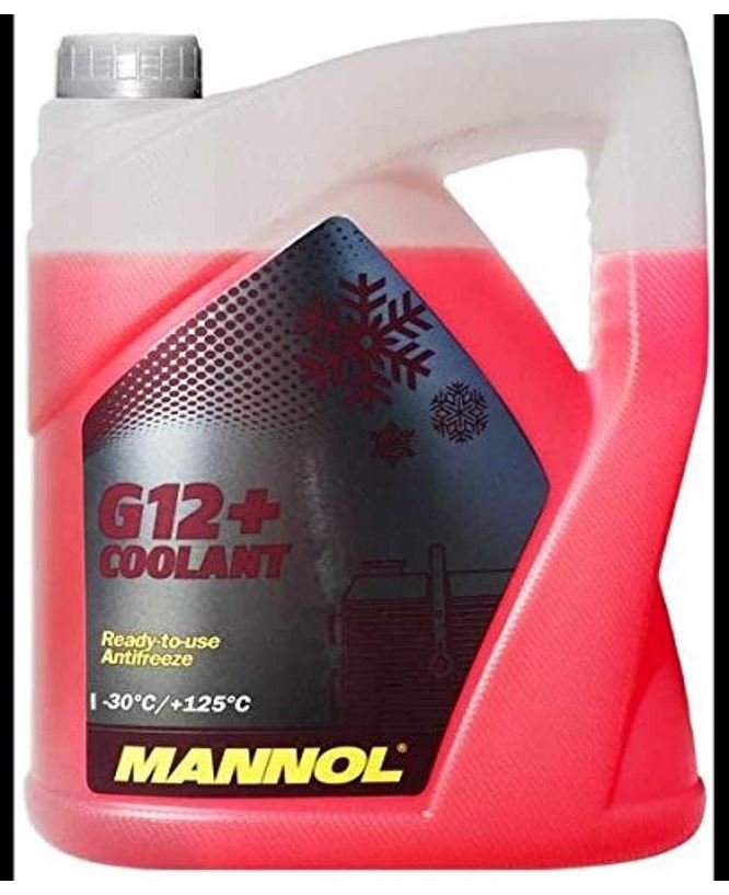

Here's possibly some older packaging that shows its temperature range from -30°C to +125°C

There's a QR code bottom right on the label marked "see more online" - if you follow that, is there any minimum temperature information on wherever that takes you?

I looked at your link to the Mannol G12+ currently on sale on Amazon. It is evident that the front and rear photos in that ad are not the same container!! The rear specifies "4212" (which is Mannol's current designation), but the front omits it. However, if G12+ was previously marketed as "-30degsC", then it would be reasonable to assume that the current product, with almost identical labelling should also be -30. I agree that no reputable company would market -9, hence I conclude it is counterfeit. I have not stated that as such to Mannol. If they are reputable they should react strongly.

Furthermore, they state that the G12+ item on Amazon (courtesy of Bobins - note the G12+ label says -30degsC, but does not give a part number) is part number MN4012 and is a different concentrated version. However, looking at the MANNOL.de website, MN4012 is designated "AF12+", not G12+. So they cannot even get their products straight.
