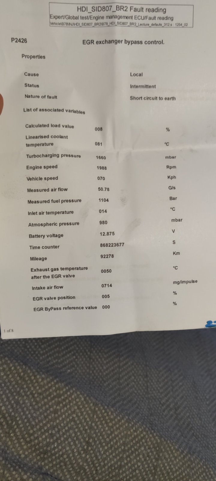

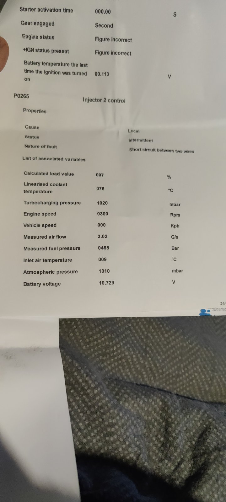

Towed home and next day took it to local garage who checked on the Lexia and was showing code P0265 Injector 2 Control - Intermittent - Short Circuit Between 2 Wires and P2426 EGR Exchanger Bypass Control - Short Circuit to Earth, P0003

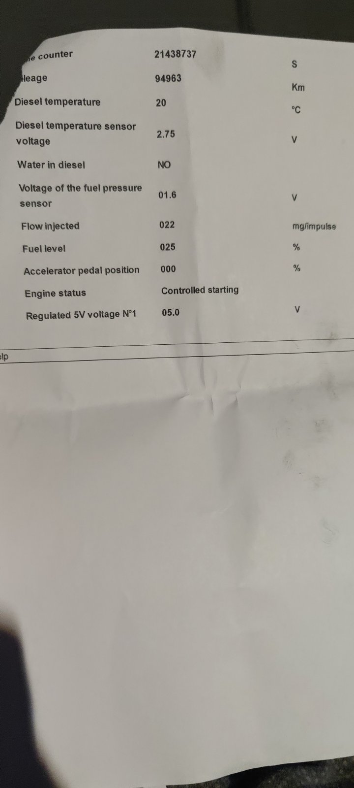

Attached are photos of fault codes. Some are cleared and only remaining are P0265 and ABS/EGR error dash.

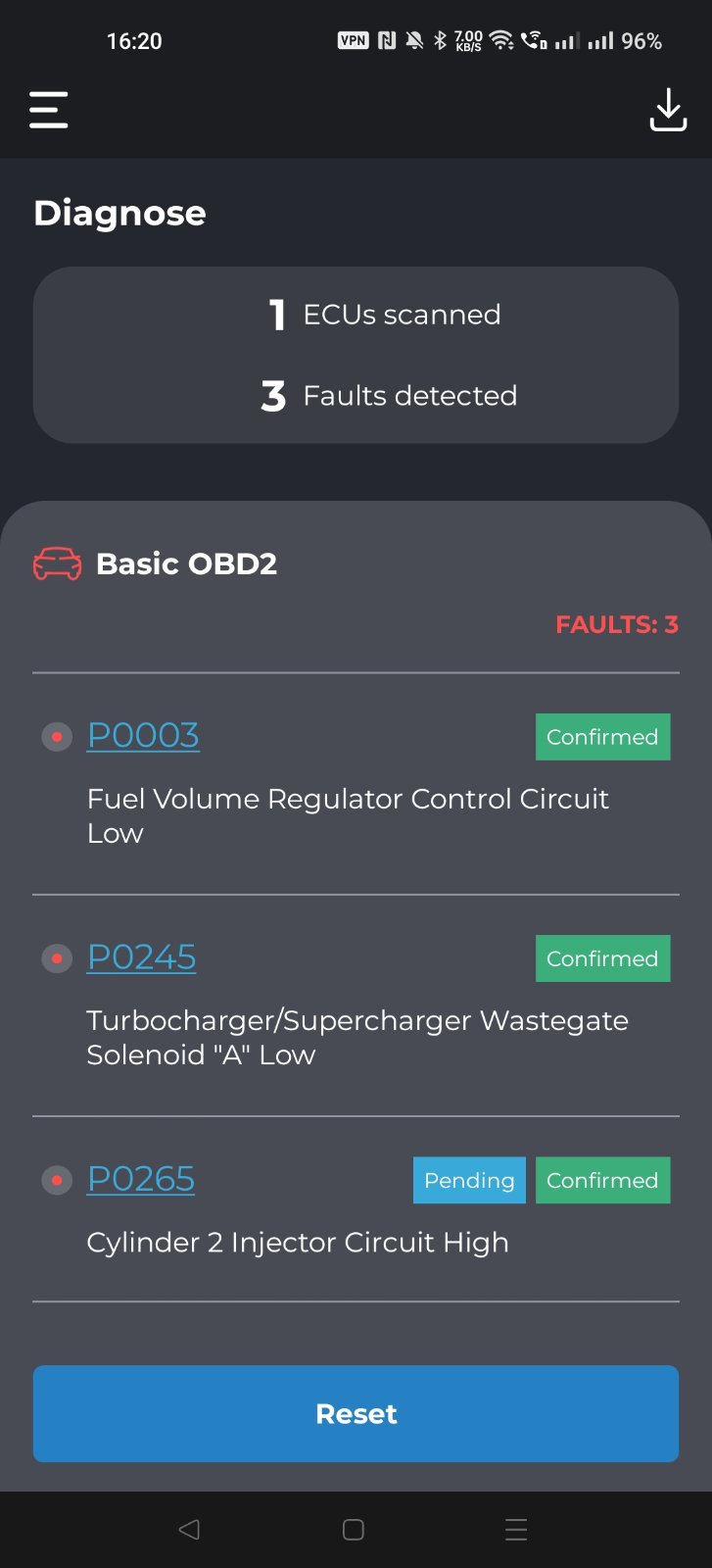

Hello, Have you been able to find a fix pls? im having the same problem

swap the suspect injector with one of the other ones & see if the fault changes to that injector position, if it does you know the injector is faulty

If you swap injectors, you will need to swap codes in ecu for it to run correctly
