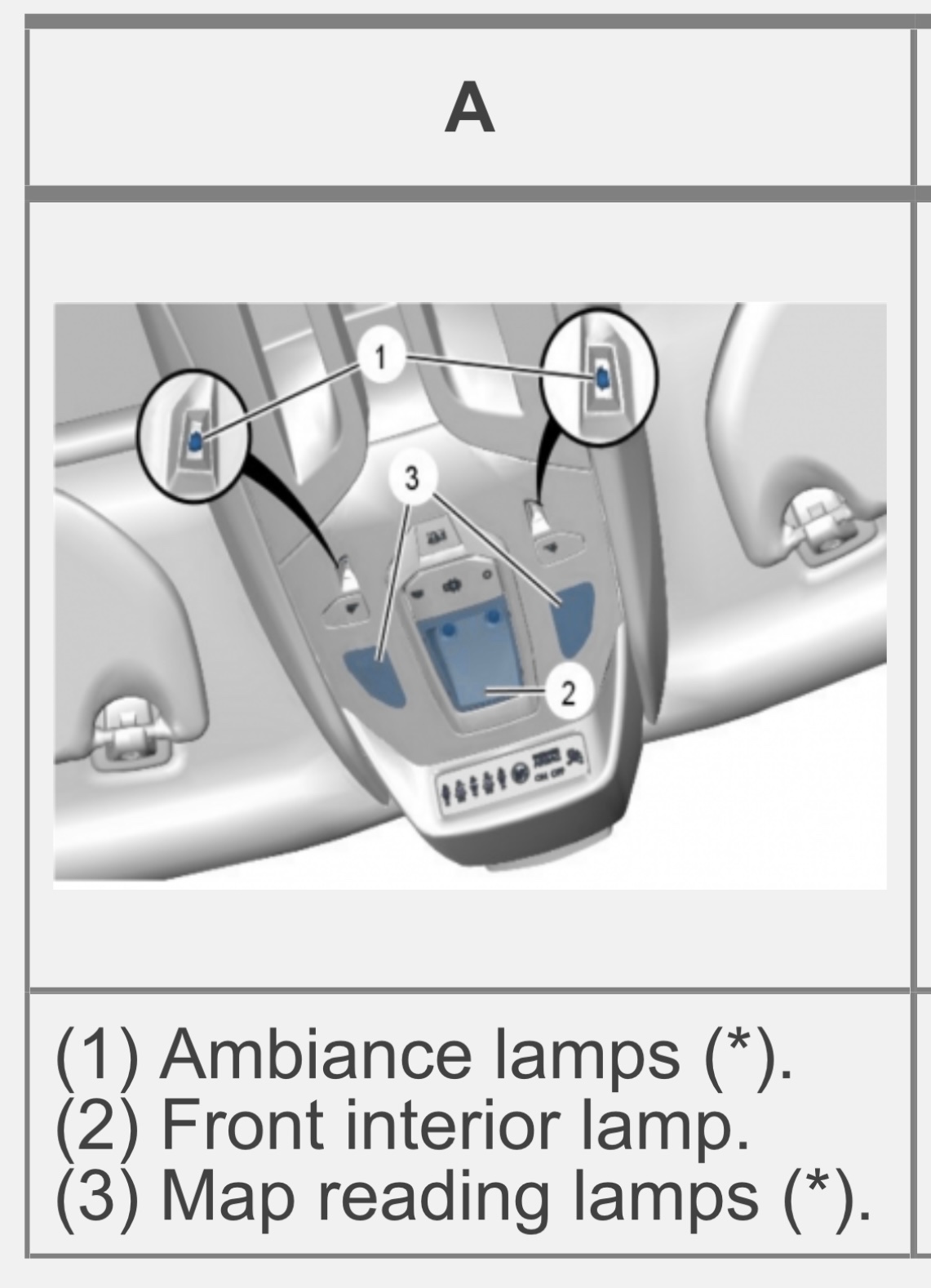

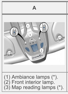

I have a 2012 Citroen DS5 (Diesel) and suddenly the Ambiance lamps, the map reading lamps and the sun visors lamps stopped working.
I have attached the picture of what lights I’m talking about.

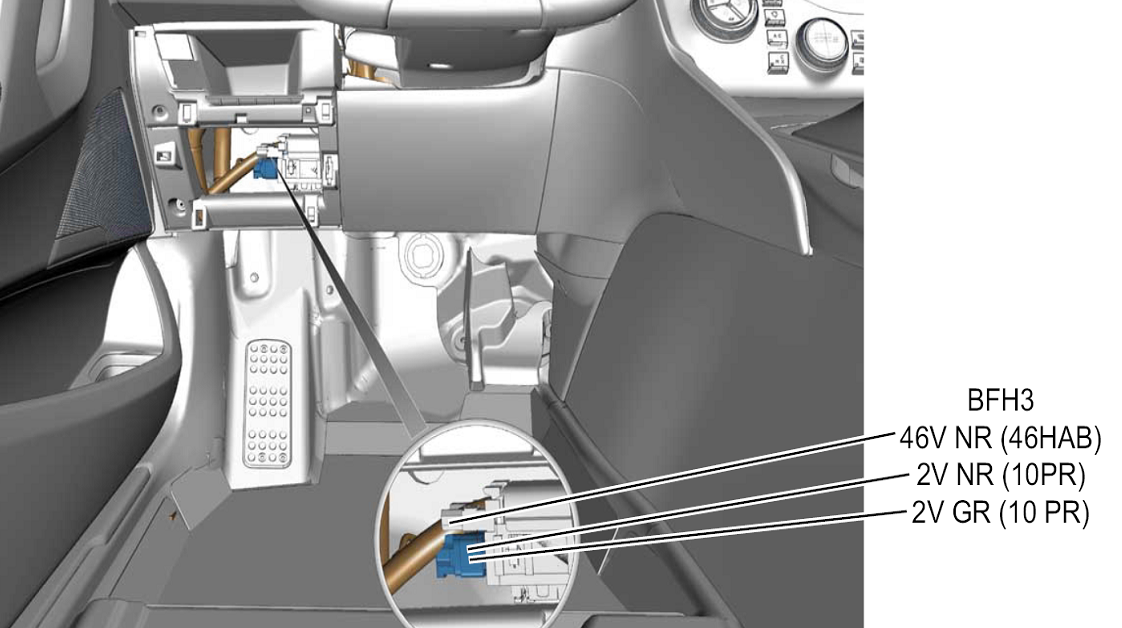

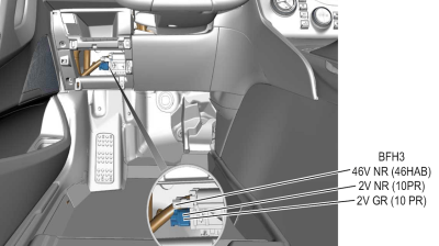

If only one heated seat is not working, then it won't be the fuse as the same fuse operates both driver and passenger heated seats.
If this is the case it is likely the heated seat pad(s) are faulty.
If none of the front seats are working then the fuse is F9 located in the BFH3 fusebox on the left hand side shown here:
