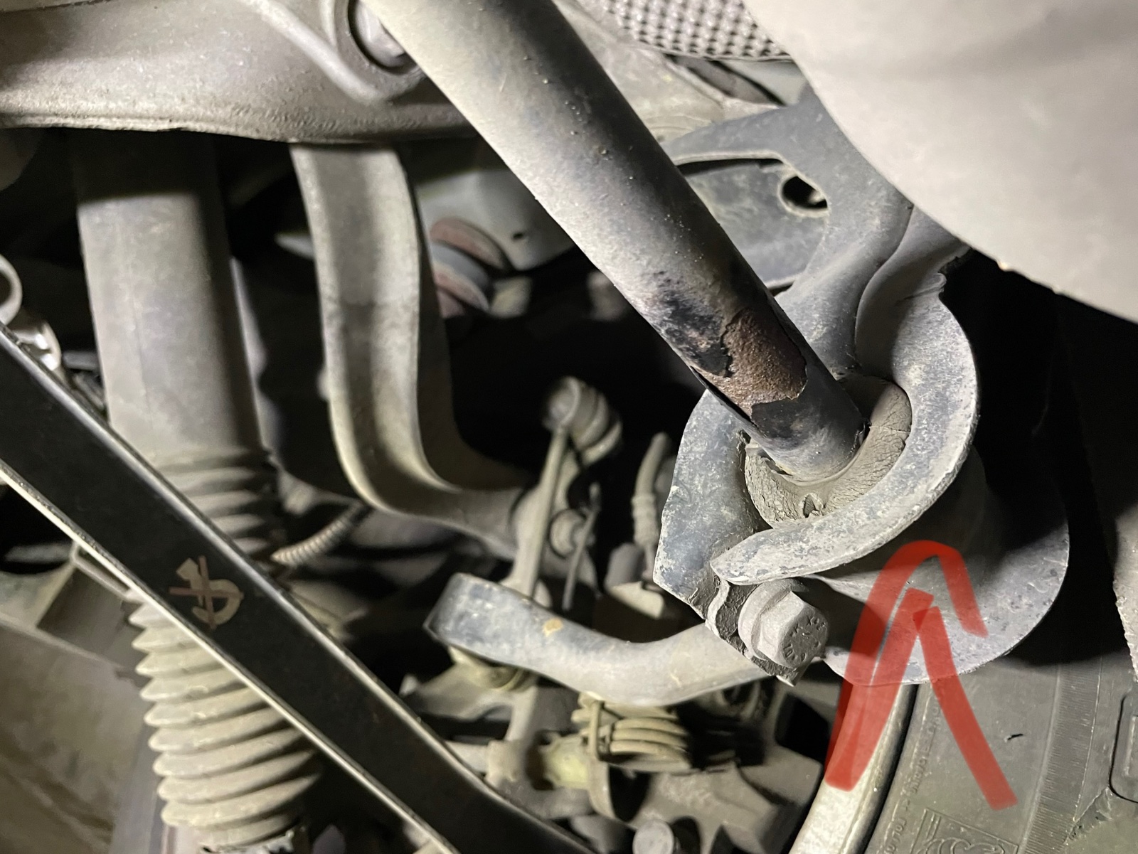

When inspecting the rear suspension on my C5, I saw that the anti roll bar bushes were quite perished.
Could someone give some advice, as I see that the whole unit is sold without the individual bushes.

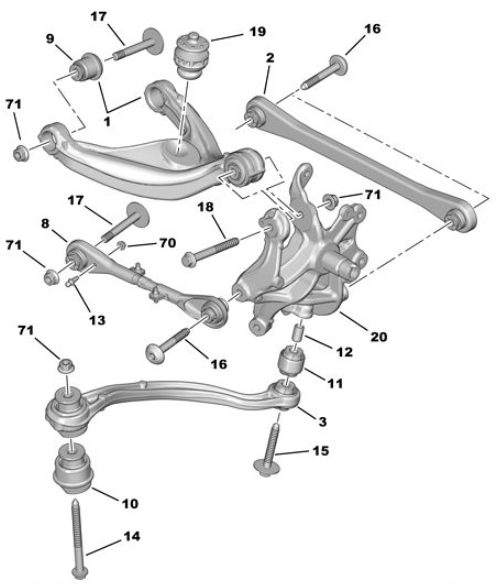

Have a look on this diagram and let me know if it any specific part. The rear suspension on the C5 X7 is a multi-link setup, so has many parts to it that can be replaced. Let me know if your require the part numbers for any of the items, quoting Diag 'A' or 'B' and then the item number.
Diag A - Rear Axle Here's the rear torsion bar Diagram too in case it's anything on either of the diagrams:
Diag B - Rear Torsion Bar
On the above (Diag B) The anti Roll Bar Rod item (4):
Original Citroen part: 9807130080, £70.15
Citroen Cheaper alternative, part: 1634904380, £13.16

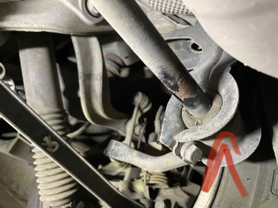

It’s from graph B, also I will attach a picture for reference.

Ok, so the bush itself as you know is not available from Citroen and there's no part number for it that I can provide you with.
The complete Anti Roll Bar is ridiculously expensive, part: 5170E7, £385.81 UK pricing.

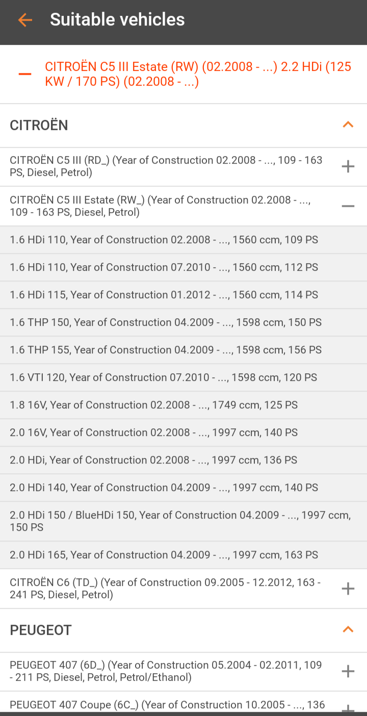

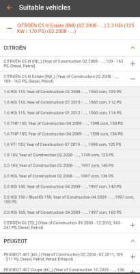

Did not realise no part number for anti roll bar bushes, how strange! Did exactly as advised as rubber on mine also looking quite tired. Interestingly, Autodoc doesn't think it'll fit my 2.2 HDi X7 (but does fit a multitude of other X7 and all C6 variants!) Doesn't also list the 2.7 or 3.0 HDi X7 either - did the bigger engine ones have a different diameter rear anti roll bar?GiveMeABreak wrote: 17 Jan 2023, 11:32 Yep, here you go:
https://www.onlinecarparts.co.uk/oenumber/5170e7.html
Autodoc are the same company and they have them too.
Just search "5170E7 Bushes" and you should be fine.
- x 6945
Re: C5 X7 Rear Anti Roll Bar Bushings
Yes Matt, the diameters are different depending on engine and model (20, 20.5, 21, 21.5) etc.
The above ARB part number (5170E7) is for the specific ARB on the OPs vehicle, so the bushes must be for this part.
Having looked at your VIN for your 2.2 (175) it is the same ARB even though the OP has a 2.2 DW12C engine. So the same ones I linked to - just order those.
https://www.google.com/search?q=%225170 ... s-wiz-serp
Make sure they specify for ARB part number 5170E7.

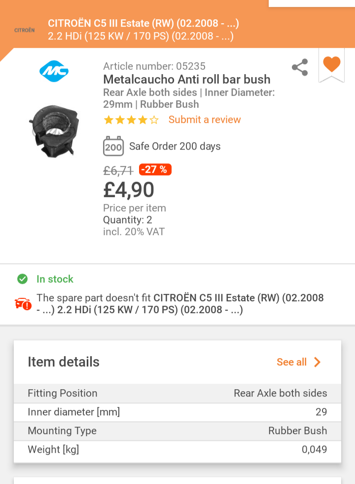

Thanks Marc, I did search for 5170E7 (on the Autodoc app it initially also filters by your entered car details - gave no results, so expanded to "search for parts fitting other vehicles" and a couple came up. Those are the cheaper ones (others only £8-odd) both said 29mm and both said doesn't fit my 2.2GiveMeABreak wrote: 17 Jan 2023, 21:20 Yes Matt, the diameters are different depending on engine and model (20, 20.5, 21, 21.5) etc.
