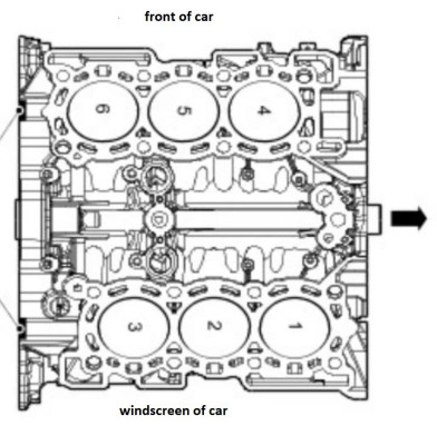

Below is what I have deduced using data off Landrover forum re the 2.7 TDV6 engine (uses the same 2.7 block) (turned to the right for the Pug traverse mounting)

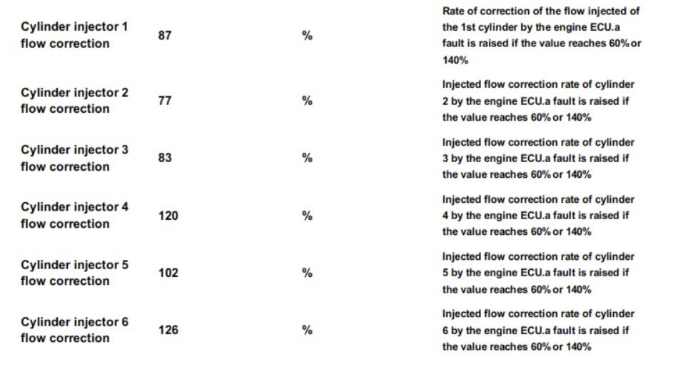

This is to id two injectors that Diag is reporting as overfueling (with resulting smoke etc)

Numbering of the cylinders 1 to 3 starting at the back part of the engine starting at the right (when in the car, driver side for UK cars) and 4 to 6 for the front cylinders with 4 directly opposite 1.
Injector numbers are based on the firing order 1 4 2 5 3 6 and not the cylinder numbers.
That is injector 1 is cylinder 1, injector 2 is cylinder 4, injector 3 is cylinder 2, injector 4 is cylinder 5, injector 5 is cylinder 3, injector 6 is cylinder 6.

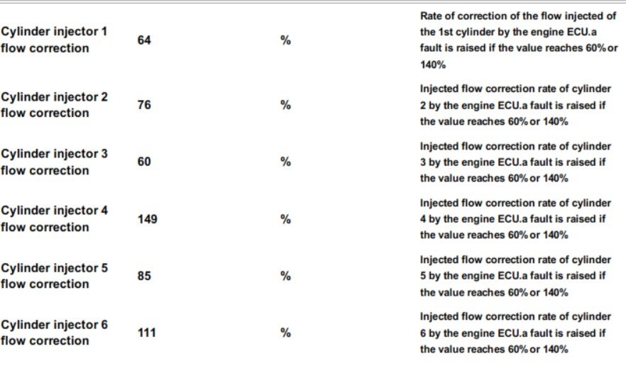

I assume there is no way to adjust the flow rate of injectors via Diag given I have two that are now reading way out of the others (4 and 6)

I swapped one out of the injectors (injector 6 with a spare I had) and swapped then swapped injector 2 and 6 and the smoking problem seemed to go away and the flow correction data seems to be a bit more reasonable.

Correct, the injection sequence of the DT17 engine is (1, 4, 2, 5, 3, 6).

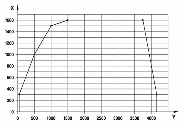

I only have the actual Injection Pressure as follows:
Key
X: Injection pressure ( bar)
Y: Engine speed (rpm)
Key

so the chart suggests at 2112 rpm I should have 1600 bar (23,206 psi) whereas Diag is saying I get to only 486 bar (7081 psi) yet the car feels like it is running okay.
I guess my readings are when stationary so I might try and get some when at speed.

I think you've got it upside down.... I would read the injector flow correction as what the ECU is having to do to smooth out the running; i.e. a low figure means that the injector is overfuelling so the ECU is cutting back the duration time to keep the volume down, and vice-versa.
