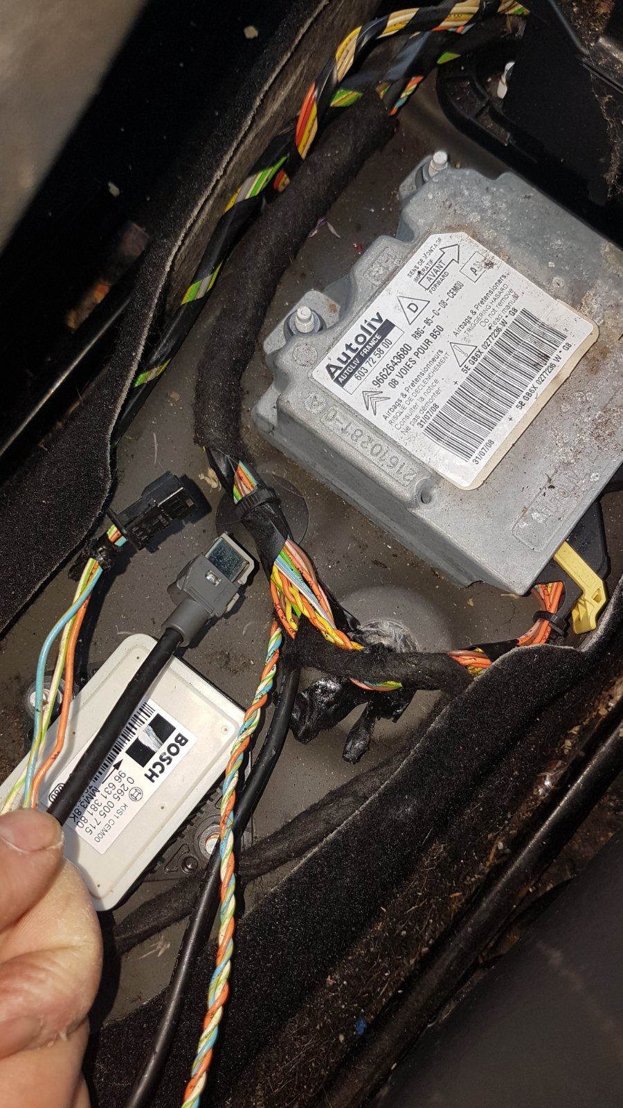

Hello.
Can someone tell me what these are & if i should be worried that they're not connected to anything 🤔
2 cables found under centre console near aouto gear knob, don't know where other ends are they seem to disappear of into the harness somewhere
(2008 c4 coupe 1.6 hdi vtr+)

This is where they join into harness & seem to carry on & go up back of heater control/stereo

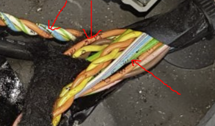

Re: C4 coupe cables under centre console ???
I can't help with the large one, but if you look at the thinner wires, the code numbers are easily visible for example where I have arrowed in red in your picture - just look for similar on the ones you are holding. Unfortunately the wiring colours are useless as PSA don't go by the wire colour (they use anything going) only the code.

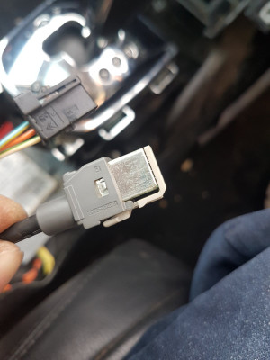

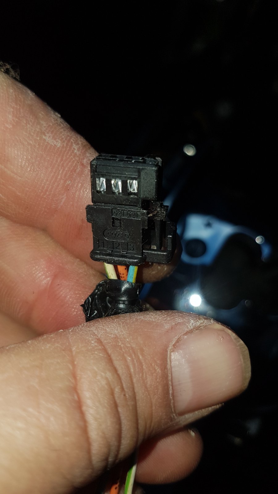

Do you have a pic of the pins of the connector face on? looks like the wiring is in a sheath/flex so you wont likely get any meaningful codes off it. I agree it looks like some sort of Aux/ USB lead but cant recall there ever being anything like that at the centre console on that age of C4. Could it be aftermarket? do you still have the original stereo?

No pics face on only from side
Can take some next time I take out centre console & post on here if it helps
