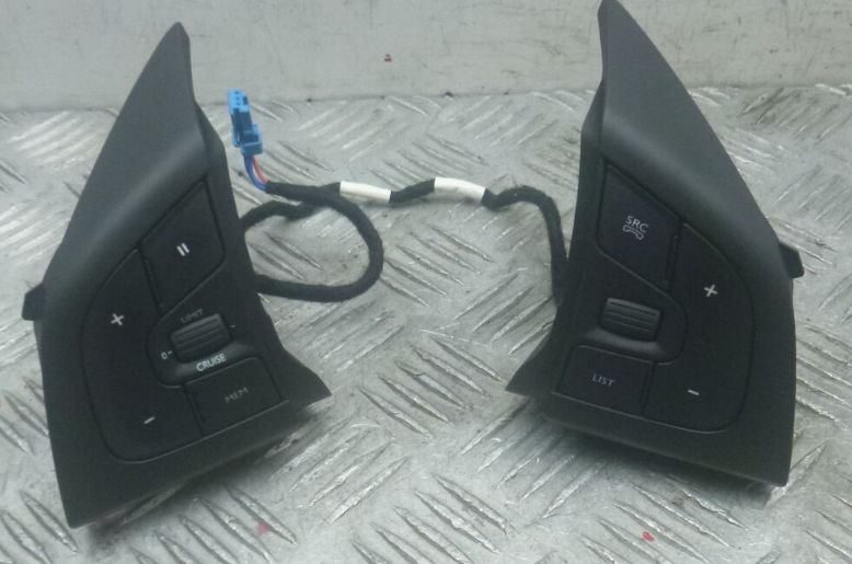

The other possibility is of course the control switch bank in the left of the steering wheel used to set, suspend and resume cruise. If you use it as often as you say, it may well be starting to wear or causing the odd behaviour.
See what happens when you undertake some live actuation tests with Diagbox. There should be a test you can select from the parameters to test the button pushes. Then watch to see if it registers another push without you doing anything.

My CC switch is worn that badly I can't even set it. doesnt matter if it's warm.
The limiter works so I use this, but noticed this has started going off.
Does anyone know if it's possible to repair, or is it a case of swapping the components?

Ok, so on the DS5, there are no stalk type cruise controls, they are integrated into the left and right sides of the steering wheel.
So these are available from Citroen / DS. If you need the part number, please see below:

Thanks Marc, I actually discovered last night that if I wedge something like a credit card between the speed control unit and the steering wheel at the bottom, my cruise control stays on. I'm going to make something more permenant and see how I get on.
I was trying to see if I could remove the unit all together to inspect it, but couldnt get it off. Does anyone have a guide?

I have the same problem. It randomly cancels when i hit a small bump on road so I think it is related to some physical contact inside. When i push the whole left bank inwards it tends to work for some time.
To replace it de we need to remove the airbag?
