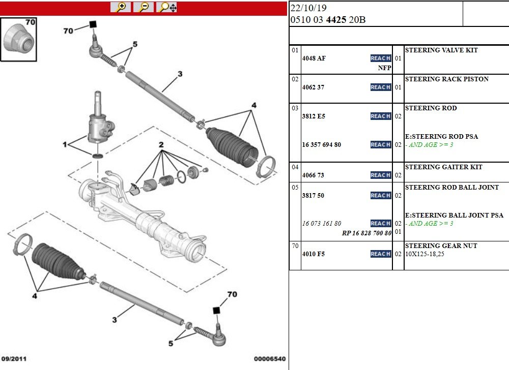

This is not specifically for your car, just a random 2008 C4. It doesn't list the inner tie rods separate, only the actual main tie rod so not available from Citroen however that doesn't mean you cant get them aftermarket.
Best to speak to someone that recons steering racks.

Thanks, found inner tie rods, £20 for a pair. Watched a few vids and looks like it's a replaceable component on the C4. Will find another garage and ask if they can tell me specially if the play is from the inner rod.wheeler wrote: 04 Jan 2023, 10:53 This is not specifically for your car, just a random 2008 C4. It doesn't list the inner tie rods separate, only the actual main tie rod so not available from Citroen however that doesn't mean you cant get them aftermarket.
