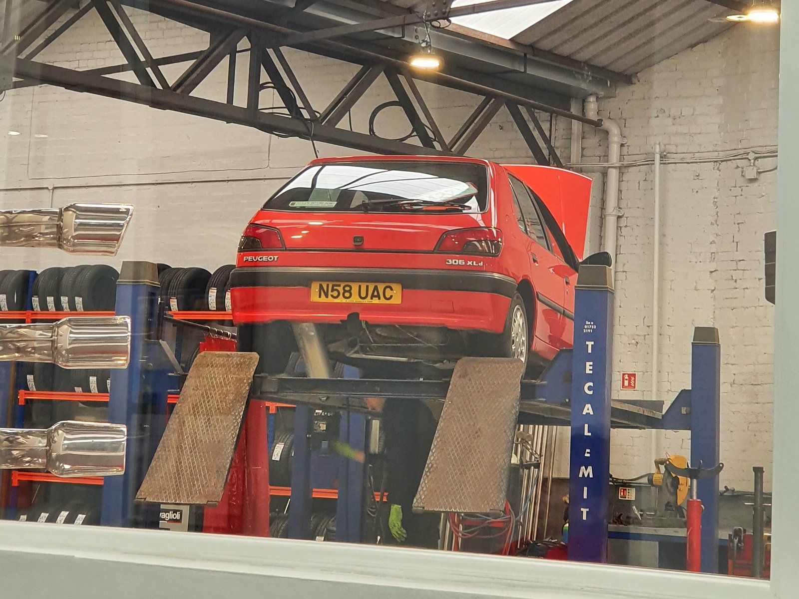

On the ramp at Mr Tyre in Nottingham having some attention to the exhaust issue
Booked it in for an MOT at the only location which had slots available the same day locally. Somewhere I hadn't used before, but they are a chain... not naming names for now! I left it with them and headed to work.

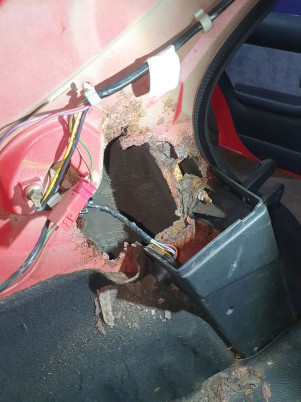

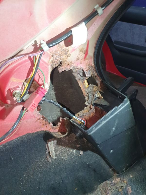

An hour or so later, my car world briefly fell and shattered. I got the phone call... "So, it's failed. Badly."
Being rather surprised at this sudden event I hurriedly went down to see what the fuss was about, as I couldn't believe they were serious. But sure enough, you could see the inertia reel of the seatbelt through the wheel arch when you knelt down and looked up with a torch. Absolutely shocking that the previous MOT tester (before I owned the car) would have overlooked this. I paid for the test and took the car away to where I work (a garage, but we do buses). When I finished that evening, I had a look underneath and realised we had gone from one extreme to another. The first test station must have had blacked out goggles on when inspecting, and the second test station seemed to have gone overboard and seen pound signs flashing. An absolute joke of a list of advisories and several fail items that were totally unjust.
Definitely a reason for failure here though! After I had stripped the interior trim. Could clearly see the hole from underneath though.
I went on holiday for a week and pondered. I decided the best course of action was to get it repaired. I was not going to be defeated so easily, but at the same time I have too much other work on to do the job myself. I contacted a local independent workshop who took it in, agreed a plan of attack for the wheel arch then said their tester (off site) would give it a fresh MOT none the wiser about its previous failures and we can carry on from there. After the arch was repaired, she had another test and amazingly the list had gone from 9 failures and 15(!) advisories, down to 3 failures and 0 advisories! We agreed to fabricate a new section for where the bump stop is supposed to sit on the NSR as that area was totally non existent, and they set to work also on repairing the front jacking points which the previous owners' wonderful* repair and MOT centre had repaired with plates, wood screws and tiger seal.
A lot of time and money later, and she has passed with no advisories, and hopefully this will be the case next time around too. Absolutely loved driving it so far, it is dog slow and has few creature comforts but it is absolutely solid 90s motoring.

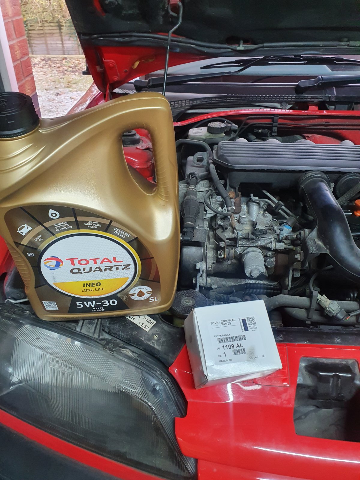

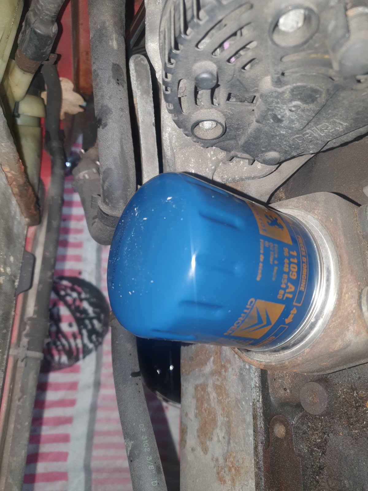

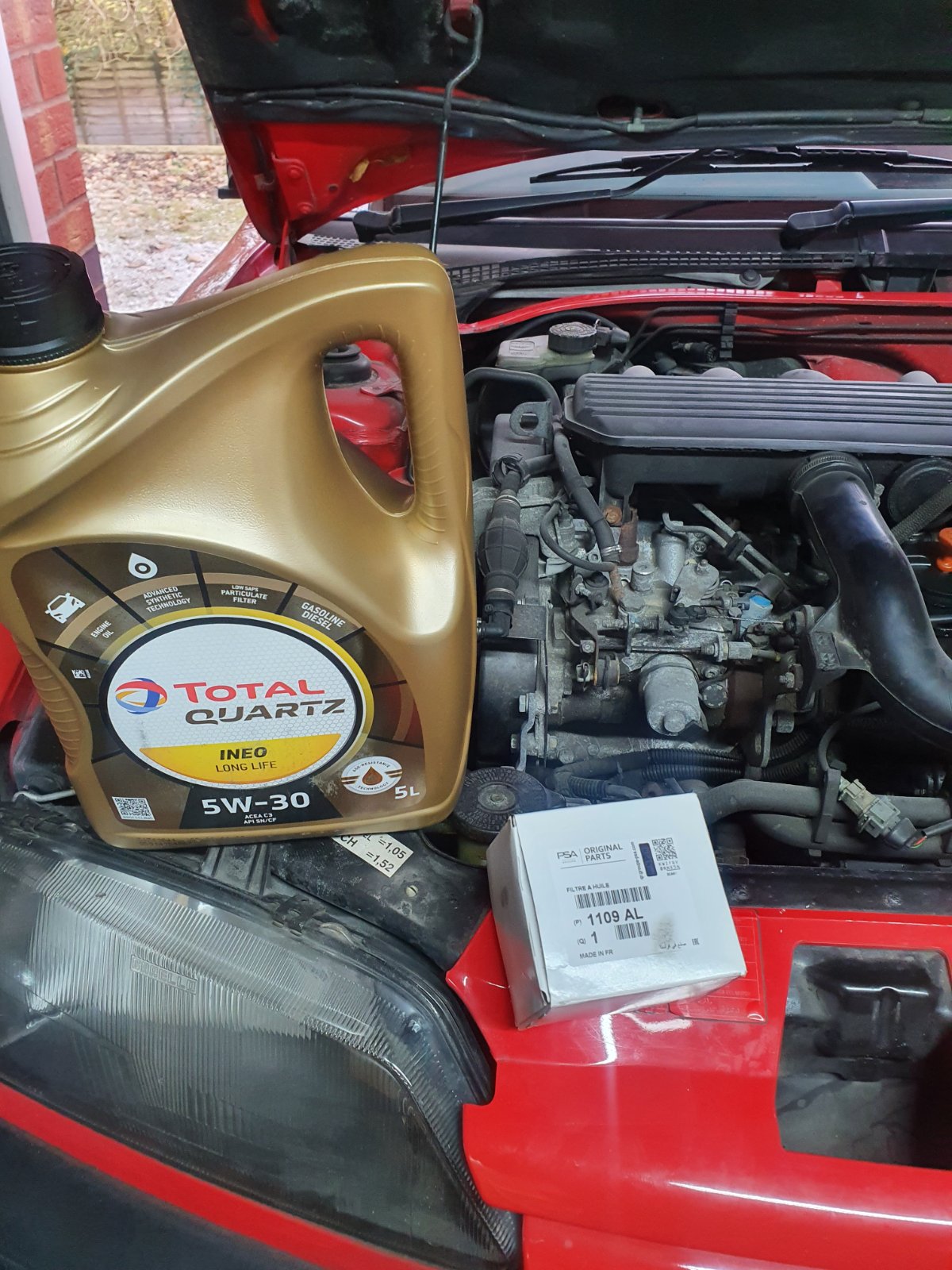

Wasted no time in doing an oil change, as unfortunately I have no service history. Easiest oil change I have ever done though, very very easy filter to change! Genuine PSA filter and Total Quartz now onboard.

Is 5W30 a bit thin? Am sure my XUD9TE was on thicker 10W40 semi synthetic.

I was also surprised at 5W30, however that was what Total Lubfinder recommended, I'll see how it gets on with it, some engines in certain cars really spit their dummies out with a change in oil type, hopefully not the case here.

I always used 10W-40 in all of mine, summer and winter... Still do... Only Robyn's erstwhile C1 demanded something thinner...

Agree, 10W40 was my go to on a XUD. Modern stuff tends to be thinner (tighter tolerances and a view towards slightly efficiency improvement with thinner stuff. Think I've read some if the hybrids (aiming for higher efficiency again) use really thin stuff, 0W20??

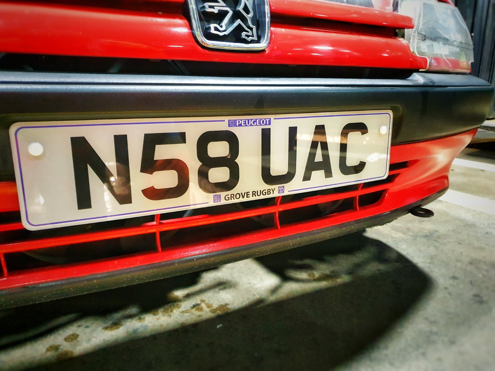

It's been a bit quiet the last few weeks, but I have been busy with work and I've had more bits to do with my Saab that had to take precedence at the present time.

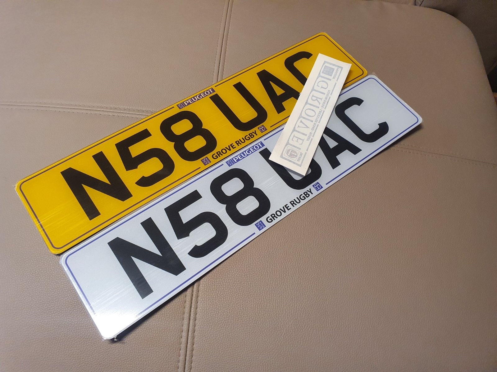

In the background however, I've ordered a few bits to keep me occupied, such as a pair of TRW rear shock absorbers to replace the crusty flaky ones it currently has, and some replica dealer numberplates, as I intend to bring it back to what it would have looked like in 1995 when new.

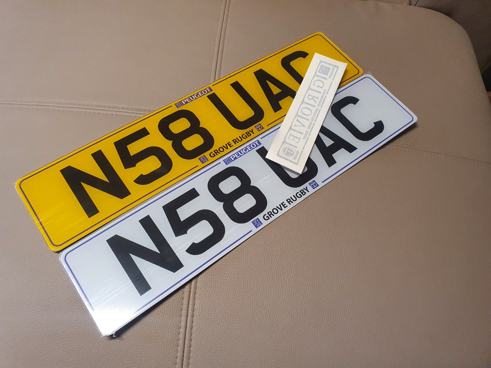

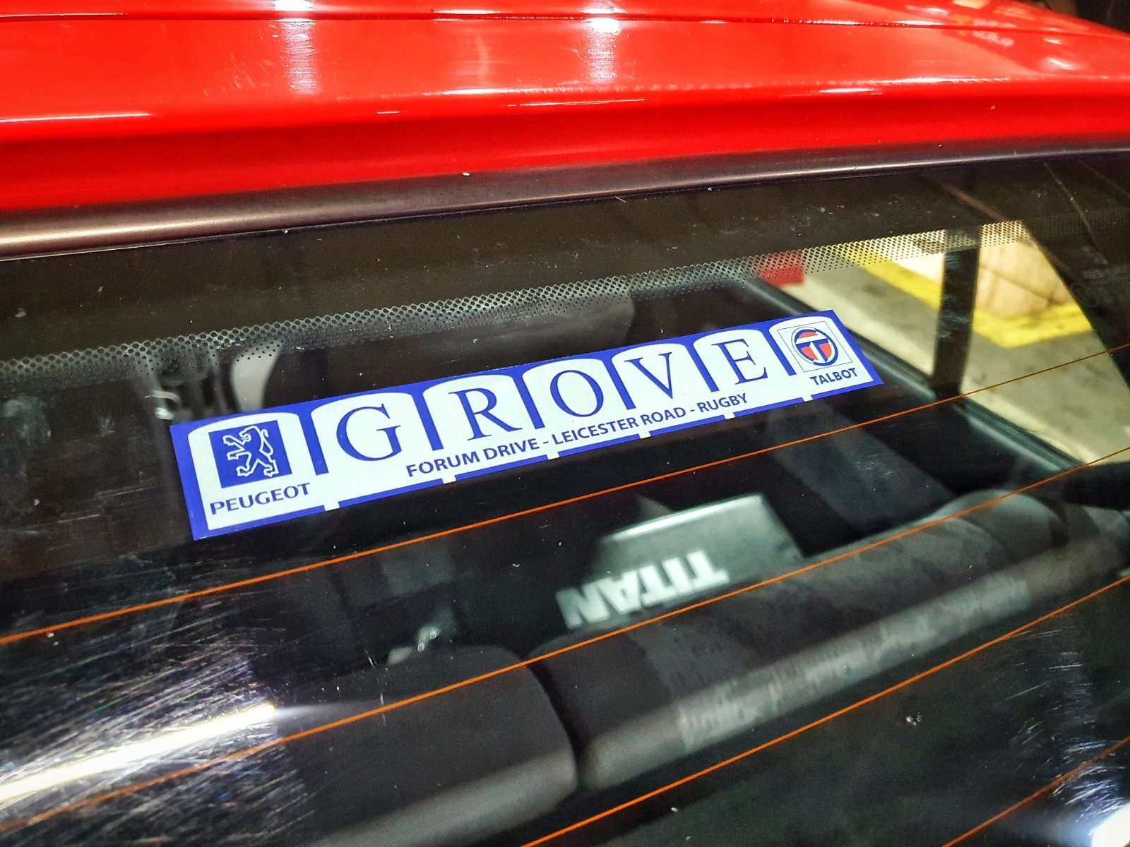

A pair of replica dealer plates, and matching window decal, from what I suspect may have been the original dealer. I haven't researched that deep, however this is close enough for me for now. The car was registered in Coventry, ironically in the same locality to where it was born.

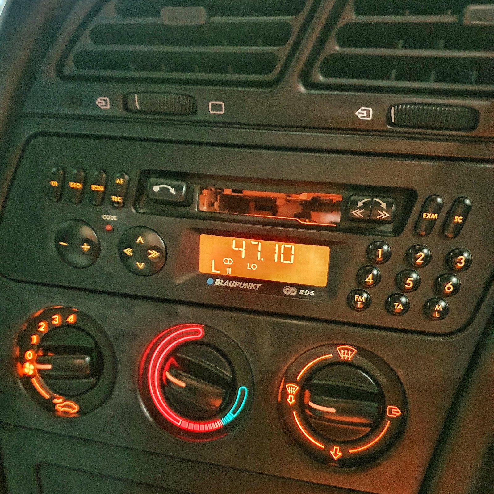

Original Blaupunkt head unit is still in place for now, but it is temperamental and half of the display is knackered as you can see - tuned in to 47.10 FM. Apparently...

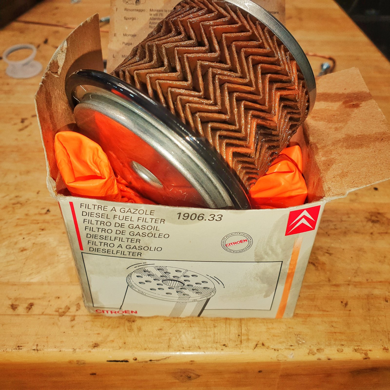

Old fuel filter looked a bit dark, no idea when it was last changed.
Big thanks must go to Pro Plates for supplying the replica numberplates and dealer transfer at a very reasonable cost.
That's all for now - in the new year I need to do some more involved work, including the rear axle which is incredibly crusty. New rear shocks, new brakes, and a more in-depth clean of the underside and application of underseal to try and keep the tin worm at bay for a while longer.
Had several bits to keep me busy today. Fitted a new set of speakers to replace the knackered factory ones, air filter change, fuel filter, new plates and new wipers.
Fitted four new Alpine 6½" speakers which have a similar rating to the factory ones, and it has made a world of difference to be able to listen to decent audio while driving. Next step is a replacement head unit, which I haven't yet chosen. Likely to go for one of the nice looking Continental branded 'retro look' modern head units - so I can enjoy the modern convenience of things like Bluetooth without having to resort to a silly colour changing naff JVC that would ruin the look.
Air filter, unsurprisingly, was toast - nicely full of dead flies, spiders, dust and general crap. New one fitted, and just as important is a new fuel filter. Opted for a genuine one which actually looks rather different to the old one that was fitted which looks like a Purflux. The genuine ones appear to be made by Delphi. Half the reason for changing the fuel filter was the water in fuel light has been on and off intermittently for some time. Stayed off all the way home, so fingers crossed that's sorted that!
