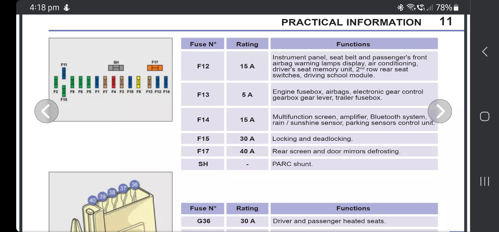

I thought that would be best too. It's strange though because my Bluetooth isn't working this morning. Reading the manual it has the same fuse (F14 - 15A) as the parking sensors so I assume it's the same system?

I doubt it will be any of the fuses. The Parking assistance is pretty reliable and if it was dead it wouldn't beep and throw a wobbly in reverse. So I still think you have one or more faulty sensors.
F14 is for the Hands Free kit which you don't have - you have the RD45 which has Bluetooth built in so does not need the Hands Free kit.

Much appreciated, it do beep once when reverse is selected and then flashes up on the little screen that there's a fault.GiveMeABreak wrote: 07 Dec 2022, 12:55 I doubt it will be any of the fuses. The Parking assistance is pretty reliable and if it was dead it wouldn't beep and throw a wobbly in reverse. So I still think you have one or more faulty sensors.
F14 is for the Hands Free kit which you don't have - you have the RD45 which has Bluetooth built in so does not need the Hands Free kit.![]()
Aye I just thought because of the way the handbook lays out the fuses that the parking assist and Bluetooth was under the same fuse that it could be linked together why both have failed
- x 6961
Re: 308 SW 2012 - Rear parking Assistant faulty & eco engine stop not working
Yes, the manuals are generic and have to cover all trim and equipment levels, so not everything is relevant to all vehicles.
