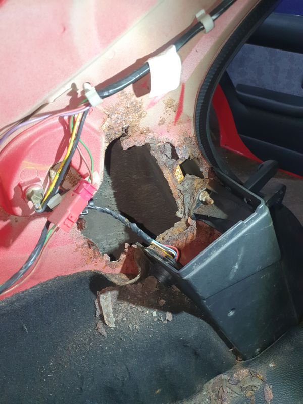

No doubt this issue has raised its head in the past but I am struggling to find much apart from similar stories to mine.
I recently saved a very tidy looking 1995 Peugeot 306 XLd from a scrap yard which was given to them by an old gent who was giving up driving, and it had recently failed an MOT, but only on an exhaust leak.
I since found out that the place that did the MOT must employ Stevie Wonder as a tester, as there were a couple of areas of serious corrosion that they failed to spot. One of these was the dreaded nearside rear seatbelt anchor which was completely detached and the reel was hanging freely inside the arch. Currently weighing up my options for what action to take with the MOT centre but that's another story.
Anyway, I am confident enough with a welder to carry out a repair, however as the rot is so advanced in that specific area, constructing a suitable shaped repair section with steel sheet is quite a complex task. Is there anywhere that has created a suitable shaped repair panel that can be grafted in to place? I usually work on buses where we make anything like this in-house, normally out of rather simple shapes.
On the whole it is a surprisingly tidy car, where the previous owner unfortunately gave too much attention to the very clean visible parts and didn't pay enough attention to some other bits. And I think they need to find a different garage!

I'm shocked the MoT tester failed to spot the extent of the rot! They clearly did not test the seat belts...
It's such a shame these cars are starting to rot so badly as they are otherwise a brilliant car... Possibly one of the best Pugs ever...
Definitely worth saving. I've seen a few YouTube videos (via Facebook) detailing quite extensive repairs in this area so a good old search of the 'Tube may help...
As for repair panels, I'm wondering if there's any French or other EU-based Peugeot specialists producing them? The problem won't be unique to the UK and it was an incredibly popular car everywhere...
All good luck with this and please do keep us informed of progress...

Shouldn't be a story up for dithering. That was a safety critical issue. Just put your loved ones in that situation when something goes wrong. You can't wind back the clock after a serious event. Sorry, no brainer!!!!

Some scary images here:

Speaking of scary images...!
This is the car in question.
Bearing in mind of course that there is no arch liner on that side so when you shone a torch up there from outside you could see the seatbelt inertia reel and its bolt hanging there freely! And when doing a proper seatbelt check of course you could hear and feel it was loose. Hopefully the previous owner didn't ever carry anyone there, in a front end collision you may as well not have had a belt on.

Given that it's not uncommon, you'd have thought all MoT testers would have been well aware...
There must be quite a mud trap up there to cause such a devastating amount of serious corrosion... Is it generally localised and does it only affect one or both sides?
Going by where the Saxo loves to rust, this is not unique to the 306 family...

Wow that's bad
Not so many 306s around anymore. Unless you're going to a Pug specialist they probably won't be aware of the places that need extra attention.CitroJim wrote: 17 Nov 2022, 17:32 Given that it's not uncommon, you'd have thought all MoT testers would have been well aware...
More of the same from a French forum, by the way:
https://www.306inside.com/forum/viewtop ... c&start=60
And that guy's rust is nothing like this...

Someone's fix of this area with repairs made piecemeal and very functional welding:
https://www.fiatforum.com/threads/john- ... 629/page-2
I've a 306 I (am overly attached to having covered 100,000 miles in it and so feel that I) need to fix - fairly significant big holes in both inner wings and another in the bulkhead. Going to have to check this area very closely too!

A quick update on this (as promised)...
It's being repaired!
Nominated a local workshop to undertake the work, as although I can MIG weld, this is an extremely complex job and as for the underside jobs I simply am not set up for doing welding with the car overhead.
Wheel arch is pretty much done, just the other areas such as the inner sill to continue with next week. The rear shock absorbers look absolutely awful but didn't fail the MOT as they weren't leaking and are still just about damping as they should, but I have ordered a pair of TRW replacements to compliment the rest of the work being done.
It had been parked up for a couple of weeks under a tree, and as soon as I got back in to it to take it the short journey to the workshop I immediately got the feeling back of wanting to drive it. Might even daily it for a bit when it is ready... fear not little Peugeot, it's not your time to die just yet!
