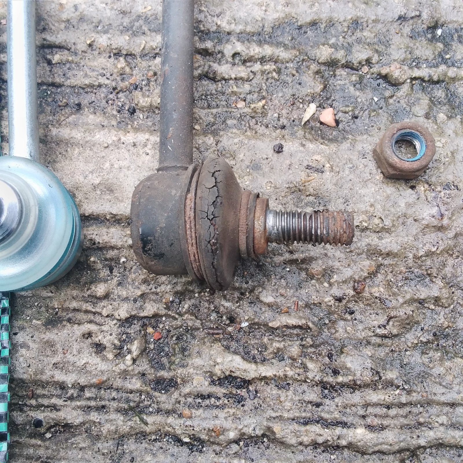

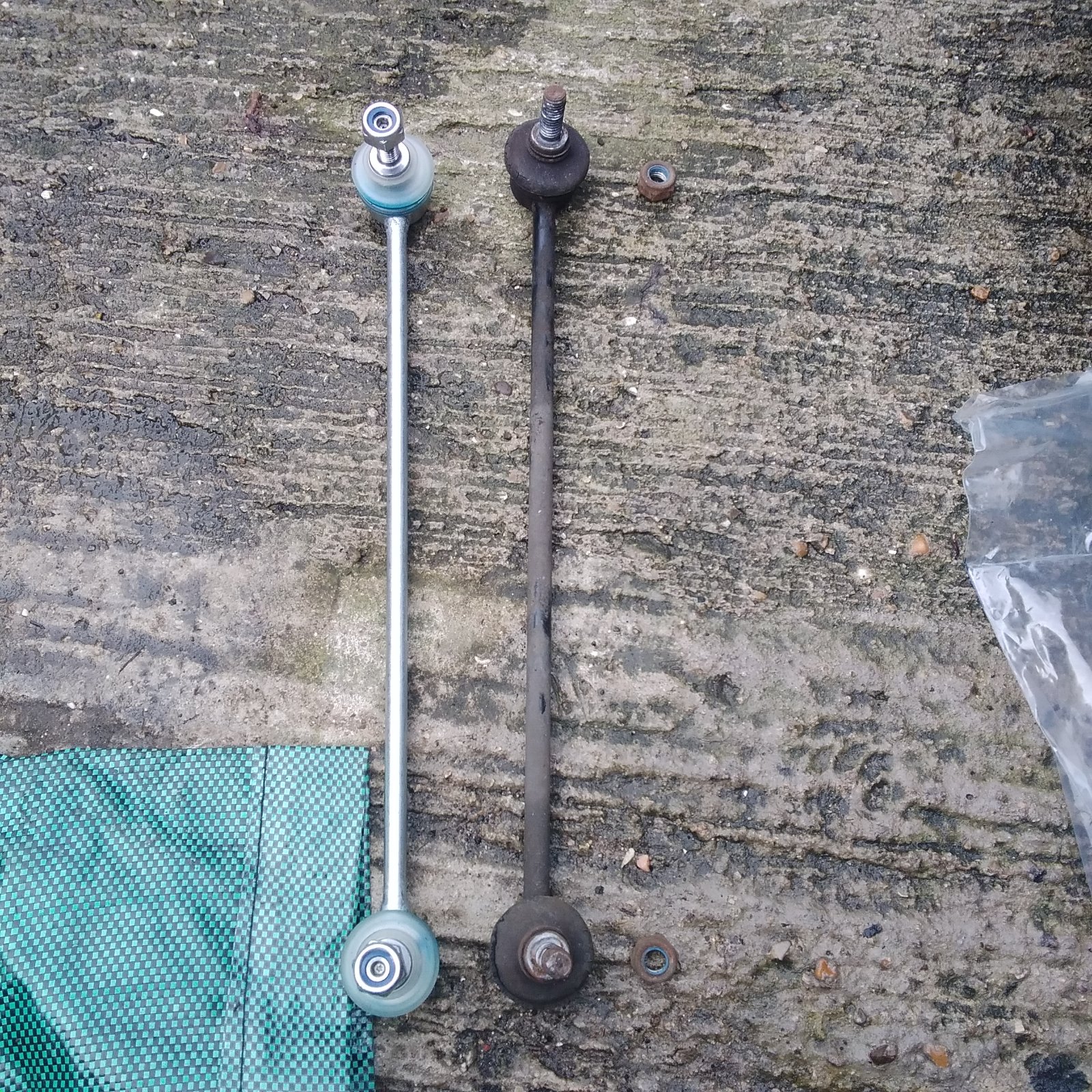

So today the 206cc had 2 new drop links fitted.
The new are the chrome coloured ones
The black are 17 months old.

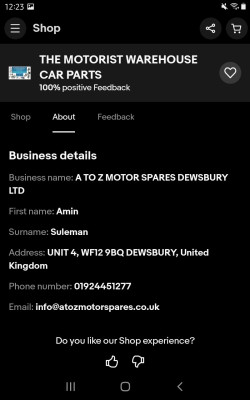

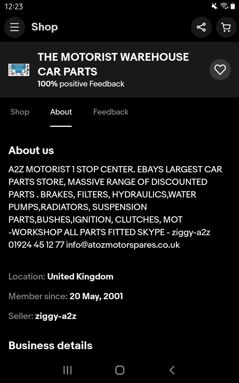

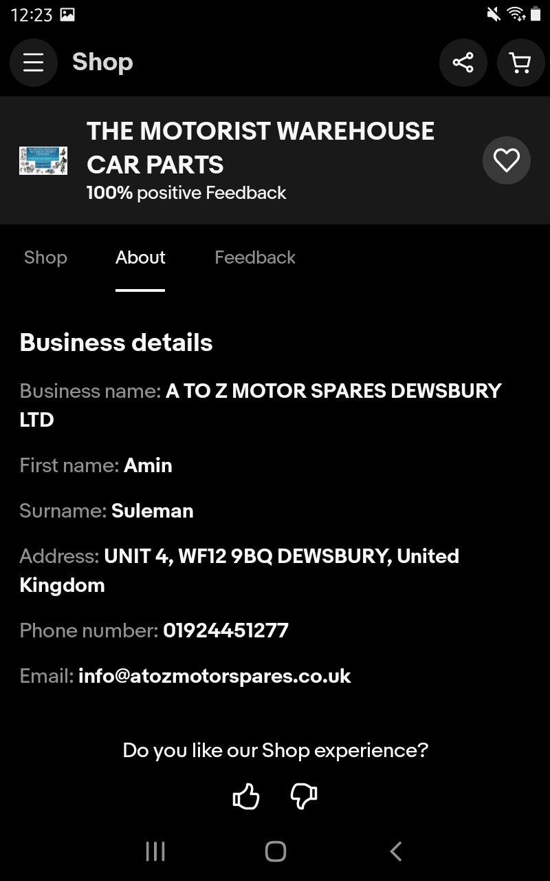

Also screen shot of ebay seller best to avoid.

The new ones are top quality didn't want to go cheap again isn't worth it, mot soon , would of been miffed if it failed on the drop links.

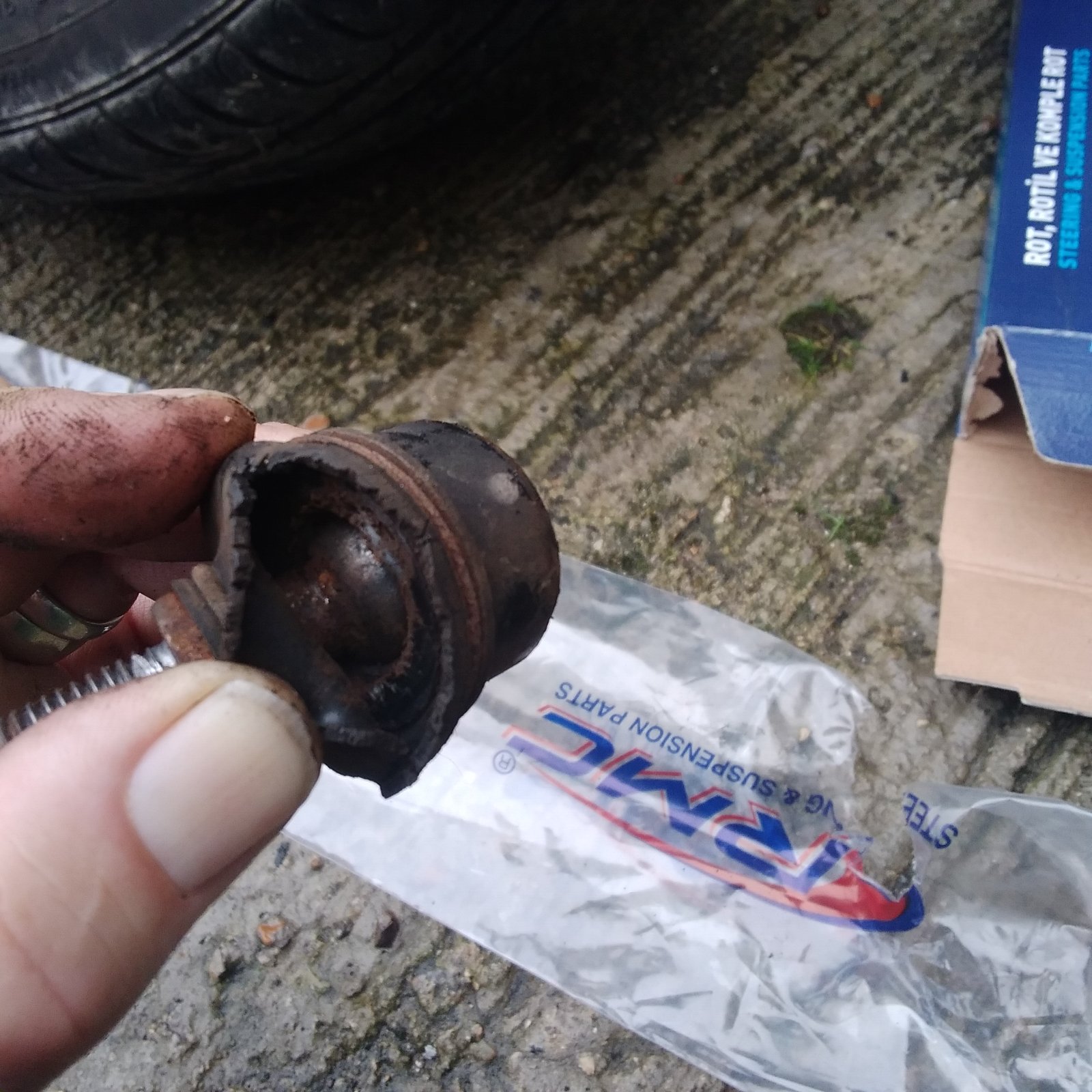

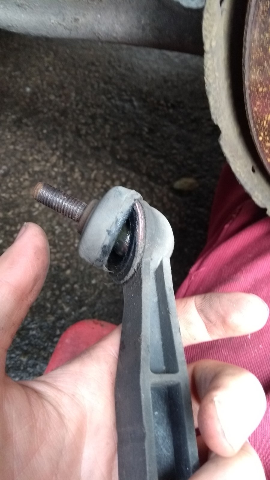

406 rear drop link, failed in short order (and lower fixing is blooming awkward to get to!)

406 rear ones plastic like the vauxhall astra g front ones , they go the very same way., i did email the seller but was ignored hence why i put a screen shot of the ebay seller, think they need a name changed to we sell crap car parts. The new ones are much better the rubbers seem thicker the ride feels nicer too.

I changed the rear 406 ones as was chasing a difficult to find clunk. Read online that they "always go" so thought must be source of my clunk.
Date stamp on the ones I removed confirmed they were original fitment (so 20 year and about 140,000 miles old) - so you can understand how annoying it was the new ones then lasted such a short time! (That's a failed new one pictured) the rubber perished and torn all around when retained to the plastic strut.
306 have choice of plastic or steel drop links. Steel versions seem to eat the ball joints and so plastic version recommended for longer life. Have seen a banana shaped plastic one though so am unconvinced which is the better option!
