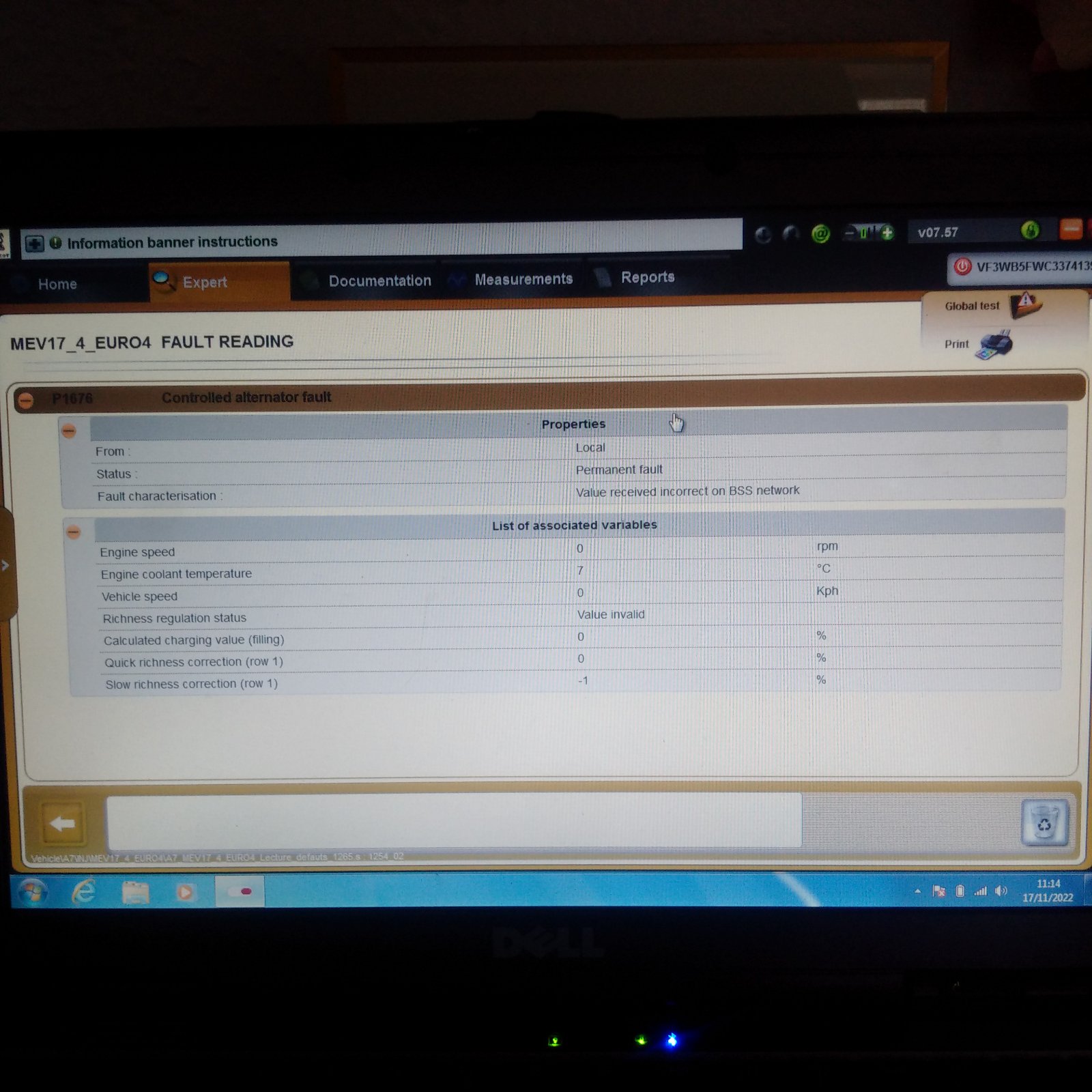

No, no difference what so ever. Cannot work it out. Alternator charging OK. The thing that annoying is there must be something that happens to bring the fault code up. A,so. I cannot get the fault to clear. It comes under the heading ignition /injection. The car is running perfectly. Please see diagbox screen shot. Also when I try to clear the fault I'm told the the historic faults memory is full and to delete it. Anyone know how?
Also see this article from botch. No where does it mention alternator.
