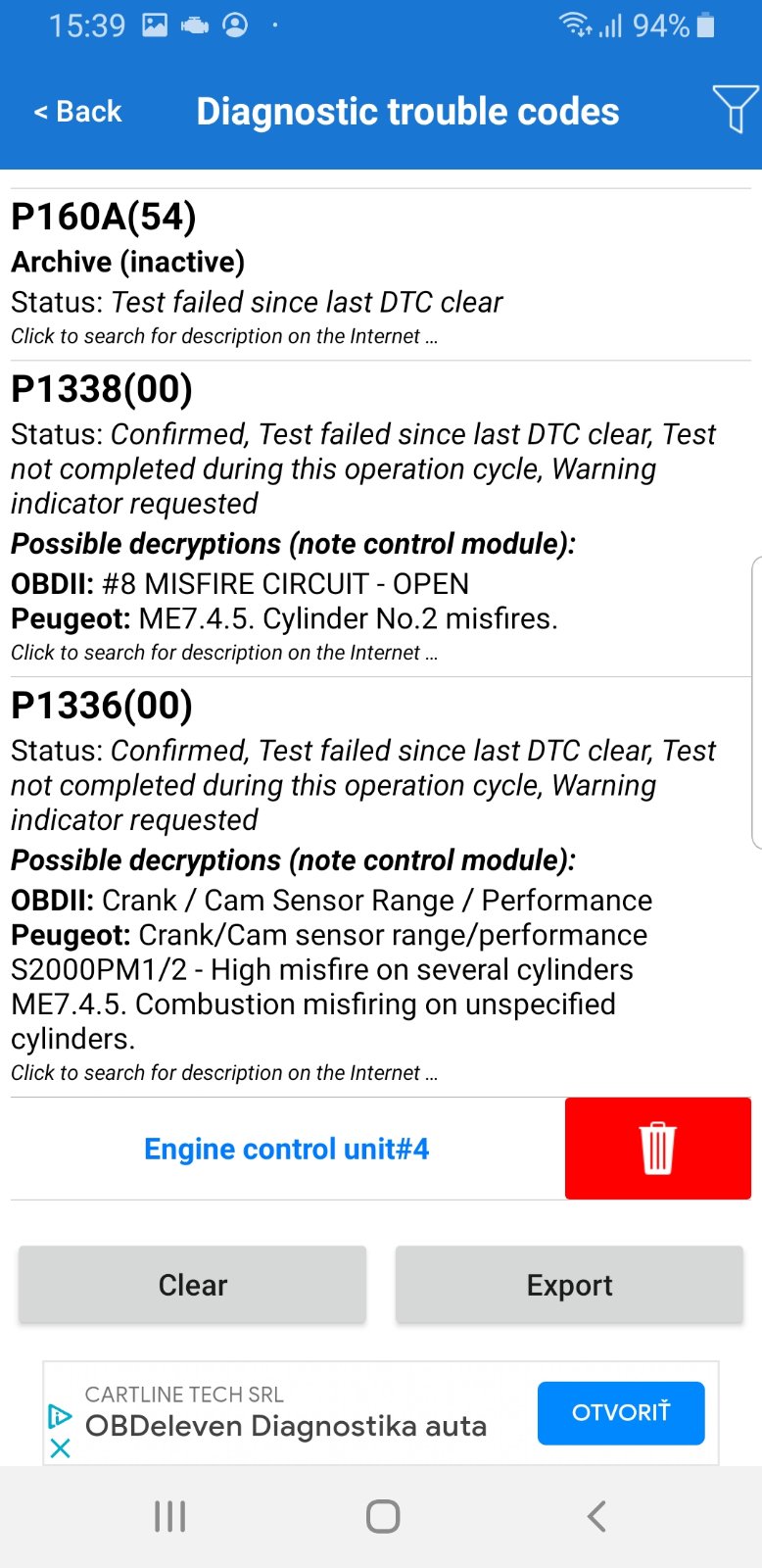

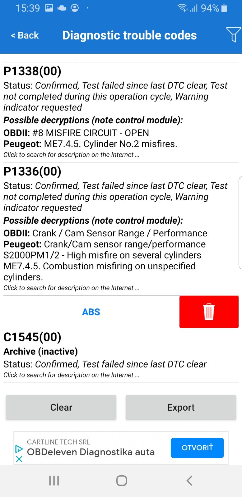

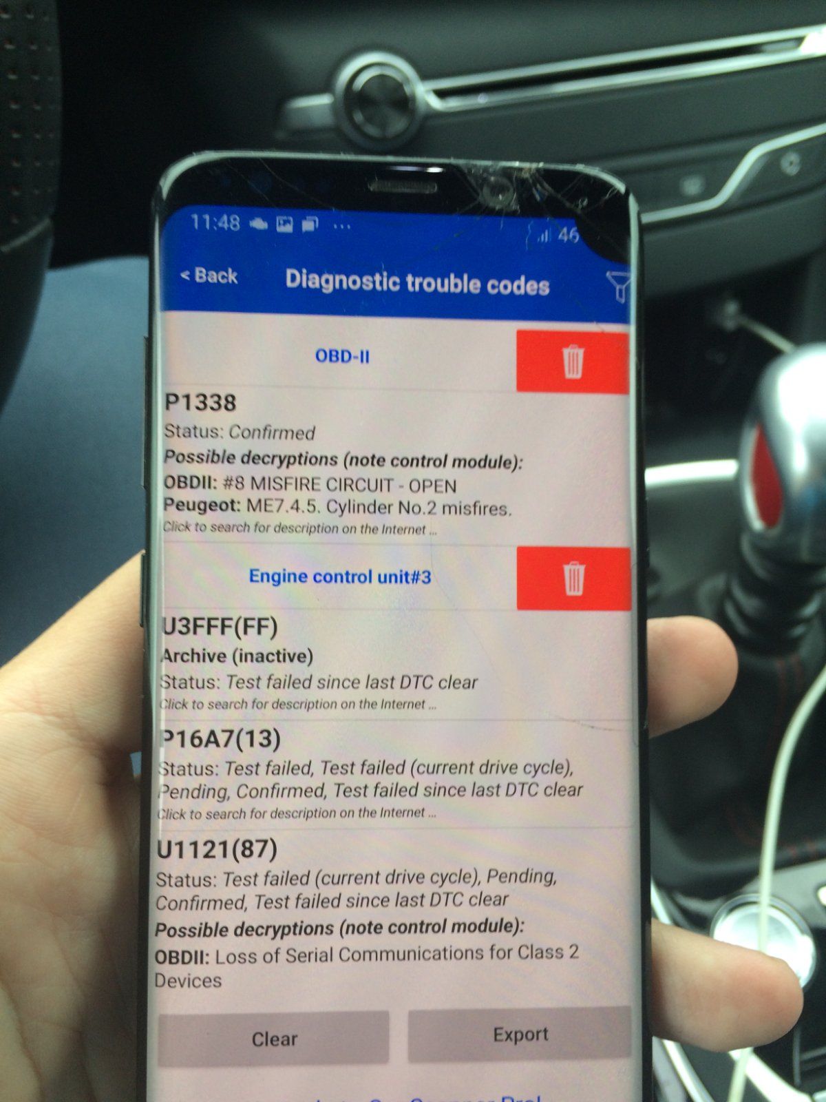

Hi guys,
  • I am experiencing really strange problem for longer period of time with my Peugeot 308 GTi T9 Pre Facelift model. It's (Orange Submarine - MIL - Check Engine Light => Engine fault, check or repair engine.
    I really tried everything what was suggested like, new coil pack, new spark plugs, I checked PCV ventilation that works.
    Then I decided to do last step which was change of injectors on cylinder 2 a 3 that should reflect code P1338.
I am giving you an example of codes read before dismantling and after repair but it changed completely nothing.
Before repair
After repair
