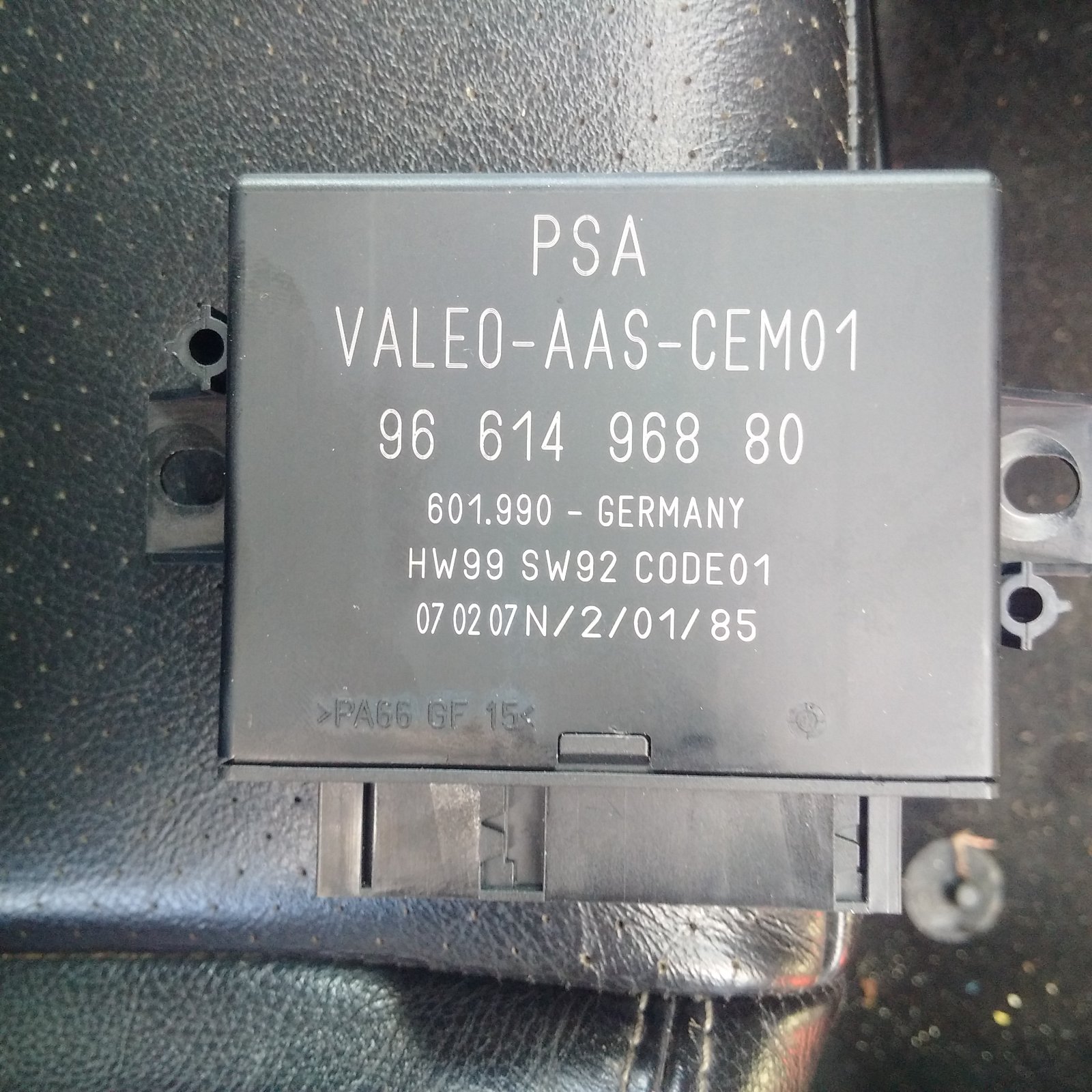

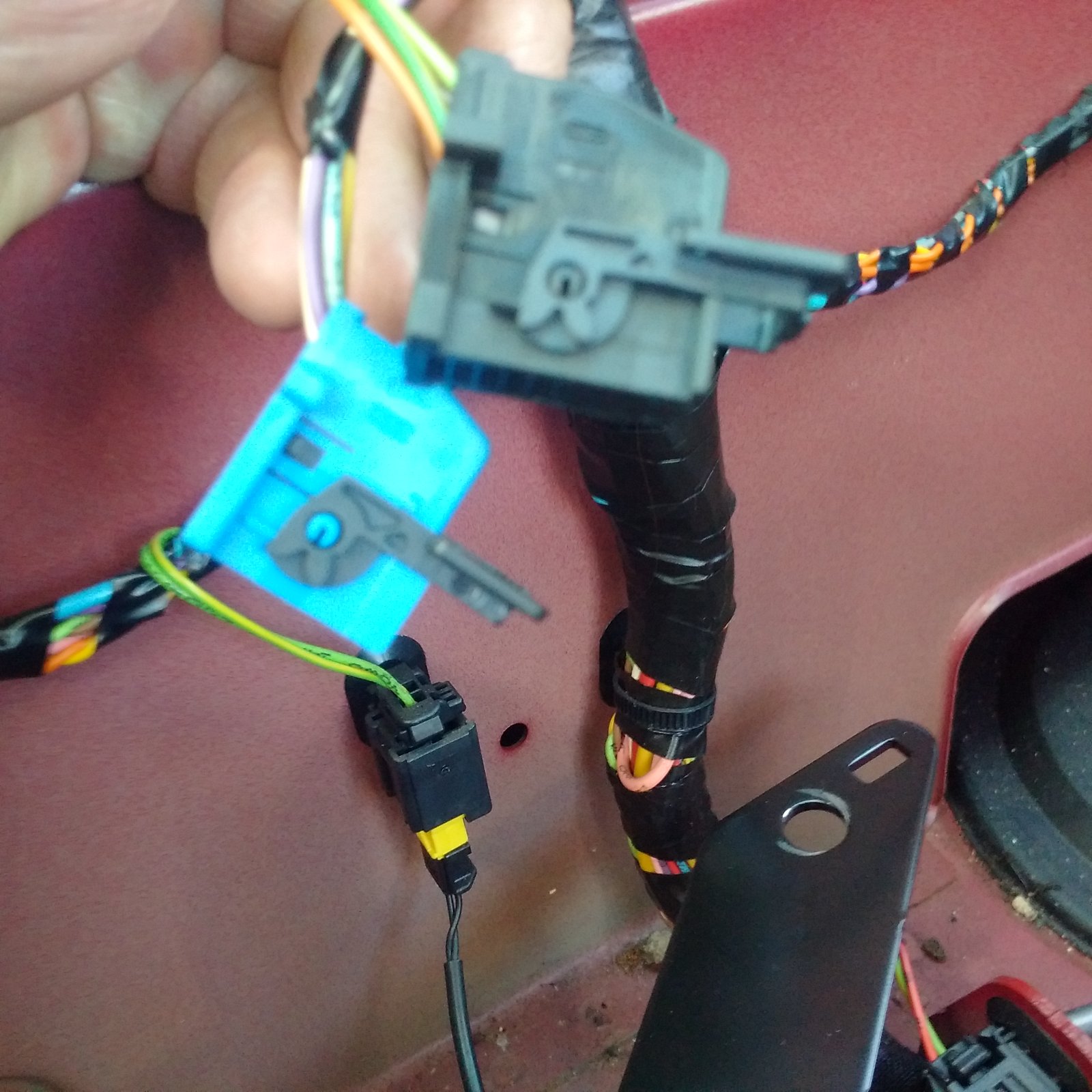

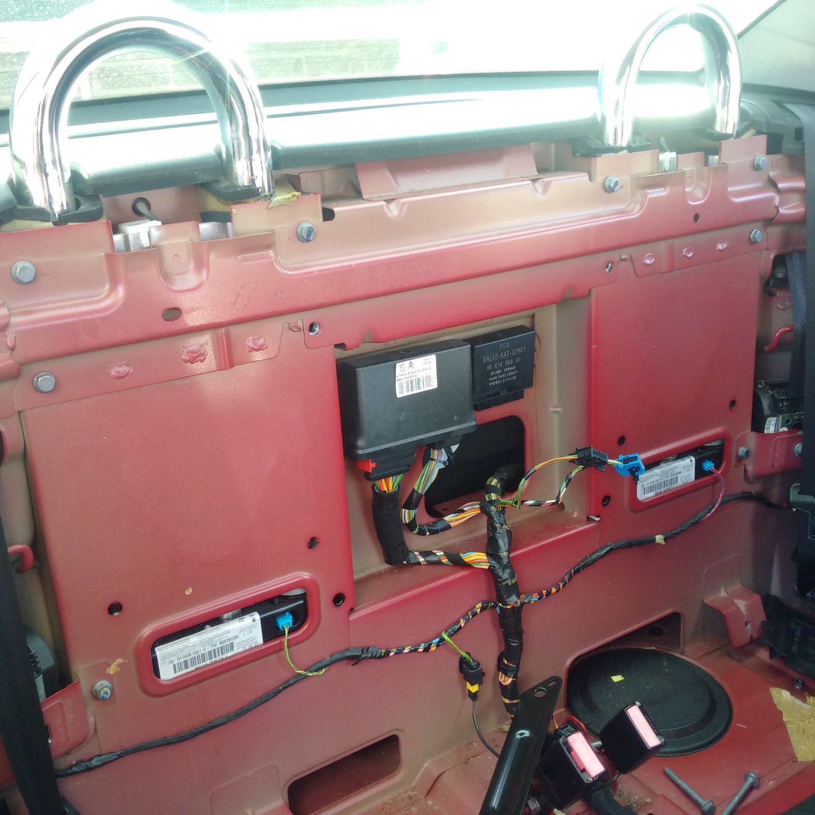

Re: 2007 207 cc reversing censor module
Unread post by bnd »
