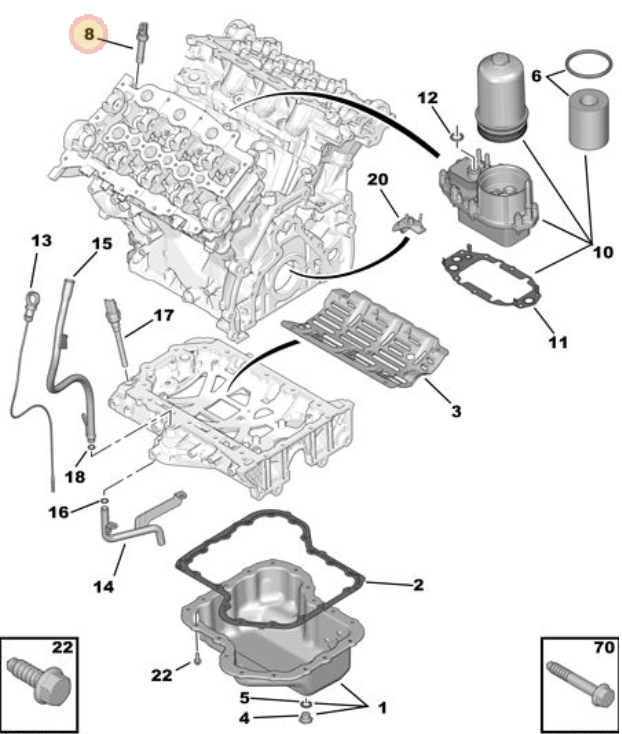

Oh another day & another issue.......... had the low oil pressure warning pop up Monday after fixing the alternator & had a look & the pressure switch was leaking a lot & looked like for a while Diagbox showed the sensor had a fault. Ordered a new one from Parts in Motion & fitted it today, cleared the fault. Guess what with the new sensor fitted it's still showing the warning & fault. How many sensors are there for the oil pressure side of the system ???

Just the one, item (8), part 1131H8, (DIAM 13,7X21 LG 89 GREEN), £55.28 for an OEM one.
I can only suggest the replacement part may be duff.
