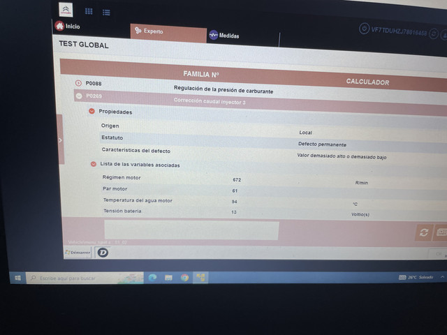

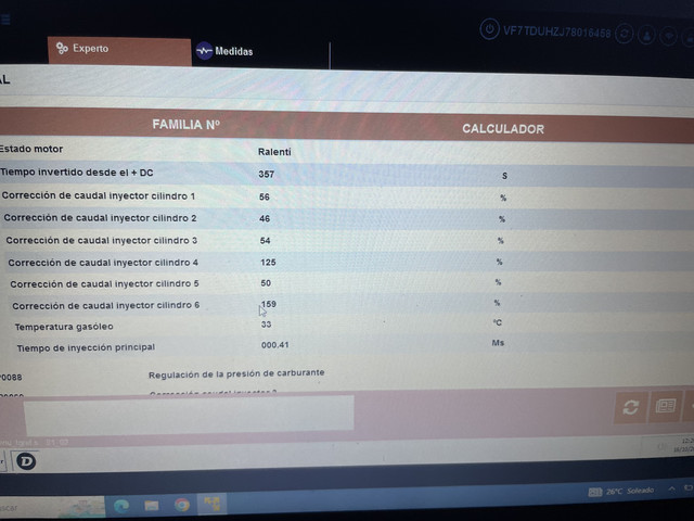

I need some help with the Citroen C6 2.7 HDI 2008.
A few days ago it started to shake as if a cylinder had failed, I kept it in the garage and the next day completely cold, start, accelerate cold and it turned off immediately. I have emptied the fuel tank and I have put new diesel of good quality at the same time as a Xenum injector cleaner, then the car has started well (if you accelerate cold it turns off immediately) if you let the car warm up everything works fine.

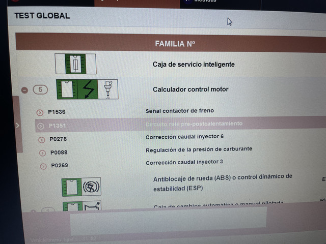

I have passed Diagbox and I have seen the following error codes:
I have seen this video that exactly the same problem occurs (when accelerating from cold it turns off immediately) although it says that when hot everything works fine like it did for me and it says that it is a bad mass under the air filter:
The problem is that when cold it is also noticeable how the injection fails a little, I don't know if it is related to the same mass or they are different problems, a particle filter error message has also come out now, all at the same time... A little weird.
Any ideas? Thanks in advance.

There's not a lot of info on the fault codes for this engine unfortunately, but one thing I have found a technical bulletin concerning, stalling and lack of power with the anti pollution warning light on. It generally concerned the C6 2.7 at the 30,000 KM service and the fuel filter. Apparently, the fuel filter, filter-element is clogged following the creation of particles linked to the use of certain fuels and the particulate filter additive additive. The recommendation is to replace the fuel filter which should be done every 30k KMs.
The P1536 fault is of course linked to the brake pedal switch and if this is becoming problematic, a replacement may solve it. As this is linked to operations of the auto gearbox operating, it might be worth sorting that out too.
P0088: Fuel pressure regulation fault : Pressure too low. This may also tie in with low fuel pressure if the fuel filter is blocked.
P0267: Injector 3 flow correction fault: Value too high or too low.
P0278: Injector 6 flow correction fault: Value too high or too low.
I would certainly get the fuel filter replaced and then prime the fuel system after replacement if you have not already done this.
