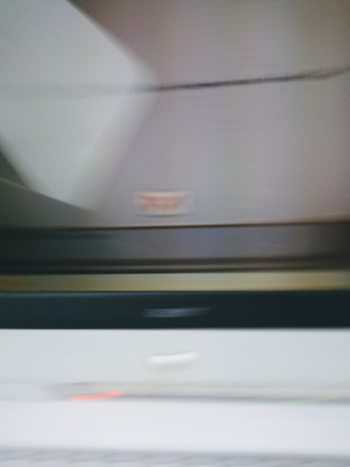

Hi. I bought the diagnostics recommended from easy diagnostics but only getting to use it now, fitted new rear pads and set of cables today, and being nosey I've ran into a problem, being an idiot I have went into service and the programme is asking for an interval and I don't know how to get out of this
The attachment IMG_20221015_175120284.jpg is no longer available
please help I'm lost, apologies

The image you posted is smeared and unreadable.
