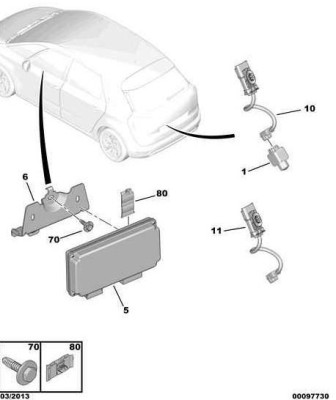

The Parking assistance ECU for the sensors is located in the rear left hand side area, likely inside the rear storage compartment or under the boot area.

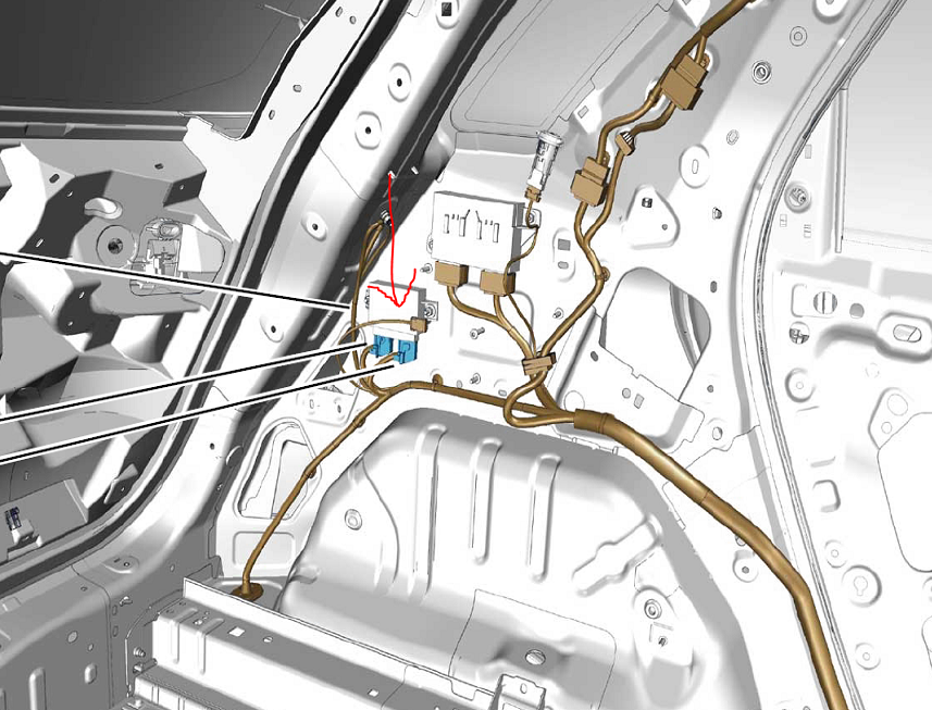

Ok, so confirmed you have what I put up in the picture on a previous post. ECU located here:

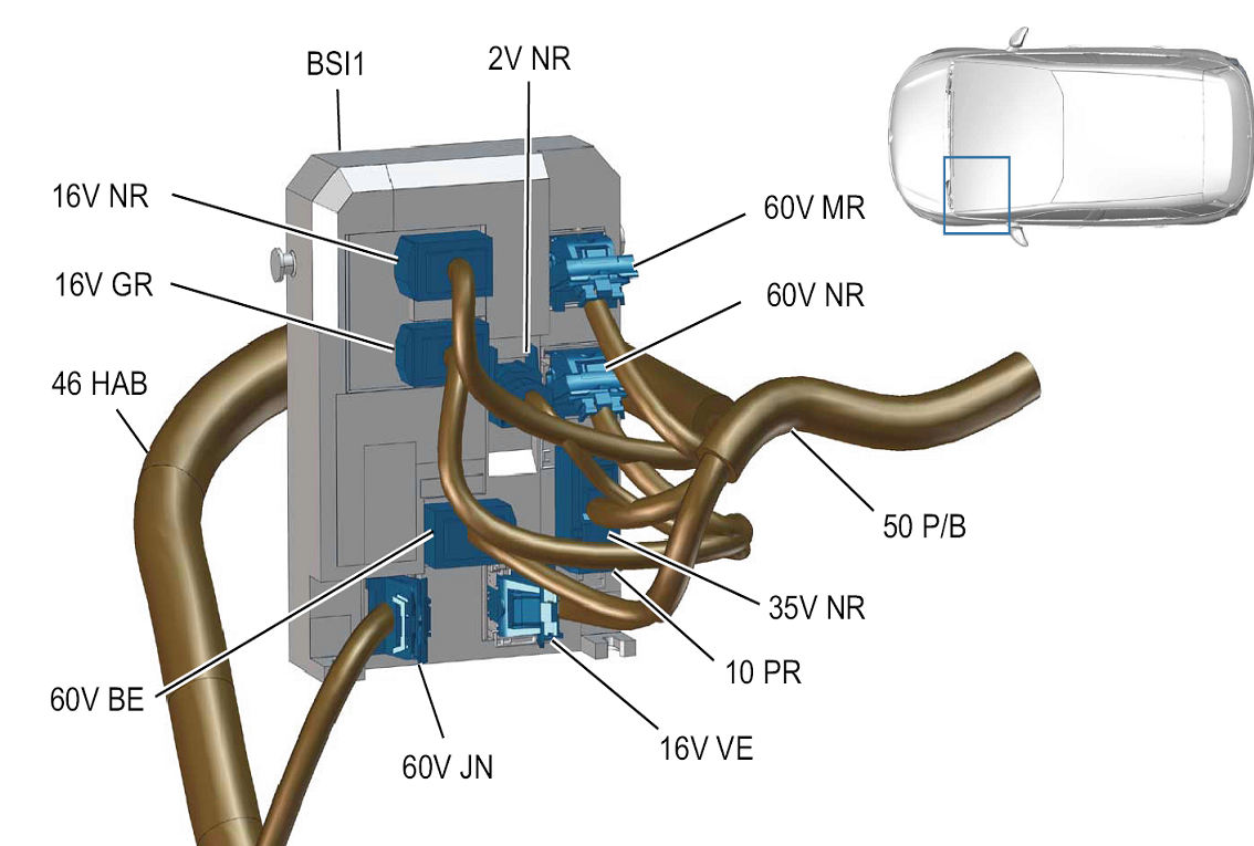

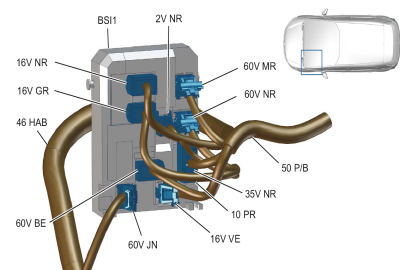

1) Fuse F22 in the BSI, which is a 5 Amp fuse for the parking assistance ECU. Don't visually check this, as they can have invisible breaks, so it needs testing with an ohmmeter. BSI Located below:

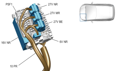

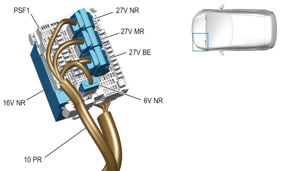

2) If that is OK and working, next check the Engine Fuse Box. Fuse F12 is another 5A fuse for the Parking Assistance ECU with city park / Reversible Seat Belt Reels. PSF1 Engine Fuse Box Location:

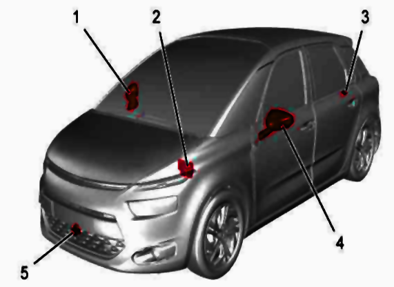

As for the ECU location, it is buried in the passenger side (RHD vehicle) glovebox, somewhere near the BSI, so be very careful there as the BSI is the main brain of the vehicle, so you don't want to be disturbing anything there if possible.
Shown at (2)
Replacing the parts alone is not always sufficient (the same for front facing camera when a windshield is replaced - must be recalibrated by a place with suitable ADAS equipment and professional diagnostic kit.
Shown at (2)
