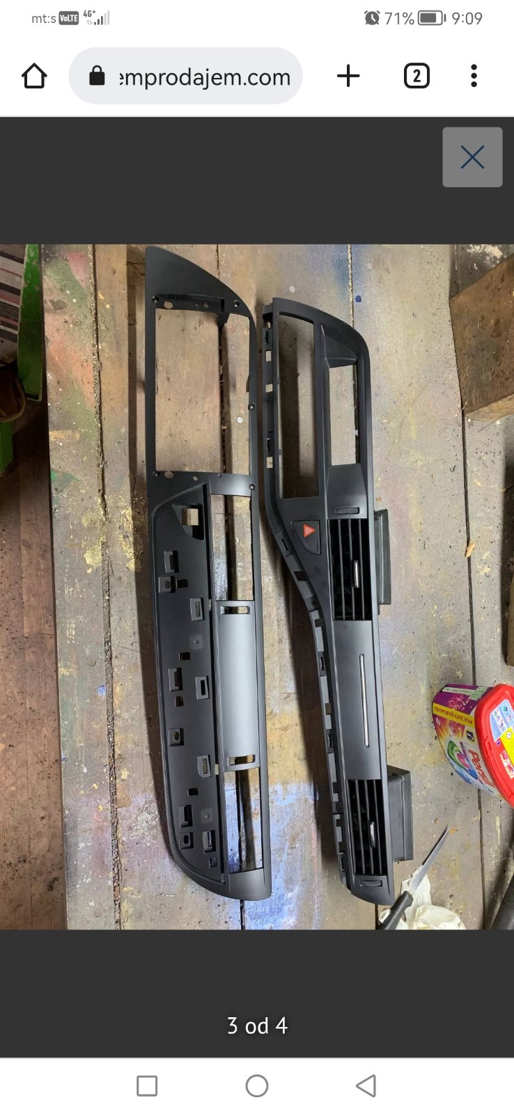

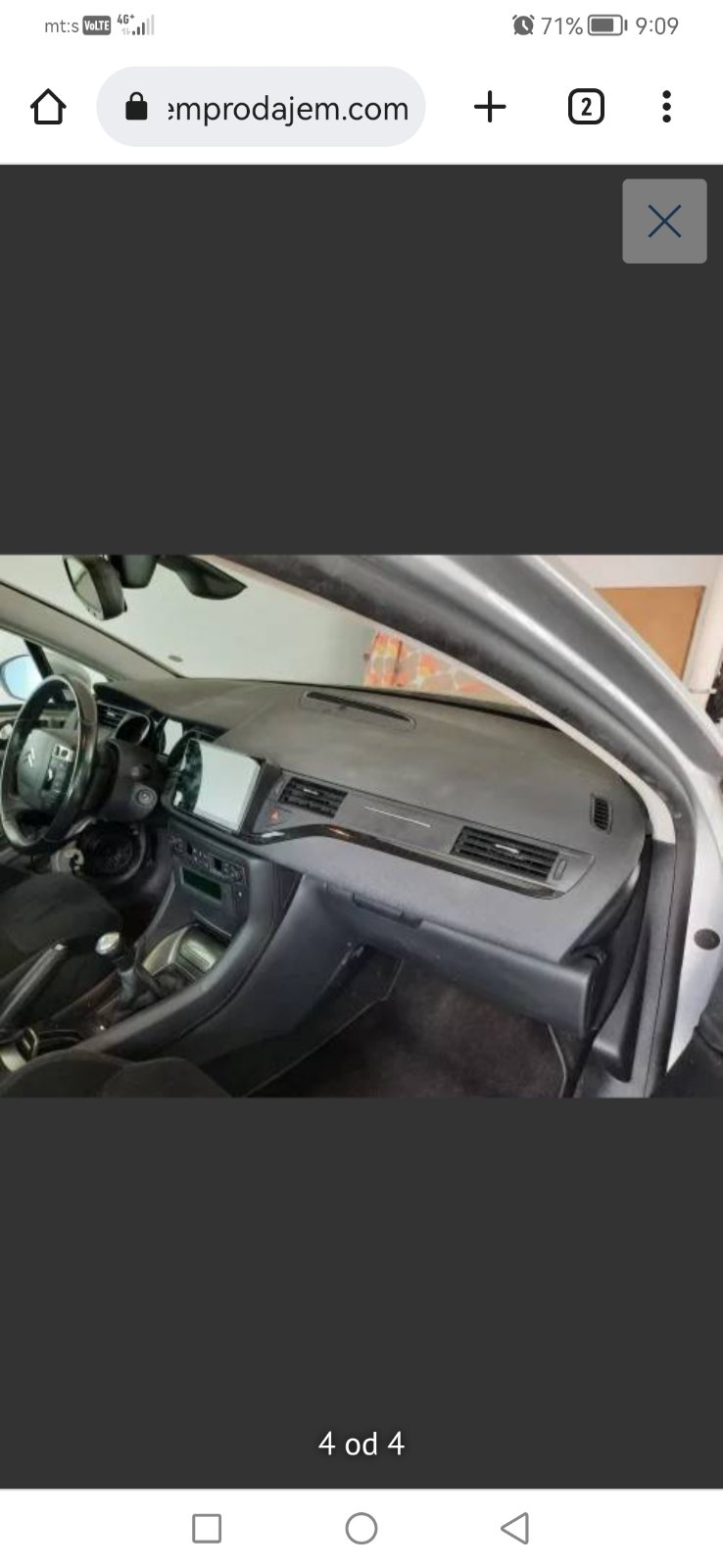

I would have prefered something that fits more like original,but i guess android one will do.Found this android 10 unit which goes with trim included and fits nice.
Around 300e in my place.Seller said it comunicates with CAN bus so apparently you dont lose any functions like stearing wheel volume control,reverse camera,radio functions etc.Btw does anyone know longevity of these android units?

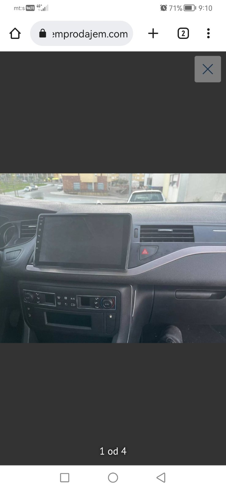

I bought one of these 10 inch android.
I removed the radio and put the small display Instead.
Can control everything but i have a problem with service km.
I think rz 15 is interfering with km.
I reset the service and few minutes later is on 0 again.
Even if i reset and press the check button, I can clearly see the km decreasing.
I have disconected the radio from the main power anda nothing happened.
2 things can happen. Or the canbus box is deffective or something missconfigured.
Anyone can give me a clue?
