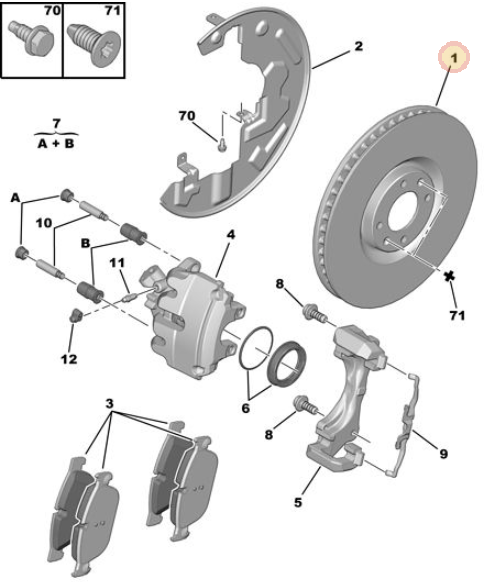

Can someone confirm what is the size of brake discs for Ds5 Hybrid front?
I need to order some from autodoc and have two options: 302mm and 340mm. I am thinking they should be 340mm

Re: DS5 2012 Hybrid brake disc size
Ok 2 things:
1) Your DS5 has an outstanding after sales campaign overdue! I suggest you contact your nearest Citroen dealer and tell them you've been advised of this. They will explain what the work involves, but will be free of charge.
2) As for the discs:
Original Part number: 4249F6, £126.60 each.
Cheaper Alternative, part: 1618864780, £74.48 each.
In both cases yours have a diameter of 340.
